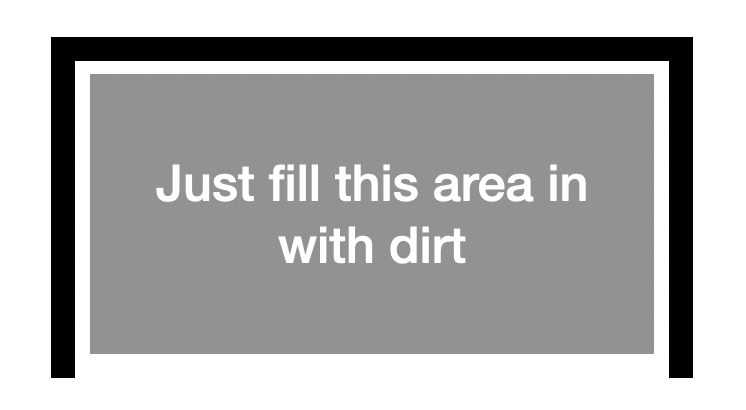

Can anyone post pictures of shooting back stops you have built?
Downsizing house and land, and where we are moving to only has a little less than 4 acres. Closest homes are about 100 yards on each side. I've got a good 100 yards from behind the new home to the edge of our property line behind the home. Large tobacco fields behind the property line. Home outside of town limits (town population 3k, moving up from the current town of 600).
Reason why I ask is we are also have walk out from the unfinished basement dug out and enlarged from whats currently there, and I'm actually going to have a crapload of dirt to get rid of.
I was thinking of perhaps building a 3 sided retaining wall using lumber and fill in with dirt. Figure make the wall at least 8' tall on the backside (see below)
Just trying trying to keep it simple and not overthink it.
I'm figuring if using cans, even with supersonic loads, shouldn't really disturb anyone on the road.

I feel your simple design is great. Simple, effective and in a designated area.
I was thinking of perhaps building a 3 sided retaining wall using lumber and fill in with dirt. Figure make the wall at least 8' tall on the backside (see below)View attachment 4126159
Where I'm at now for the last 20 years, I just drive out back and actually have a great hill for a backstop with no one around.
I have a pit that is basically what you are you thinking. The sides angle out a little bit, that's really the only difference. Has a metal roof at a slight angle. Came with the house when I bought it. I'll get some pics this weekend and post them.

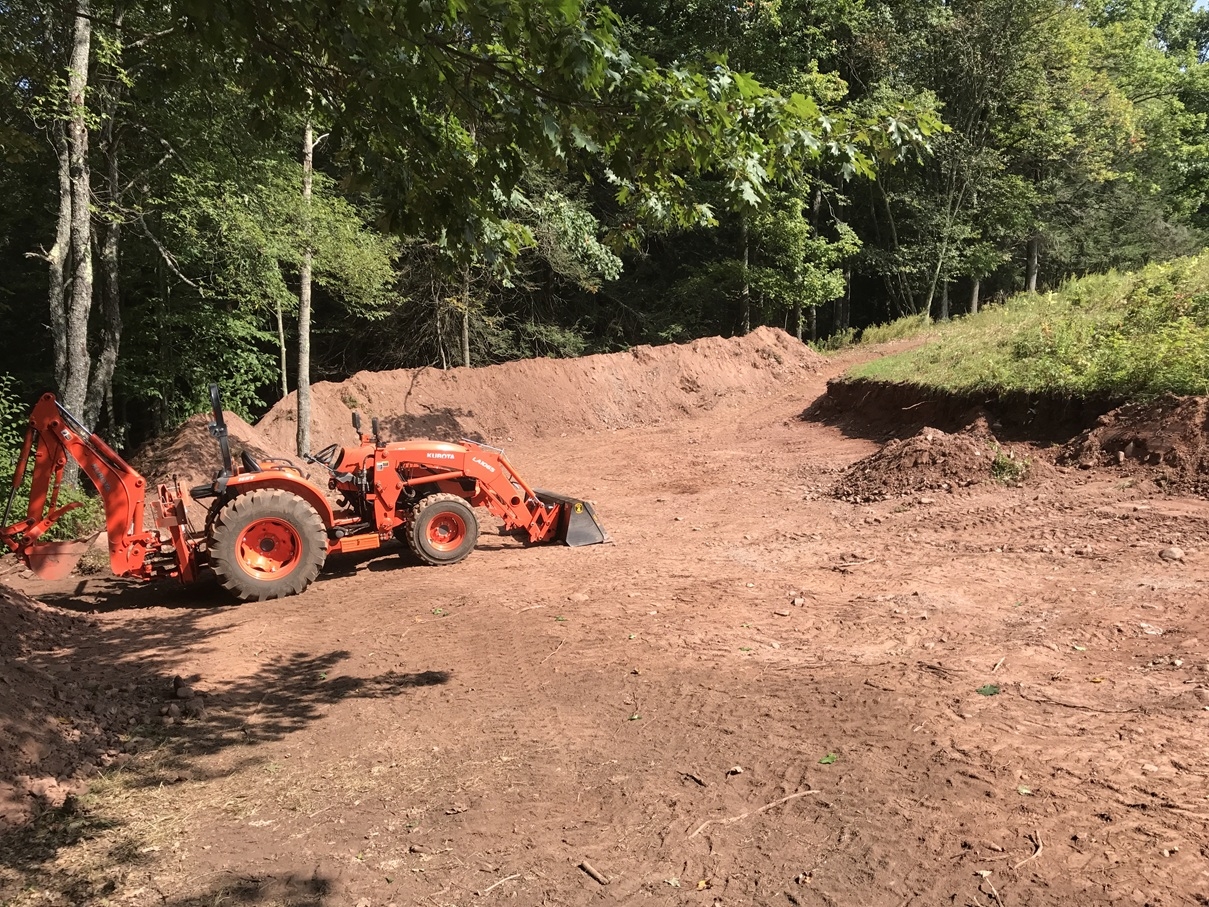

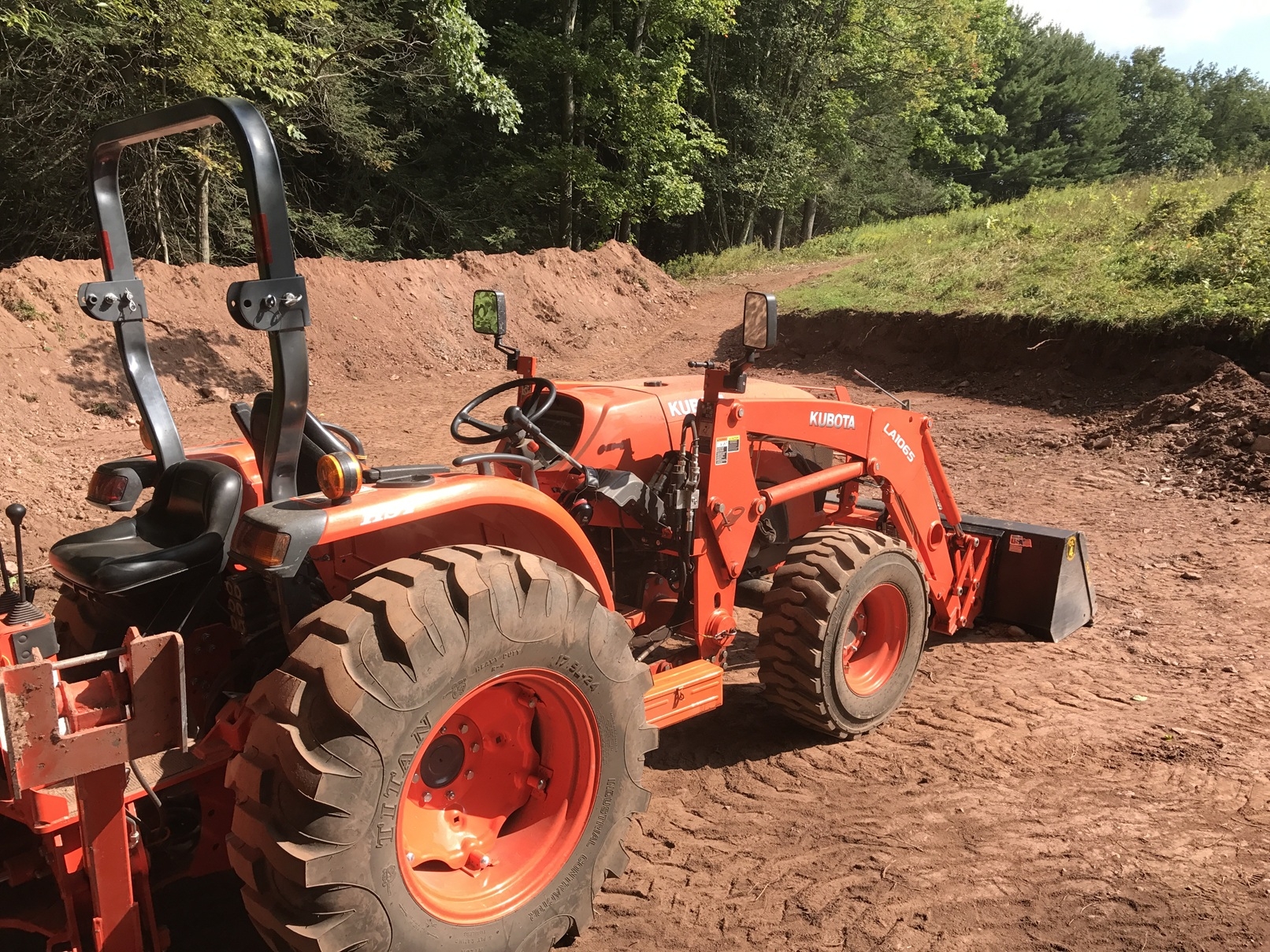

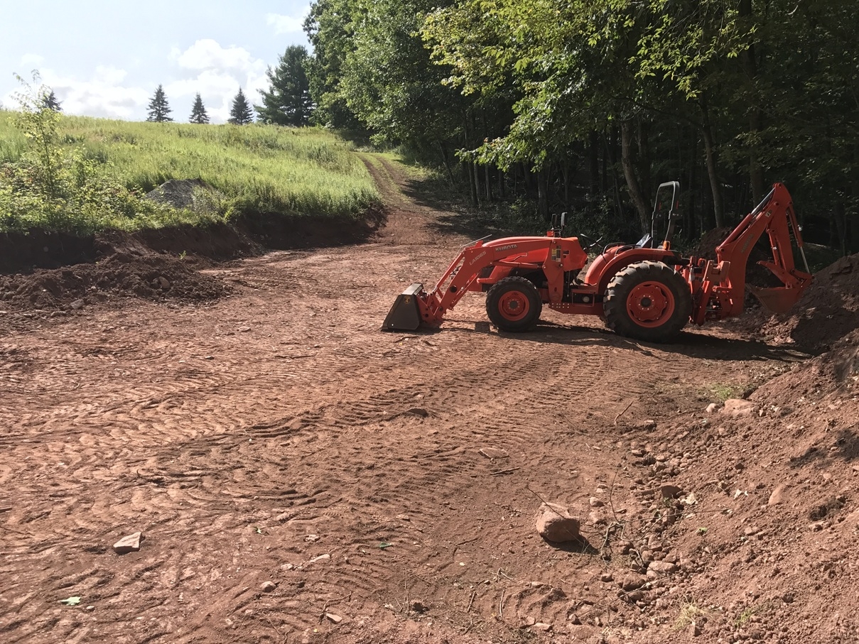

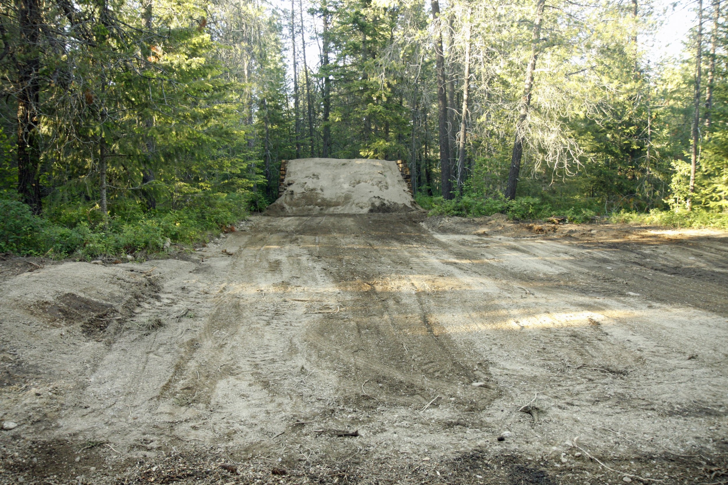

I had an unused section of one of my fields that I converted into a shooting range. The area was too steep to be useable for much else and there is a quarter mile of woods behind it. It's also on the other side of the ridge, so the noise can barely be heard from the house.
I cut a line of trees on the edge of the field and laid the trunks & slash on top of the stumps. I then cut back the bank to level the area and piled the spoils on top of the tree trunks:
The finished bank is about 8" tall and the woods behind it take care of any strays. Took about a week working afternoons & evenings. Also a great way to break in the new tractor. :)
