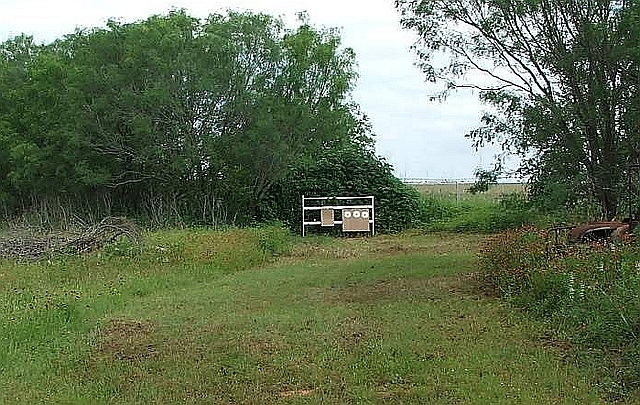

I thought I had better pictures but this is it. I use this mostly for close range handguns but I have used it for sighting in my rifles too. The round things are 8" paper plates. The backstop is logs and dirt. There's over one mile clear range behind it.

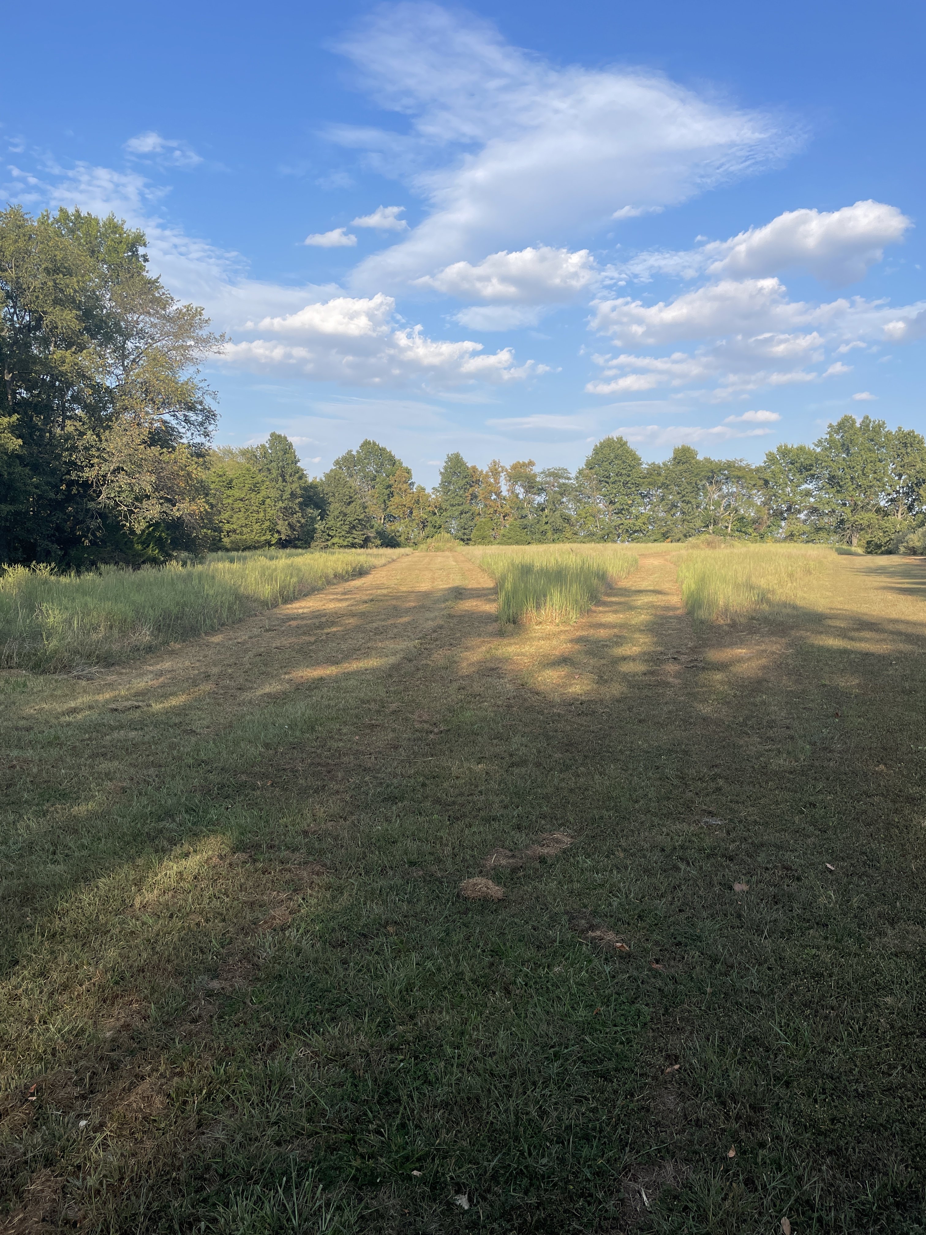

Approx 200yd rifle range.
Berm is 12’ wide x 8’ tall x 5’ thick.
I keep my plates on stands knee high.
Most shooting is done prone.
Our pistol range is against a pond bank that has a 8’ rise on the backside. Can’t find any pics of it!
The berm is way in the back by the tree line
