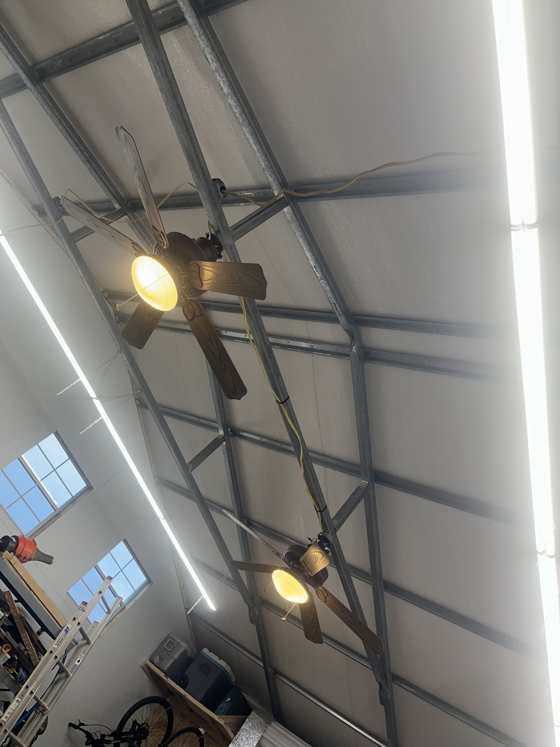

I have a garage/shop that’s 20’x30 with 10’ walls, kinda like vaulted ceilings with one layer of bubble insulation (sides & walls) it’s in SC therefore it’s hot and humid which makes it uncomfortable inside the building.
I may add a second layer of the bubble insulation to the ceiling as I have almost enough leftover.
I am thinking about a mini split HVAC system, but when I run the size calculations it comes up with 24k units.
I don’t want it to run day in and out and maintain 70 degree, but I would like it to make it more comfortable to work inside for while I’m in it.
What is the minimum size HVAC mini split that I can get by with?

Need more info on what you have for insulation in walls and ceiling. If you don't have much insulation... it is going to run day in day out. Most bubble wrap is a joke as far as insulation is concerned.
/ Shop AC Sizing
I agree, but it keeps condensation from happening and raining it down inside. It is at the most like R 4 to 6 range in both the walls and ceiling.
Like I said I plan to do a second layer of the bubble insulation in the ceiling spaced down say 1.5” below the first ceiling layer.

Picture of ceiling currently.
It has five windows (single pane) four in west wall and one under the lean-to.

"The R-value of bubble insulation can vary depending on the type and thickness of the insulation. Here are some general guidelines:
  • Single bubble insulation: The R-value of single bubble insulation is typically around 1.0 to 1.1, which is relatively low. This is because the bubbles are not as effective at trapping air as double bubble insulation.
  • Double bubble insulation: The R-value of double bubble insulation is typically around 3.5 to 4.0, which is higher than single bubble insulation. This is because the double bubble design traps more air and provides better insulation."
I looked up the R-Value of bubble insulation to see what you are dealing with. As a Contractor, my opinion is that you will be wasting your money on trying to cool this building unless you get your R-Value up to a level that makes sense. In my opining, you might see some results with R7 or R8 on the walls, and R20 in the ceiling. This is way below Code, but just a minimum for a shed or shop to actually notice it.
An empty building without AC, but insulated to R13 in the walls, and R40 in the ceiling wont even need AC in my part of East Texas. The difference between outside temps and inside the insulated building is significant. I'm personally insulating my garage to R60 in the ceiling. I've done this for clients and been really impressed by the results.
Since you don't have a ceiling, or an easy way to install insulation, Closed Cell Foam is probably your best solution to get a decent R-Value inside your building. Never use Open Cell Foam directly against the metal of a building. It holds moisture, and over time, it will cause rust. Closed Cell has about an R7 value for every inch, but after 2 inches, the R-Value per inch decreases. Four inches would be the max you can use and be able to see results, but for most people, 2 inches is the limit, with just one inch being good enough. Closed Cell Foam also acts as a vapor/wind barrier, which makes the R-Value deceiving. Even though it's rated R7 per inch, the results will feel like double that.

In my 40x60x14 foot open ceiling shop I have a 36k btu Mr Cool unit installed. With R19 in the ceiling and R21 in the walls it can generally keep the shop at a fairly comfortable 72-76F when outside air temperature is in the 90’s. Prior to ceiling insulation it was almost impossible to keep the temperature above 60F in the winter or below 80F in the summer.
/ Shop AC Sizing #20
Insulation above the conditioned structure is just as important, if not more important than insulation on the side of the unconditioned structure in determining heating and cooling loads.
Doing it right, you also have your indoor desired temps vs outdoor temps to help determine exactly what size system you need.
Long story short, the biggest impact on your load is how well the structure is insulated. ALWAYS spend money on good insulation to help reduce the load.
