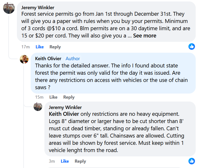

I'm currently planning on wood heat. I have a fair amount of dead wood here every year, and think I can probably get a permit from the forest service to get wood out of clear cuts and slash piles.

My property is off grid, so the only electric I will have is solar PV and I have a diesel generator which I will be recovering heat off the coolant and exhaust to get the most $ per gal of fuel consumed. So having an insulated storage vessel for the hot water will help with the radiant heat. I have not yet decided on the primary heat source yet. I dont think I am going to do an outdoor boiler. Despite the amount of National forest and BLM land I still dont know how it works getting beetle kill wood off the slopes. I know they have a lot of rules banning motorized vehicles and power tools like gas powered chain saws, so I am going to have to see how firewood is brought off the mountain before I make any commitment to heating with wood. Its mostly softwood too, so thats another hurdle. Lots of volatile resin and very little in coals.

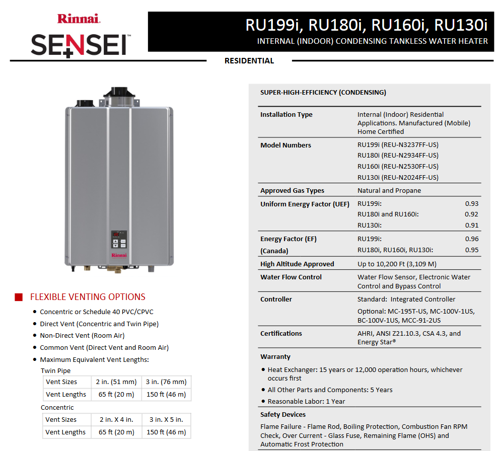

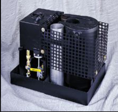

During construction I have 2 different passive vaporizing diesel heaters from the military, they dont need any power source or electricity. Fuel is gravity fed via an elevated jerry can. The small one is 9-12k btu. The larger unit will produce 20-60k btu with the same operating principle. Both are modern with an efficiency of about 72%. Obviously some sort of water heater would be the primary heat source. For now I am leaning towards a Rinnai Tankless water heater, the RU 130i which is a high efficiency tankless heater with a built in circulation pump. It only draws 38W when running and 1.3W in standby. It is also rated for altitude to over 10kft so my 9000ft is covered. The shop will have 2x6 walls with rockwool insulation and R60 over the attic and only 1 large door which will have 3" of foam insulation and the means to be latched against its jam reducing air leakage. I will be making the door myself and its balance system. The biggest electrical consumer will be the radiant system circulation pumps and I will get ones with DC motors so that they can run directly off battery power thus avoiding inverter losses. Once operational the radiant heat system will probably have its own dedicated 48V lithium battery system and solar panels and charge controller because the heating system is probably going to run most of the year. The generator will be on an auto start system should any of the batteries reach a predetermined voltage point.
Hunter arctic heater 9-12k btu
95-96% efficient tankless hot water heater.
