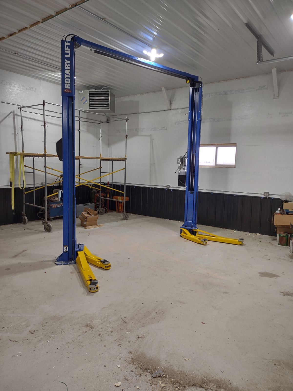

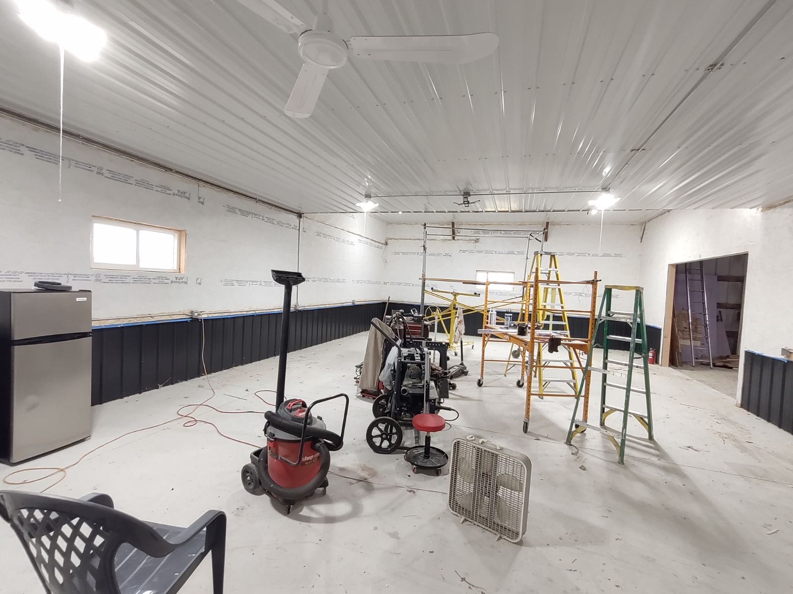

Since you're in the planning stage, here's a couple inside pics for ideas:

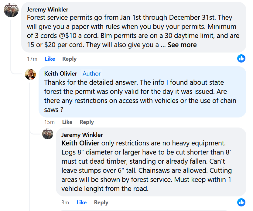

I got some clarification on a local facebook bulletin board.
I wonder if these regulations vary by region. It's been a few years, but back when I'd get a permit to take wood from NFS land, you were only allowed to take what was dead and down...no dead standing trees. No motor vehicles were permitted either.
Typically, I'd hit sites that had been logged the previous winter. Usually plenty of slash big enough to make it worthwhile. Had to huff it out myself, I suppose if I had a draft animal I could've used that but I didn't so I didn't.
These regulations were enforced. I got "carded" at least once a season. Was always in compliance, but the rangers implied that I was in the minority.
