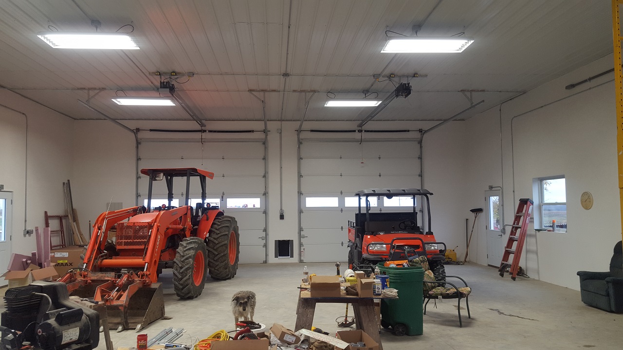

/ Shop build questions #4
This is the best pic I've got in regards to door spacing from the inside. Gives you an idea of how critical door spacing is from the exterior side walls as well as space between two. Keep in mind I hadn't moved all my stuff in yet when this was taken. And you are 3ft narrower than this.
