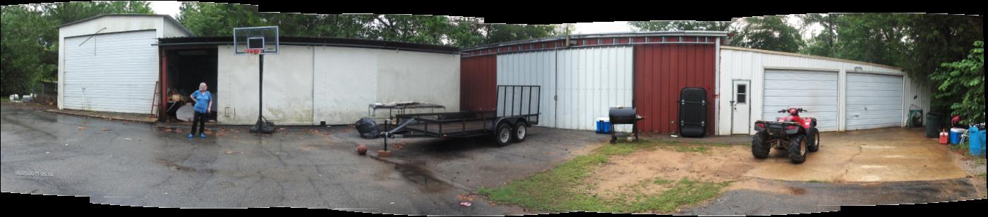

I know it's an old thread, but it's about the same title I would have chosen.
So
Background
My shops :
They include an apartment acroos the back of the big center shop.
They have wiring dating from the '80's augmented by wiring by untrained monkeys. I've found live circuits ending in a loop 8' off the floor just cut off. Extension cords spliced together w/ electrical tape with grounding plugs removed to wire to ceiling lights.
There is no "inspection" in this rural area. SWMBO had four 15 amp outlets put in the kitchen last spring (2013) by a licensed electrician recommended by relatives who are doctors and dentists. I wasn't there, I was busy monitoring the remodel below. NO GFCI - apparently he didn't even mention the need for 20 amp and GFCI. SWMBO's attitude is there's no inspection, it might have saved a few dollars.
I view that as I can build a car without brakes.
"The remodel below" was an expensive kitchen upgrade on a house I have which my son and family have since moved into. The contractor ripped out all the old wiring in the kitchen and ran new 20 AMP GFCI, I was there for the inspections.
Problem:
Need to gradually upgrade the shops and 2 kitchens here, plus 2 kitchens at other houses, about 20 separate circuits. Not to mention about a dozen bathrooms, laundry rooms etc.
