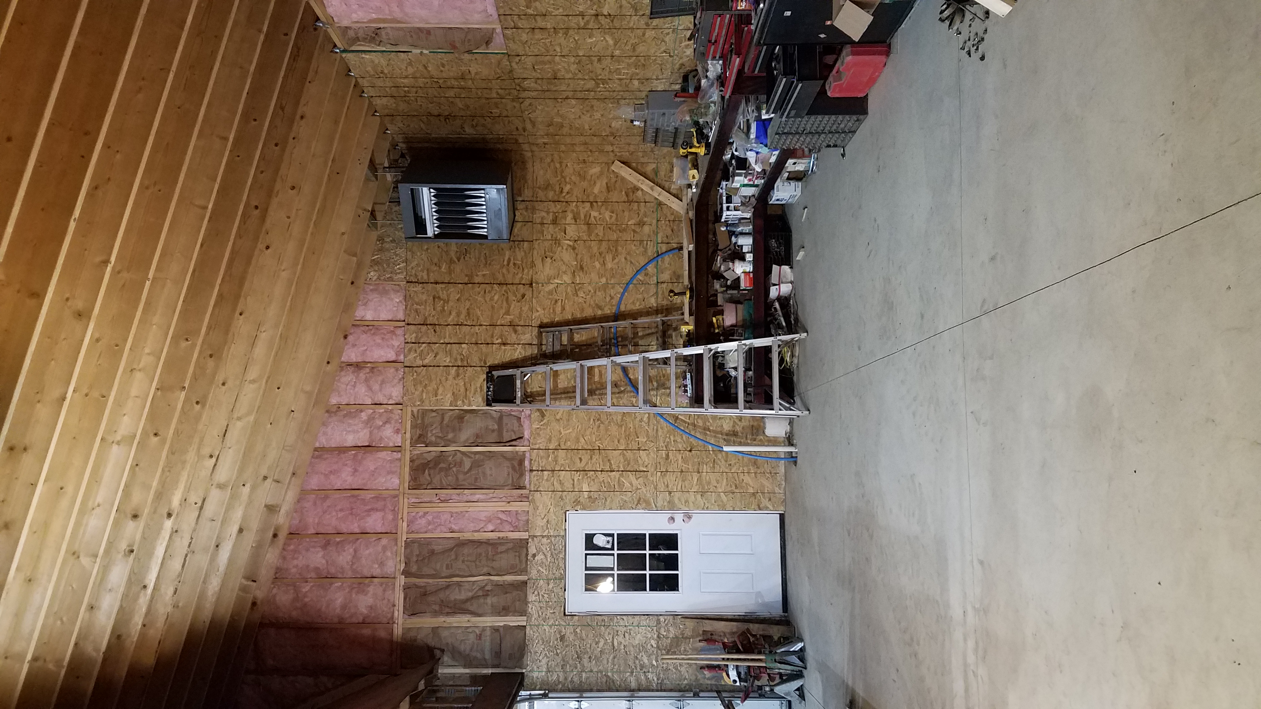

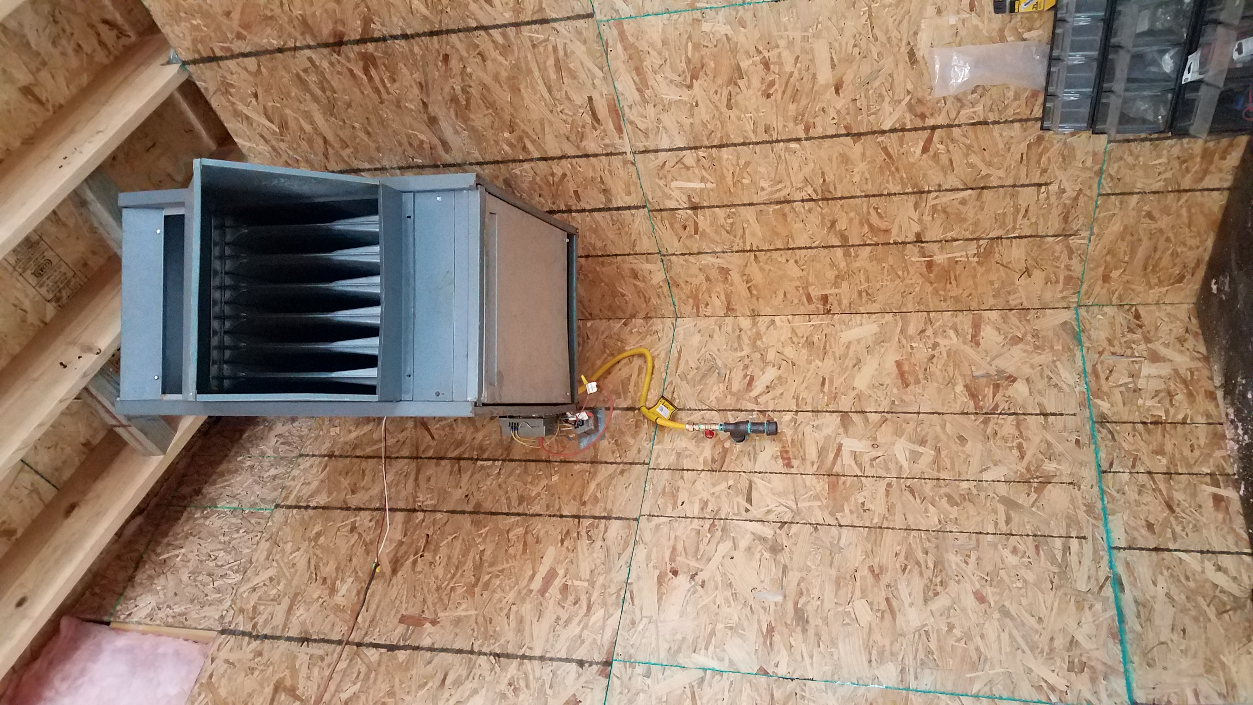

I finally have heat in my barn! Picked up a couple Trane unit heaters (hanging shop furnaces) a few years ago, but just finally got it hooked up a couple months ago. Mine is a 150k btu unit. My overall barn is 40x62, but the main section that gets heated is 40x46. Still finishing the insulation and interior walls, but having heart is a beautiful thing! Also ran water, cable, internet, etc...
