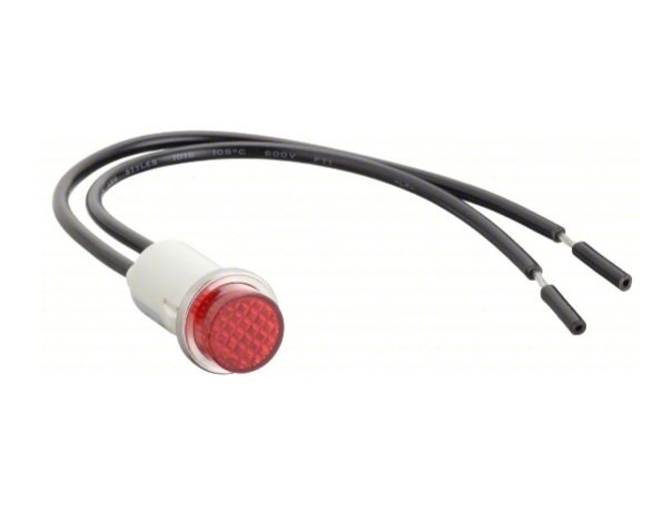

These 120v pilot lights are inexpensive if you shop around. They use NE2 neon bulb, last forever and use 1/4 Watt current. It mounts in a 1/2" hole drilled in light switch cover, etc. I wire it across the switch so when switch is off light turns on.
That way at night no fumbling for a light switch and I can easily see what's off since light is on. Probably a burglar would think it's part of alarm system.

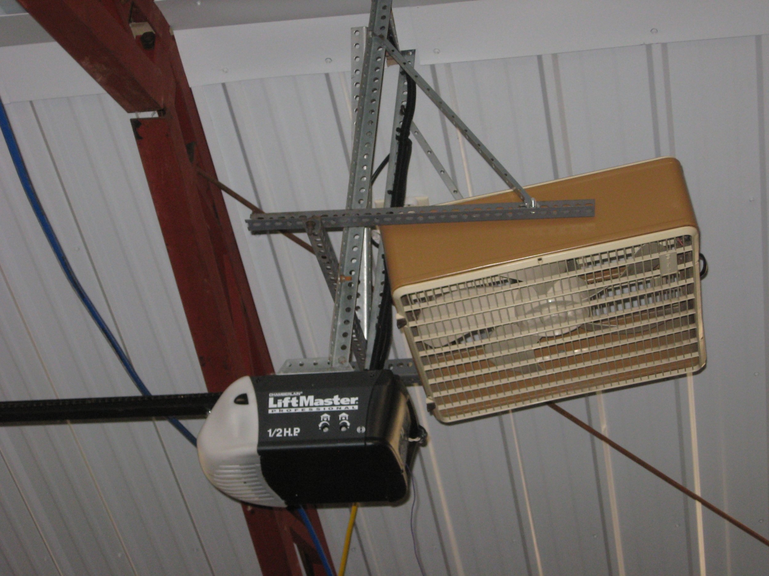

Redneck ceiling fan. Looks goofy, but works well, just a little noisy. Keeps the warm air down at floor level. Switched with a wireless remote.

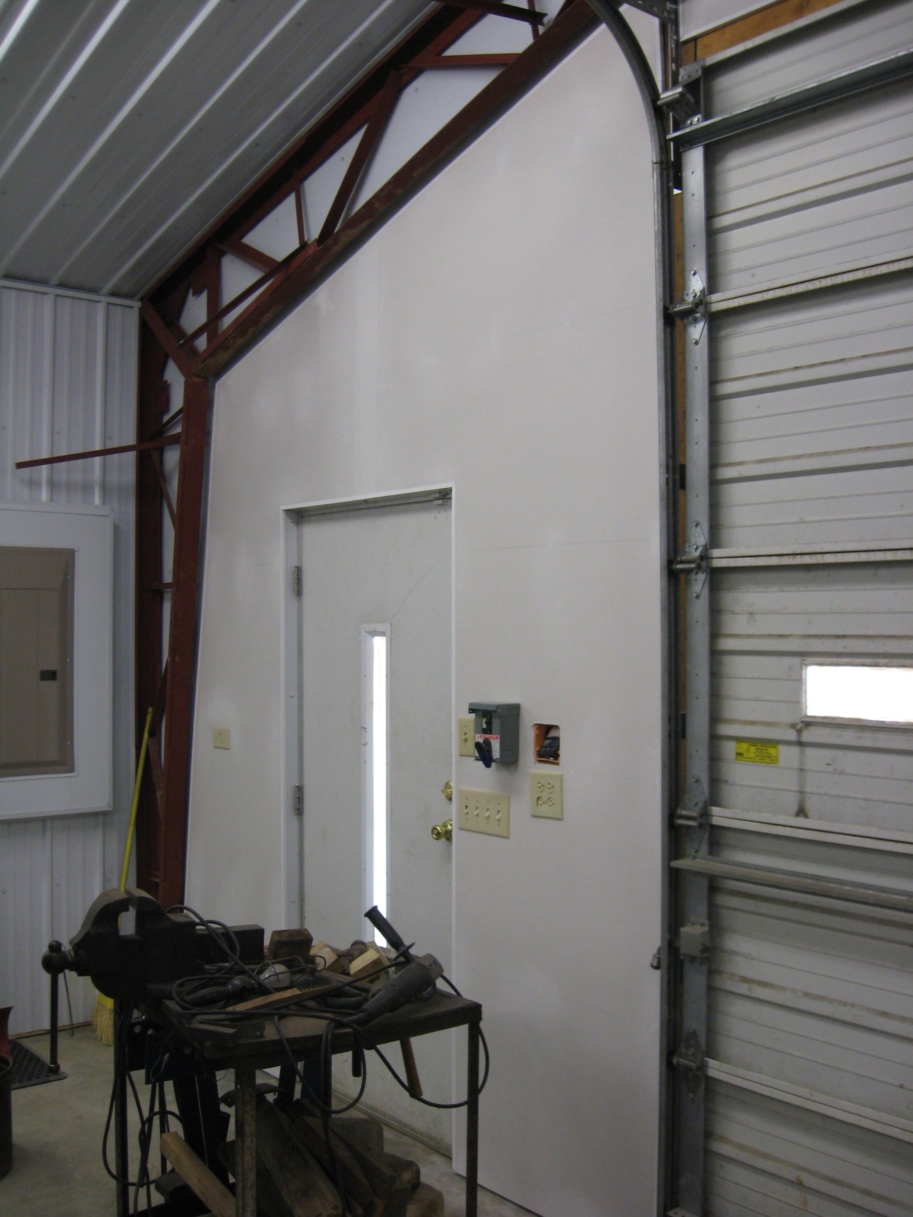

Also have the door opener on a wireless remote so as to disable it for security.
Disconnect switch for air compressor on the wall, right next to the light switches and door so I can easily remember to turn it off when leaving for the day.
