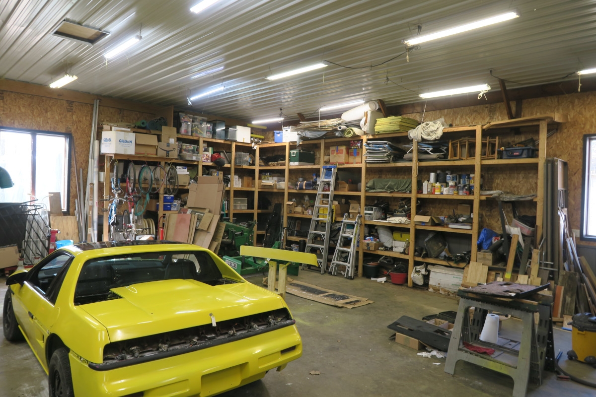

I've had it both ways, and trust me, you don't know what you're missing! Yeah, I lived in an un-painted OSB shop for 13 years, and I survived just fine. But my off-white painted OSB shop is infinitely nicer, with much better visibility, especially as my eyes age and require more light.
You are probably right, but at this point I've got so little exposed wall I'm not sure how much difference it makes. And I know the place is a mess, but every time I start to clean up I get distracted by things I WANT to do or NEED to do instead of things I SHOULD do. :)

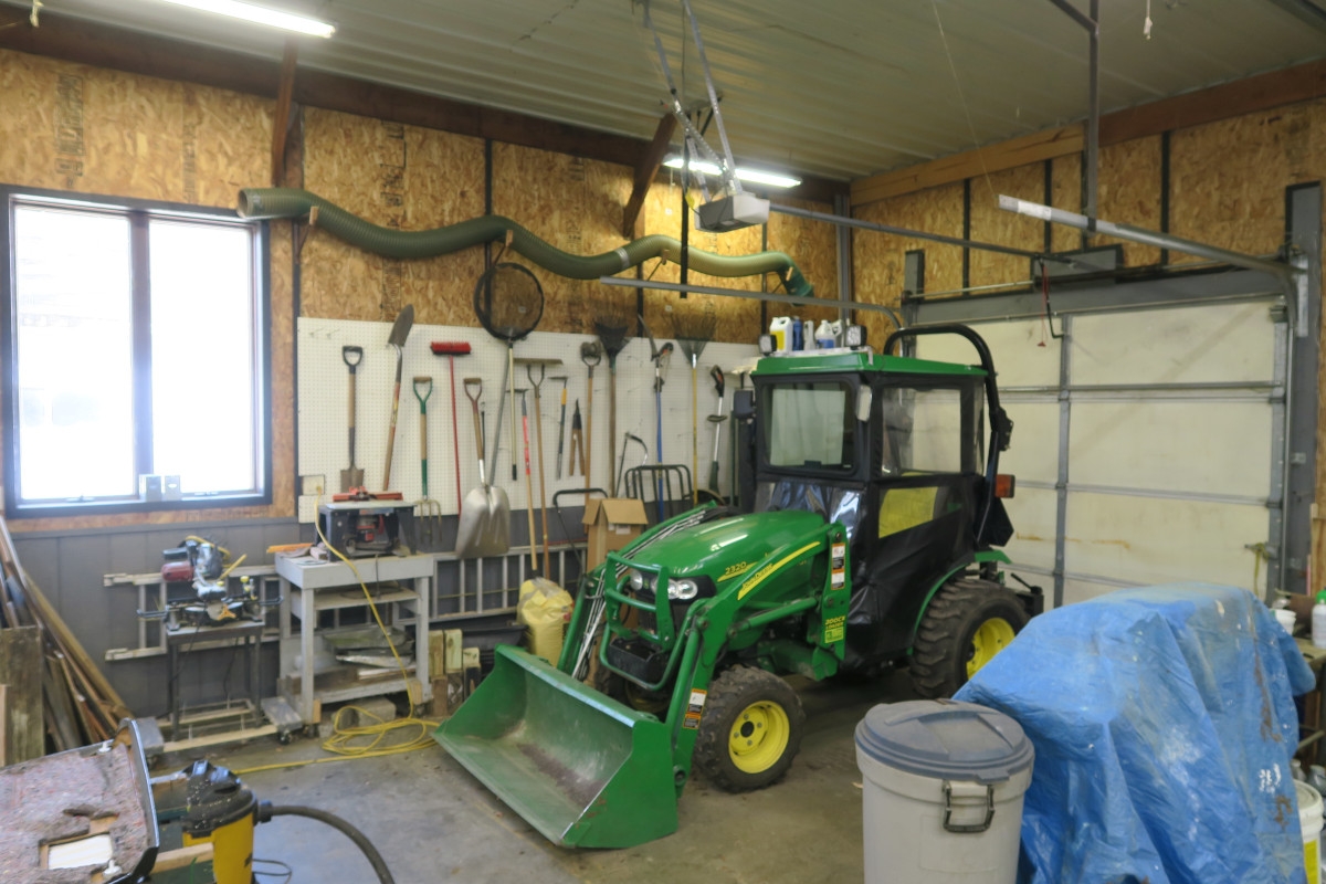

I also like to have an air line that goes through the wall. ...
The first week I had my new tractor I put an air line pass-through port in the side of my garage with my toothed bucket....
That's my story, and I'm sticking to it. :ROFLMAO:
