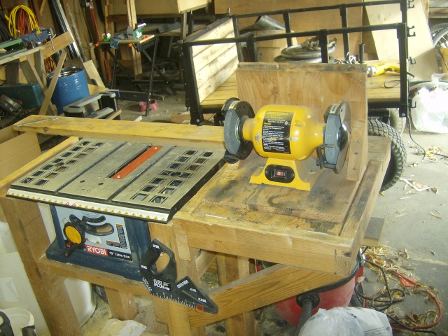

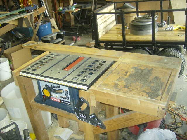

Someone in this thread had mentioned needing to conserve space. I finally unburied my table saw so that I could take some pictures of what I built a number of years ago.
I have my bench grinder mounted so that it folds down into the table like a sewing machine folds into a sewing table. It gives me a place to keep and use the bench grinder, but also leaves that space available as flat work area too.
This is the table flat...
This is the table with the grinder up for use...

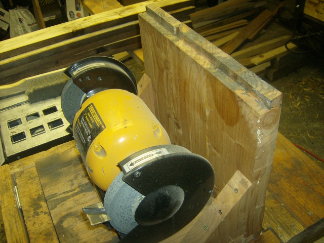

The only real trick is the catch mechanism that I use to hold it in place up and down. I routed a rabbet into the face of it and a corresponding groove in the back plate so that it the whole mechanism would sit flush with the top of the table when it was down...
Here's the catch mechanism up close...
Here's the back plate notched...

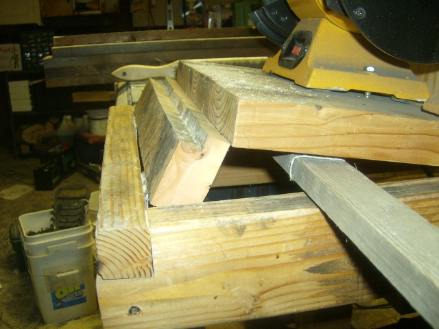

   / Shop Ideas #38
You can see in the first picture above how the catch part hinges up to get out of the way to allow the grinder to move up and down. I've got a set of hinges on this catch, and I have a set of even heaftier hinges on the back to support the whole mechanism.
The first time I collapsed the grinder down into the table I kind of dropped it in place and the whole thing broke right out of the table and landed on the floor below. That's when I figured out that I need to put stop blocks on the bottom so that the whole torque of the grinder being lowered wasn't carried by the hinges alone...
You can also see in the second picture how the power cord comes through the bottom of the platform.

Pardon the mess in the background of every picture I take. One of these days we're going to have a contest of who has to messiest or most cluttered shop, and I will at least be in the top few percent.
You can see the work surface created by the stored grinder is pretty stained and hammered. I have probably done more work on that 1 1/2 square feet of space than on all of my work benches, tables, and tailgates combined.
