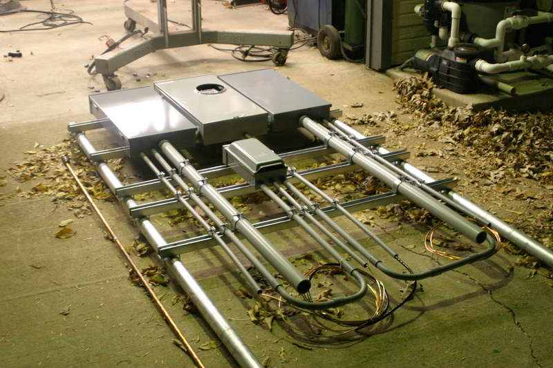

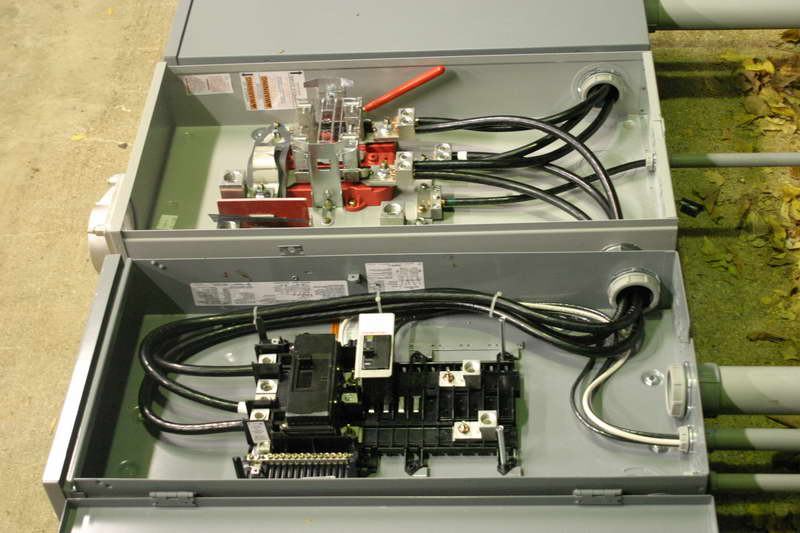

Regarding the generator hook up, if you are using a SquareD QO series panel, I have a pretty simple solution. SquareD makes an interlock kit you can install on the main panel. It is a mechanical kit that allows only the main breaker or the breaker mounted in the upper right hand slot to be turned on AT THE SAME TIME. The breaker in the upper right hand corner is called a “back feed” breaker and is wired to a generator inlet.
On my power pole drop, I have a 320 Amp meter with two 200 Amp main feed-through main panels - one for the shop and one for the house. The 200 Amp feed through main panels have a few slots for breakers and then the buss has connections at the bottom to go to the house or shop where there is a 40 position 200 Amp main panel. The main panels on the power pole have 200 Amp main breakers and the 200 Amp main panels in the house and shop do not have main breakers. Each of the 200Amp main panels on the power pole have 50 Amp 220 Volt feed back breakers that are wired to a common generator inlet. The generator inlet is a Midwest box and is rated for NEMA3R while in use. It has a slanted inlet design and a cover that allows the cord to drop out the bottom while the door is closed.
If power goes out, you turn off the 200 Amp main breaker at the power pole and plug in the generator. You then engage the mechanical interlock and turn on the 50 Amp back feed breaker. I installed a 3R rated pilot lamp wired directly to the meter feed so I’ll know when the power company has service turned back on.
Here are a couple of pictures on the meter base as it was being pre-wired. The generator inlet is the small box in the lower middle. The back feed breaker and interlock kit can be seen in the two close up photos.
SquareD QO series is a bit more expensive than GE or the Homelite series, but I could only find this kit in this series. It’s much cheaper than a transfer switch.
I need to take some pictures of the installation and make a seperate generator hook up thread. But first, I need to get my lights up :)
