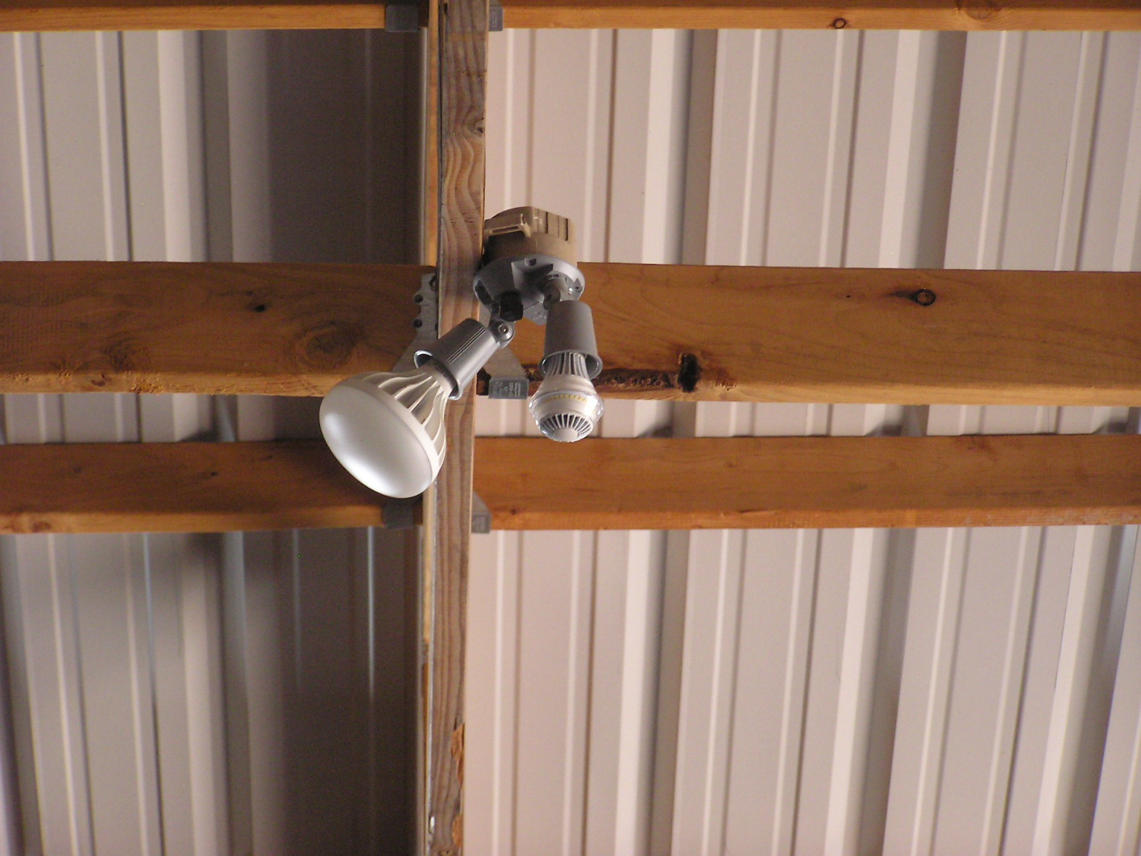

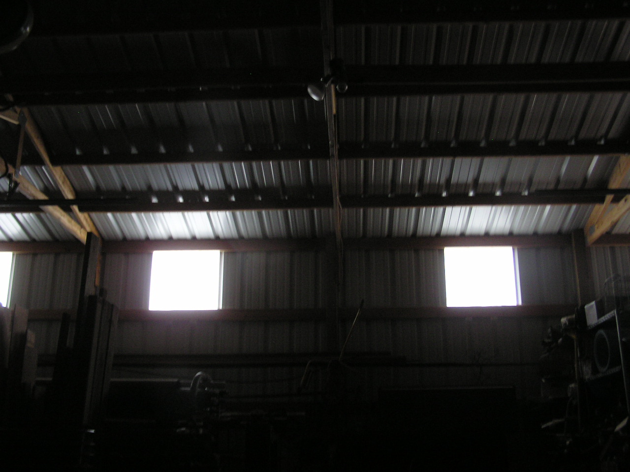

My shop is about the same size, had skylights put in the south wall so don't need lights during the day.
All of my power tools are on casters so they can be pushed together out of the way when not being used.
I started with two LED flood lights on separate switches, in the center, pointed away from each other. That worked well until I found a brighter, whiter all direction LED. It is a 14w, 1200 lumens, Ecosmart brand
I removed the flood for the front half of the shop, aimed the holder straight down and screwed it in.
It lights the whole shop. If I need more light for a project, I use a portable LED work light.
Here is a daylight shot of the south wall.

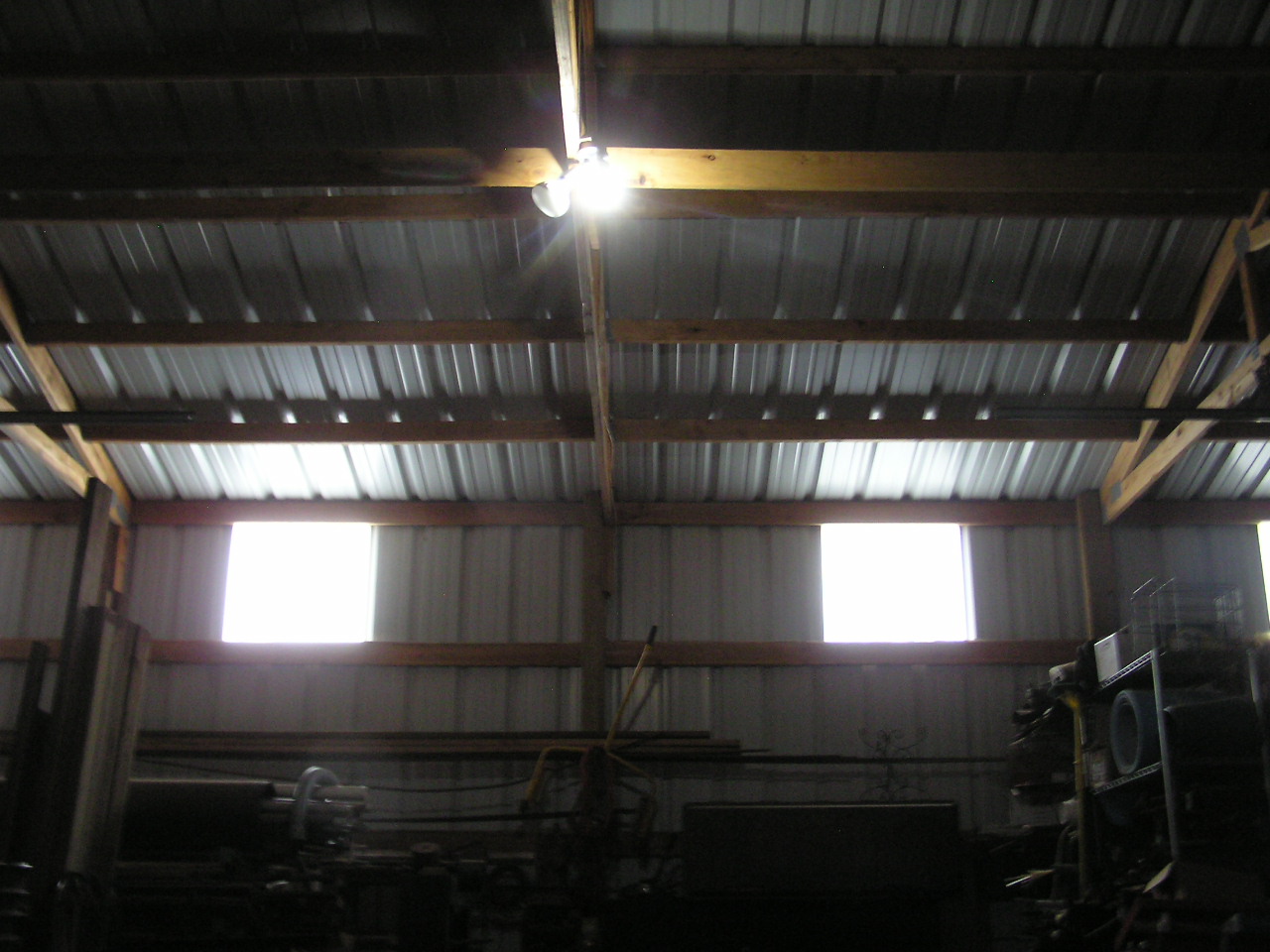

With the LED on, notice how it lights up the wall 15 feet away.

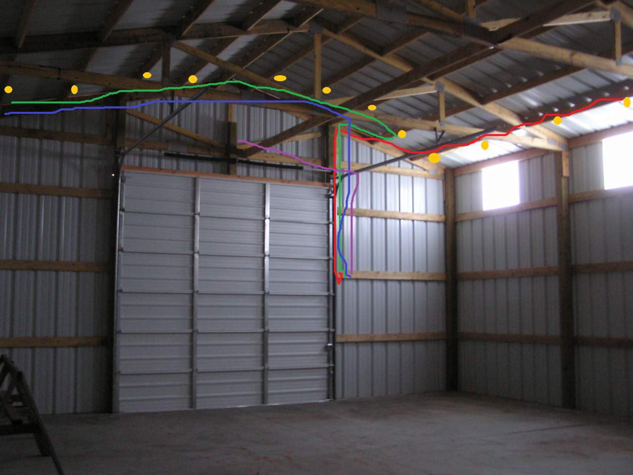

/ shop lighting #4
not a fan of "florescent tubes/lights" more so in cold weather. the lights will begin to flicker and takes some time for lights to become full brightness.
use cheap "incandescent lights" other words screw in type. instant on and full brightness.
--you can pickup metal boxes cheap, and then screw in holders that fight directly to the metal boxes for 1 to 2 bucks last time i looked. (cheap) only thing that really costs is the wire itself.
--multi small bulbs spread clear around the perimeter of shed. = reduction of shadows a big amount. and generally places light between me and any shelving along the walls of shed.
--i have a couple "strings per say" of lights. each on a different switch.
--i already have power feeding to the light switch area. so easy to put a switch and run an outside light above garage door.
i edited one of Xfaxman images. to show approx location of lights i have in one of my sheds.
i would caution use of LED in an unheated / uncooled building. the circuit boards and like of LED's may not last / be rated for outdoor use.

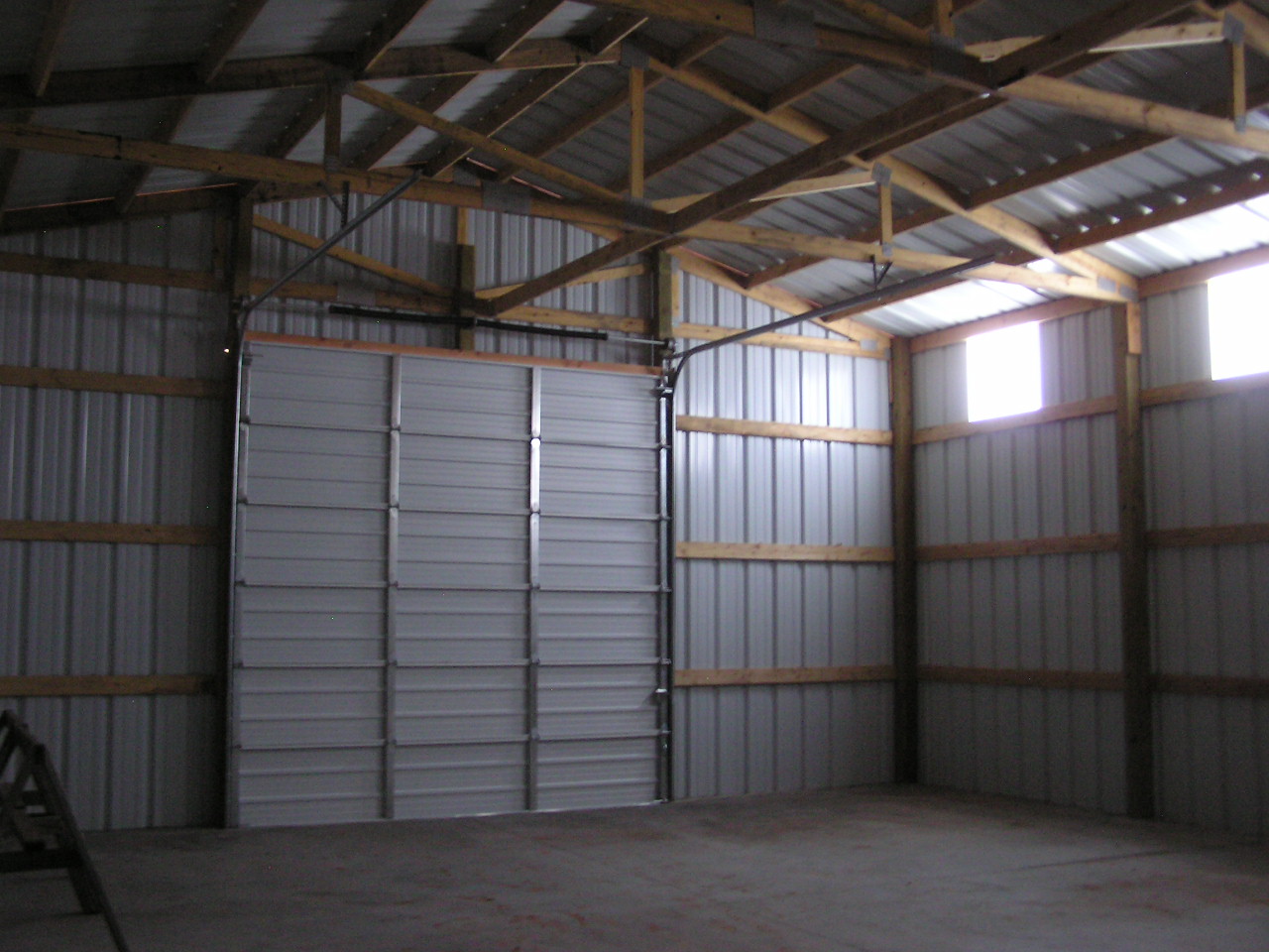

I should be ready to start wiring and hanging lights in my new building, still not sure what I'm going to use yet, I do have 4 400 watt low bay lights I'll hang in part of my shop area, but will need some "instant on" and lighting under the mezzanine. Then something in the "cold storage " area. I built a 40 x 80 of which a 40 x 30 is completely enclosed and insulated, the the remainder 40 x 50 is open on one end.

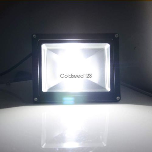

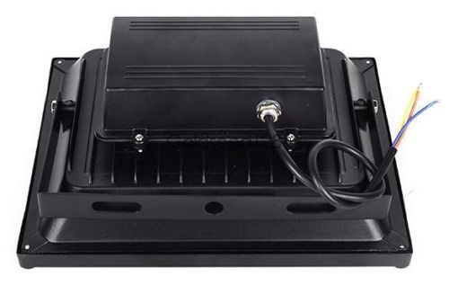

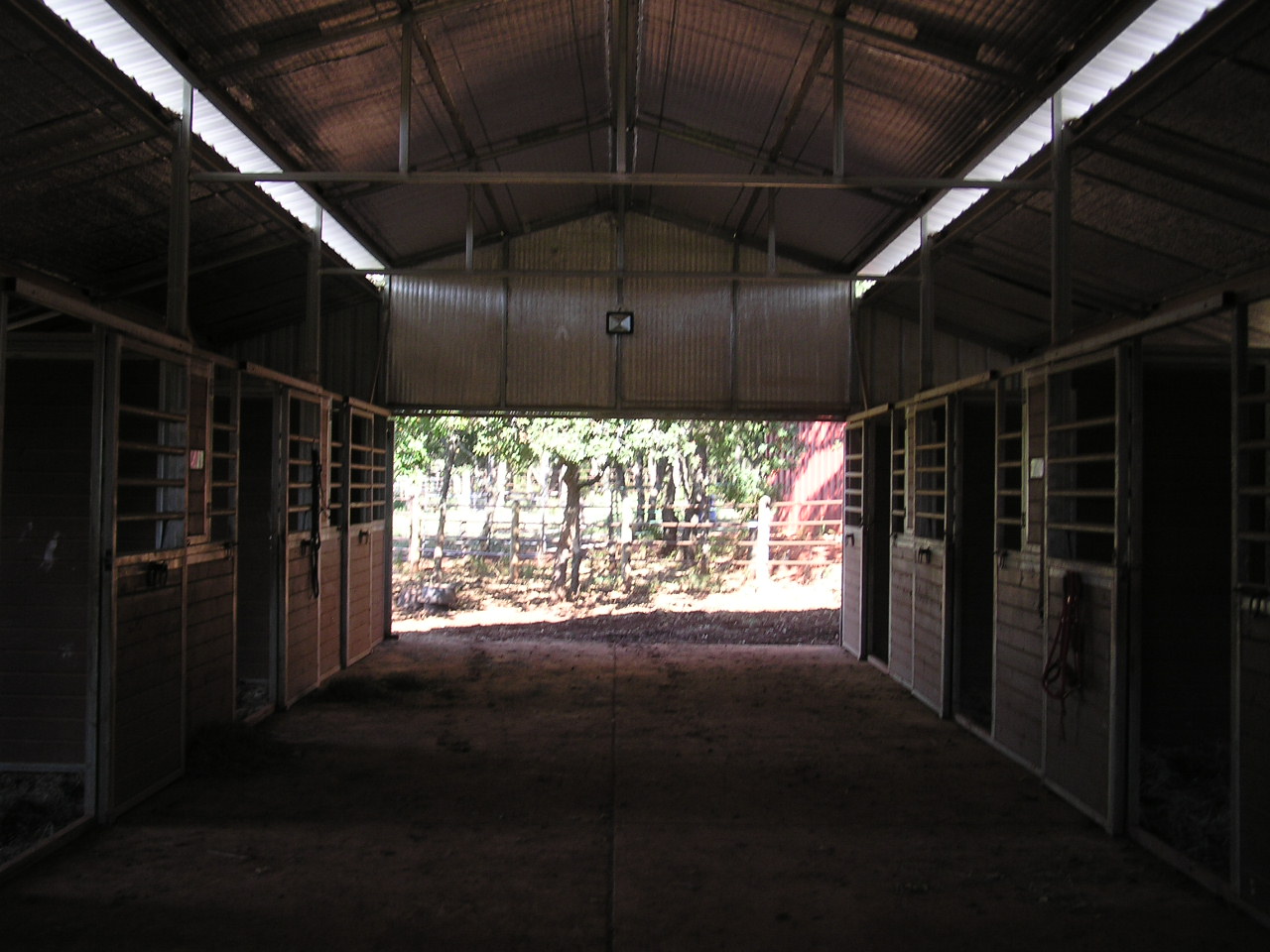

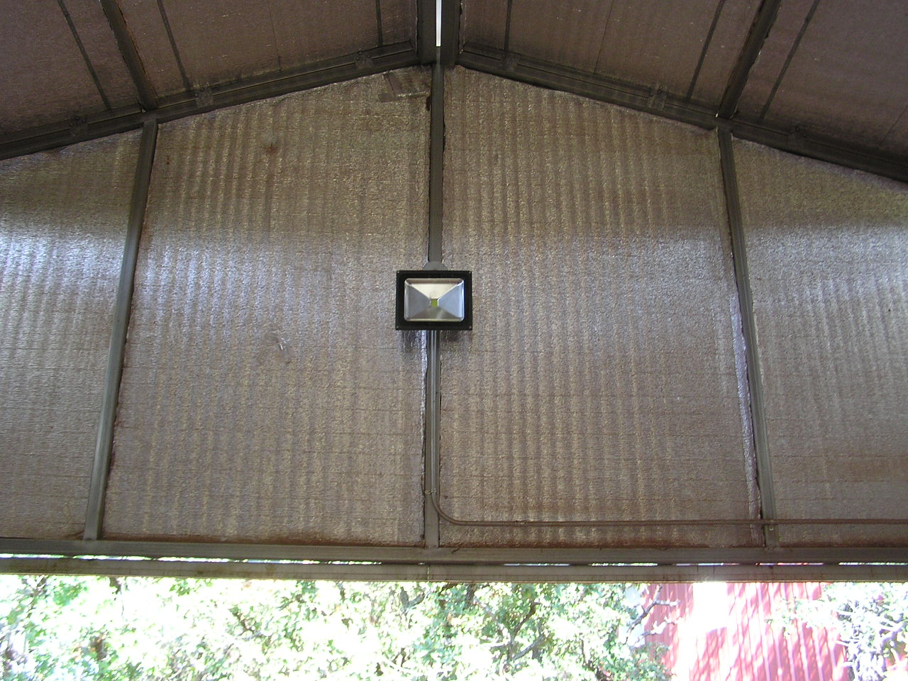

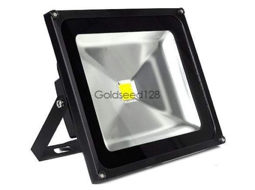

For the "cold storage " area, consider these, 50W LED Flood light, cool white.
I have one at each end of the center aisle in the horse barn. Got them on eBay, $23.17 each.
/ shop lighting #19
Ok thanks I think a few of those would work out fine for the storage area
