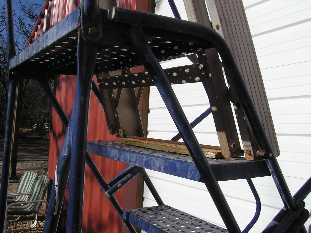

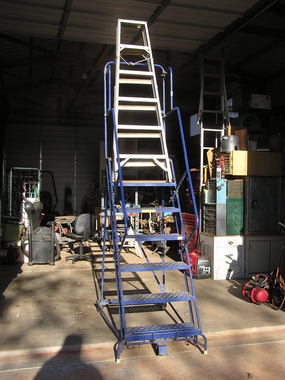

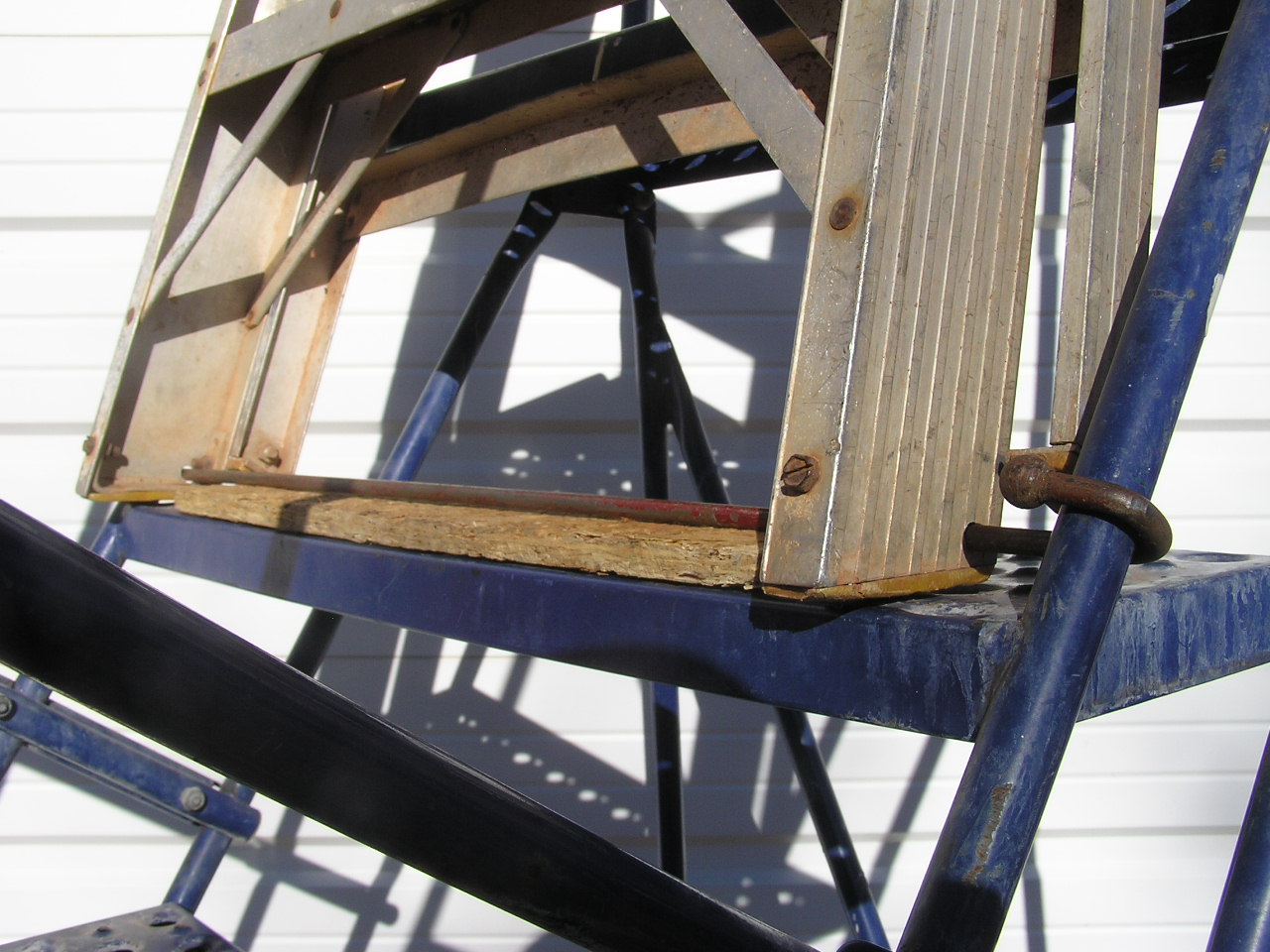

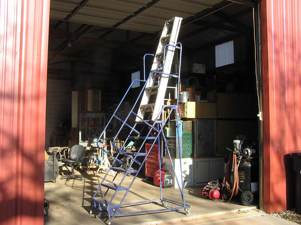

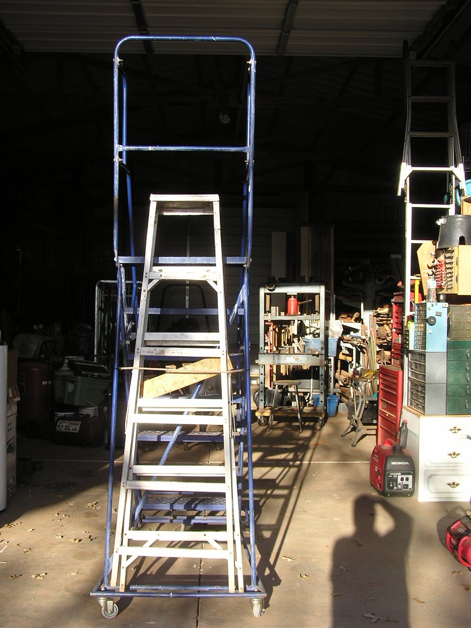

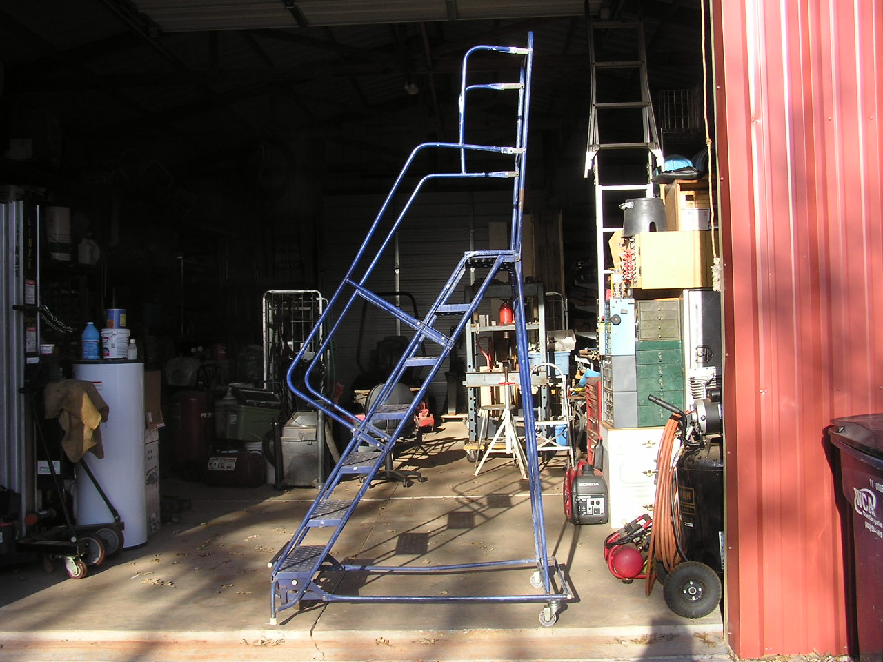

I leaned a 20' ladder against one wall of my barn to paint it, and the bottom slid out -- not sure why but the ground had a slight slope and obviously gave out just enough. I rode that ladder down to the ground, and amazingly did not get hurt. Unfortunately I spilled most of a newly opened gallon of siding stain, about $40 worth. Made a real mess. I barely had enough to finish the barn.
Had that happened to me their would have been TWO messes! Let's just say the gallon of stain would have been the clean one....
