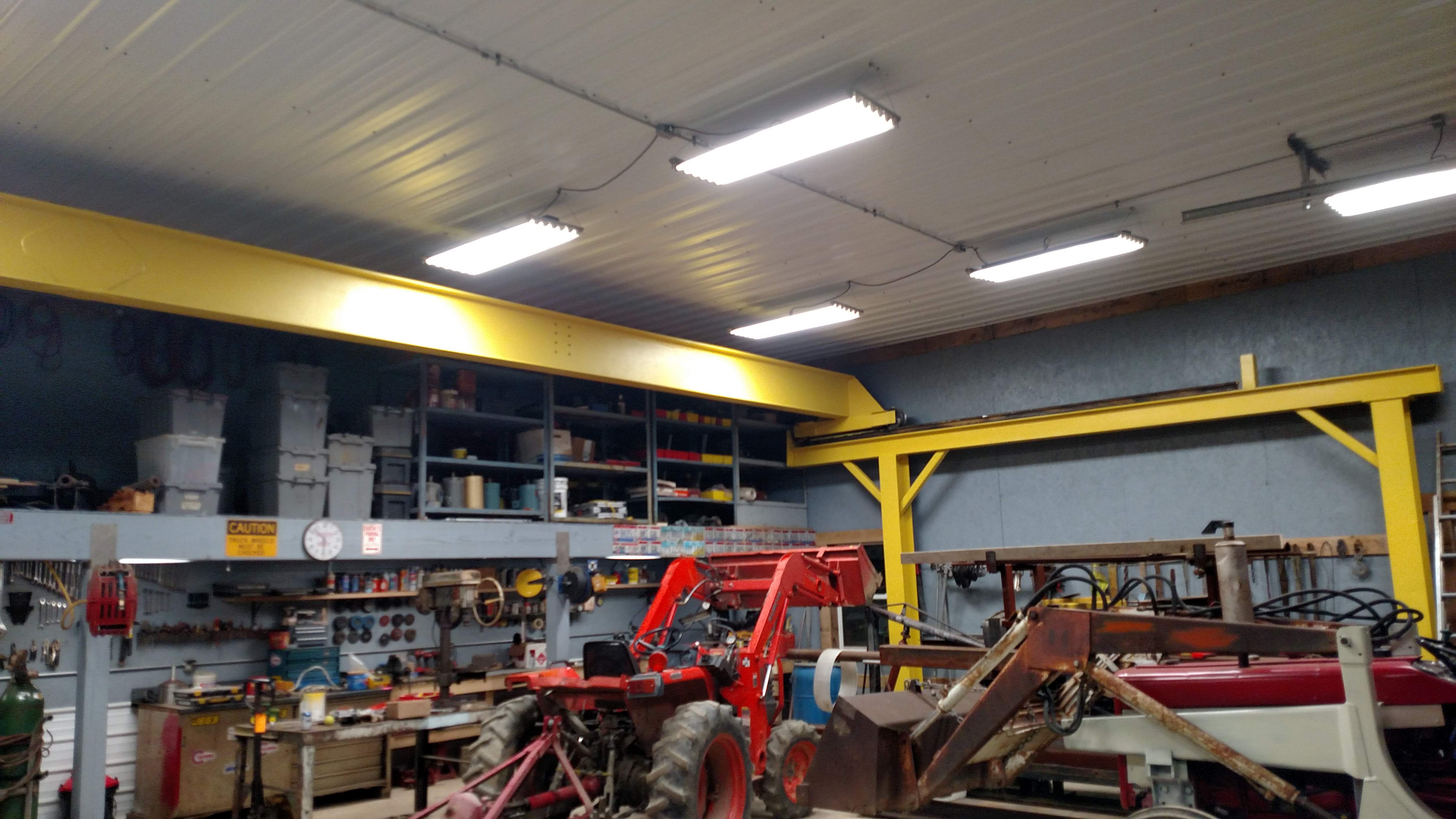

So far it has only been since July but the Costco LED 4' lamps and fixtures are working beautifully and this is in Washington where it can be below freezing... only time will tell.
I was just at the house getting it ready for a new tenant... all of the LED replacement bulbs... CREE or Philips put in last year are 100% good... this is the first time I did not have to replace bulbs and this was only for LED.

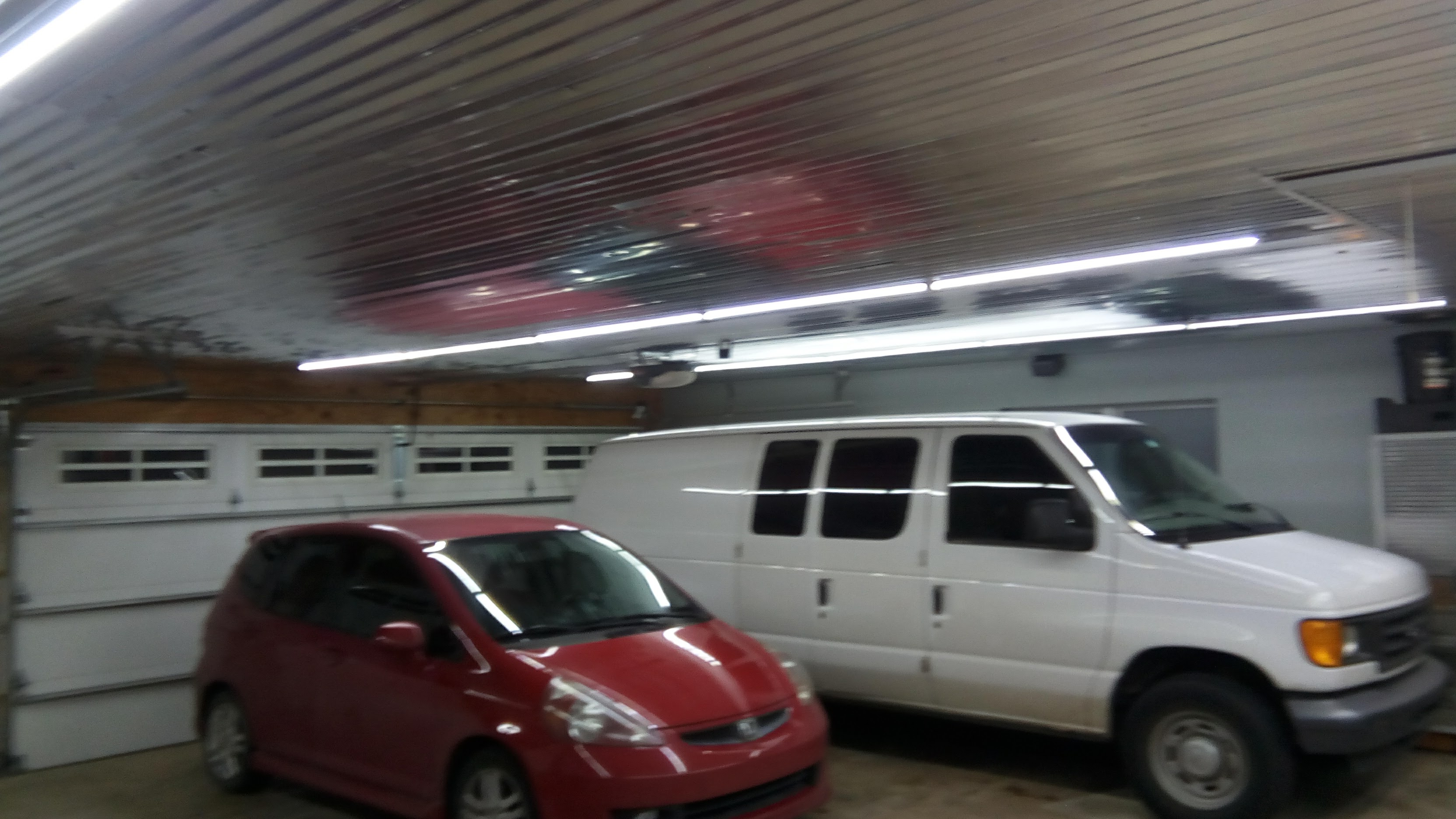

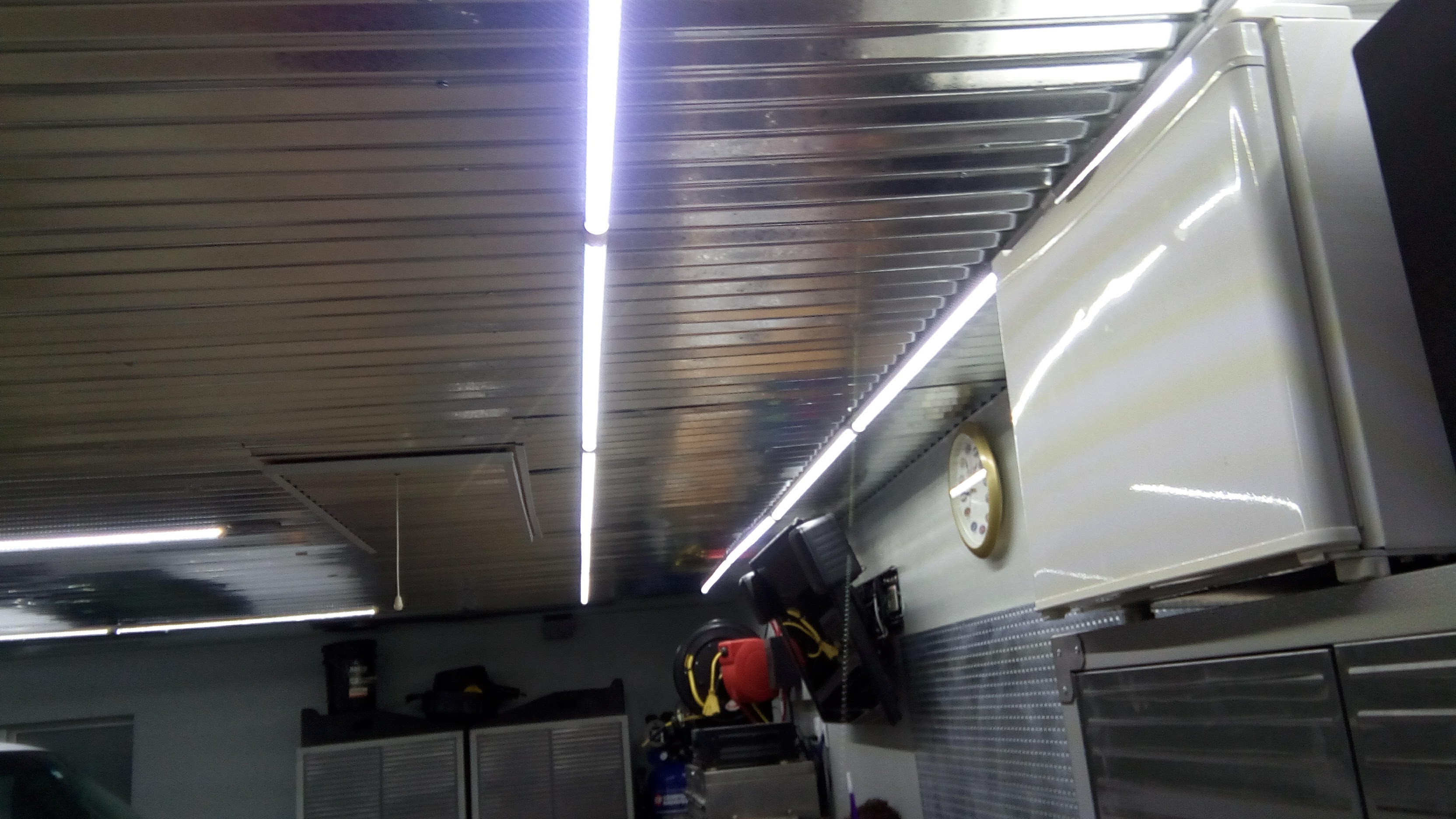

The comment about the drivers failing got me to thinking. I found that the Costco LED's had a transformer to take the 120 Volt AC down to 12 volts. We removed the transformers, or drivers, rewired the six LED strips in the fixture to each take two strips @12 volts. We run these in a cabin without Hydro, just batteries and a solar panel and charge controller.
OK, so, could you take your shop lighting converted to run on 12 volts, use a 4D or 8D Battery, connected to a solar charge panel, and run your lighting needs from a 12 volt DC source.
Humm!, that would be a cool project.
I do this with a garden shed for the last few years, Battery, Solar panel, LED Lights, Simple!

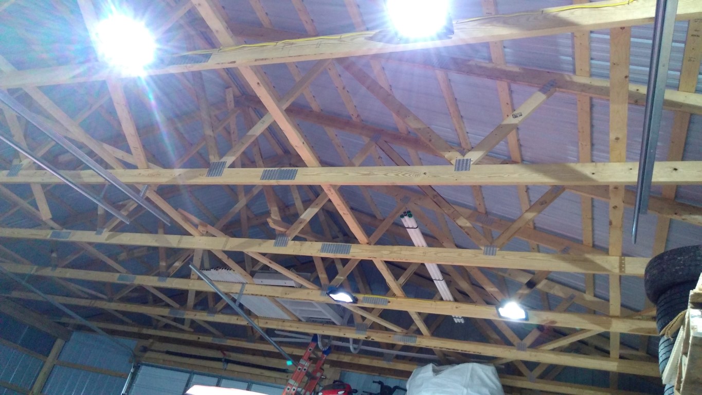

I installed 2 of the 150 Watt UFO units. They seem to be top quality and put out a lot of light. I did a video review and included some light measurements in the shop. I plan on installing two more when I have extra money laying around.
Thanks for the post! I have a few UFOs in my Amazon list. Can you provide a link so we get the right ones? Also can you tell us the distance between the two lights in your test? Thx

All great info for me! I have the same height ceiling, about 10' between electrical rough in AND I had those lights in on my Amazon "list."
Thx for doing the research and posting the video!
