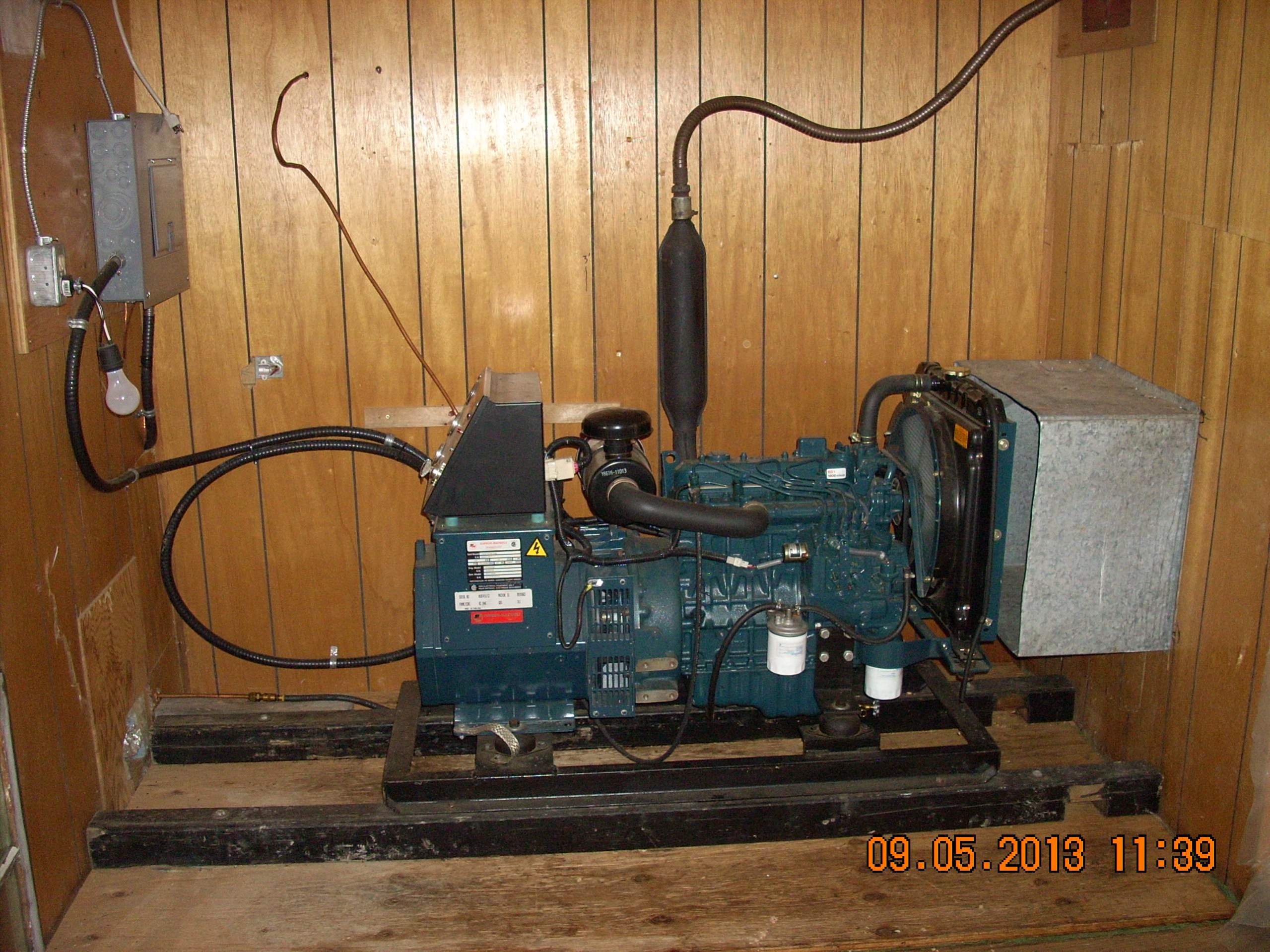

I too have a Kubota generator (12kW) and it powers the house with geothermal heating, stove washer , drier etc. It has been a godsend when we have had power outages with temperatures down around -25C/-15F. The glow plug preheat makes a big difference in starting at these low temperatures. The unit was already installed on the property when I bought it, but had not been used - engine run hours of 2. I reran the fuel system from a 250 gallon fuel tank and it now starts and runs well. I currently have around 160 hours on it with just engine oil and filter and fuel filters changed. Air filter is as good as new. I guess mine consumes around 1/2 gallon per hour at 60% load.
Both of the units are good choices in my opinion. You could probably buy cheaper if you shopped around, but is it worth it. The Kubota has performed flawlessly for me which is important.

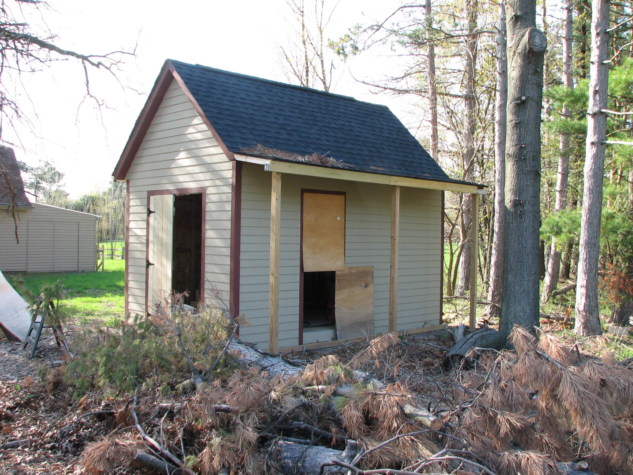

Yep whole house, it will live in my 200 SF generator house.. this is an old photo, its all finished now.IMG_4341.jpg
