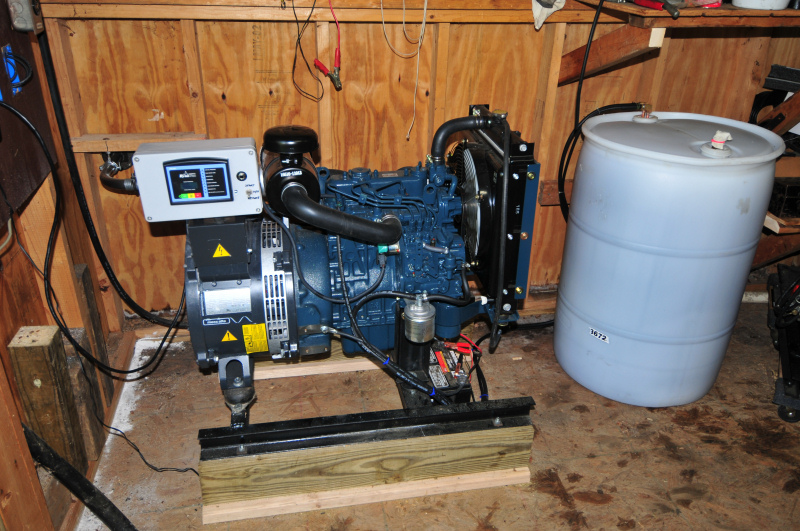

I bought the same Kubota a couple of years ago. It is a very nice unit and performs extremely well. I can power my whole house with no problems, running 3 heat pumps + 3 refrigerator/freezers. On outages I shut down the HPs and turn on the electric HWH to charge it up for a day's use (it is an 80 gallon unit). That takes about an hour. On average I use 0.3 GPH of diesel to run the house during an outage.
I got the Kubota as well so that parts/filters/etc would be common with my tractor.
If you order one, you can get a start/control panel for a couple of hundred bucks extra. It does preheat, cooldown, fault detection, etc and shows frequency, hours and other data. It came all wired in by Central Main. It provides a 2-wire start/stop for "remote" starting.
Great unit.
Paul

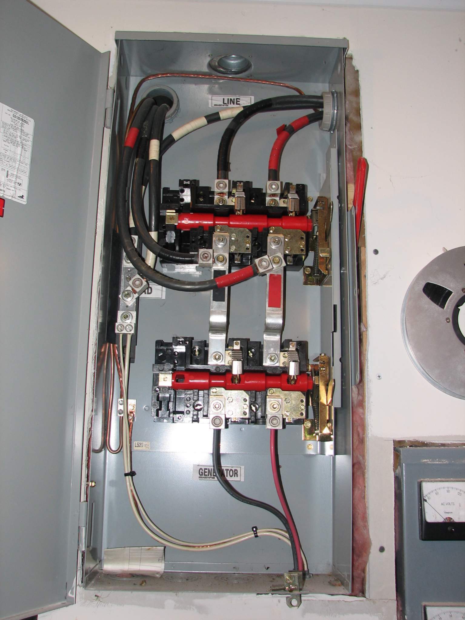

I didn't see the option for an automatic transfer switch with the Perkins? And I didn't see the option for a remote start with the Kubota?
I'm imagine you could get either aftermarket though.
How will you be enclosing it? Will you be using it for a whole house generator? Are you going to tie it in with automatic transfer?
On the Kubota, it gave the option for a 100amp transfer switch. Does this mean you can't use it for a 200amp panel? Or do you just get a second transfer switch to make 200?
/ Shopping for a generator #10
I think the idea is that you pick several circuits that you deem critical, and route those through the transfer switch. Remember it only outputs 40 amps give or take...
If you didnt want to pick an choose then I would just go with a manual generator disconnect breaker and back feed the entire pannel.

If you do not need automatic transfer, but a simple mechanical, like: Generator InterLock Kit Manual Transfer Switch
You can feed the whole house, and does not cost much. As for the start control, Central main does not list it, just call and ask about it.

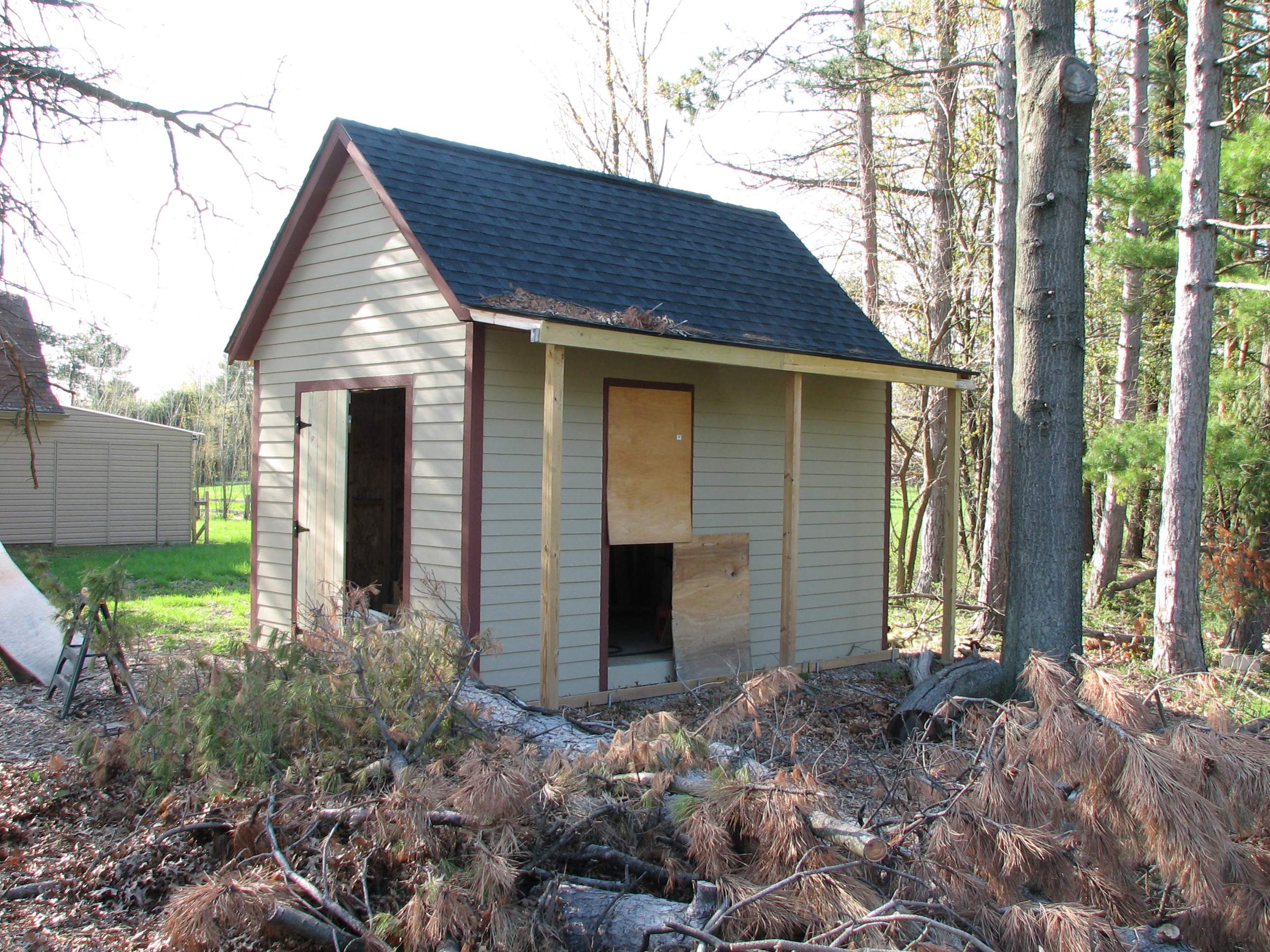

Thanks for the replys, I am all set with a switch, this is a replacement for the 10kw gas unit I have now..
#15
Yep whole house, it will live in my 200 SF generator house.. this is an old photo, its all finished now.IMG_4341.jpg

Nice generator house Hunter! :thumbsup:
#17
Thanks Piston..
