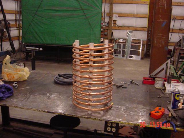

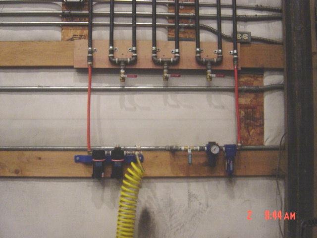

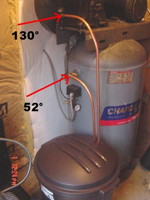

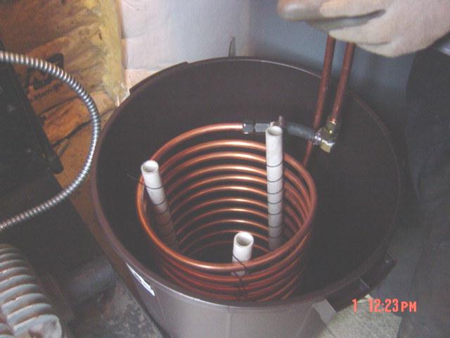

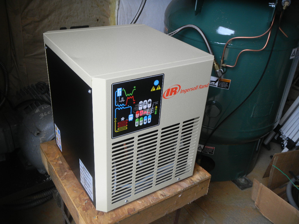

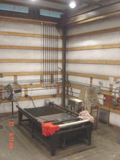

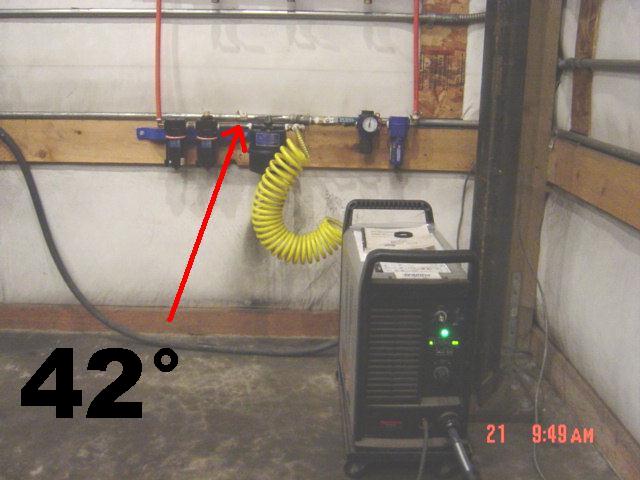

I made my first air dryer. Used copper tubing for the intercooler, (fill the garbage can full of tap water). Black pipe for the after cooler. Years later I bought a refrigerated unit.
