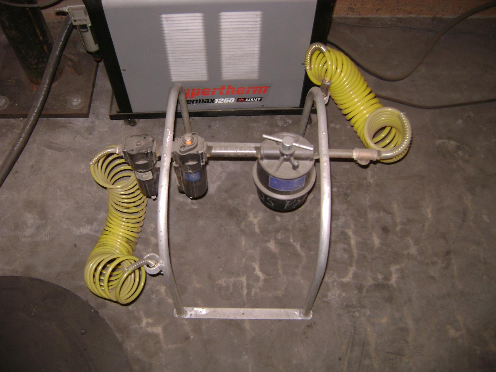

I like the external ones you can put a roll of toilet paper in. I use them painting and air brushing also.
I built an aluminum tube frame for my Motor Guard filter system. I use it for the plasma, painting, and even the nail guns.
