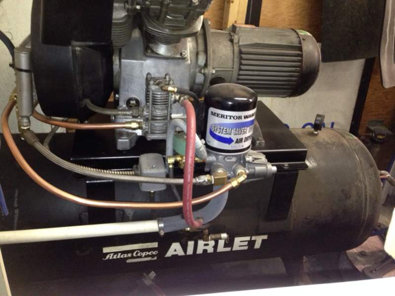

With the help of a friend I built this homemade dryer for my shop compressor many years ago. Less than a couple hundred dollars worth of parts and fittings and lots of head scratching.
Incredibly dry air.
Maintenance free so far.
My recommendation? Buy a refrigerated unit like Shield Arc. If my compressor ever packs it in my 'dryer' will consist of nothing more than a box of hardware and fittings.
This wasn't exactly one of my 'best good ideas' but then again if it's the dumbest thing I ever do I'll be doing okay.

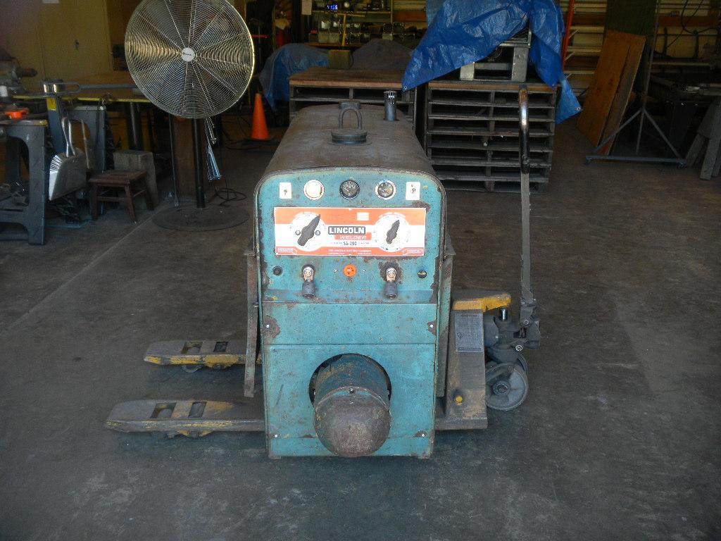

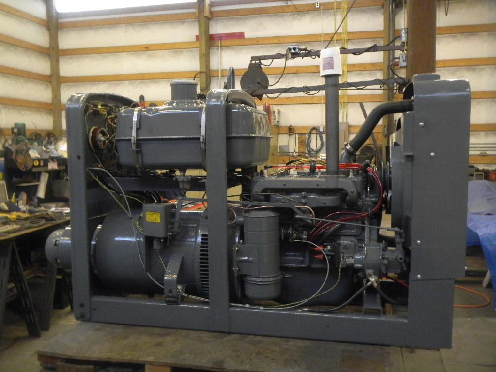

I don't hardly use my plasma, but having the air dryer really comes in handy for painting too. Right now I'm letting the primer dry on a friend's hood to his Lincoln SA-200 welder. Later today I'll spray the color on the hood. This is a before picture, and what I have done so far.

I made my first air dryer. Used copper tubing for the intercooler, (fill the garbage can full of tap water). Black pipe for the after cooler. Years later I bought a refrigerated unit.
You aint fooling us hillbillies. we all know those first couple of pics are of a worm. Just what is it your brewing??
