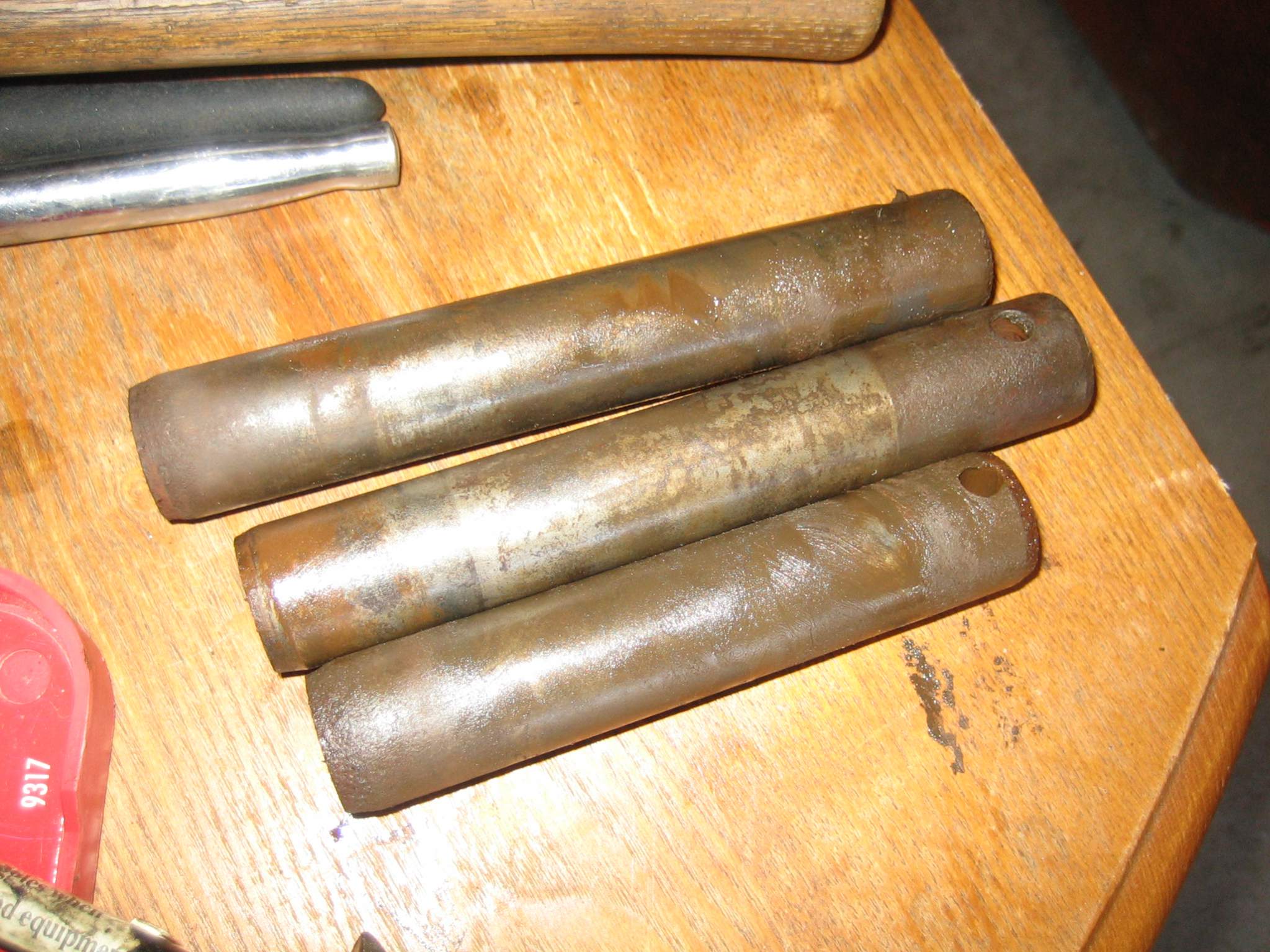

Started removing the cylinders, Pins don't look too bad
Was trying pull the rod out of the cylinder to remove oil & clean and its very difficult by hand, any suggestions ?
Also need to size these hoses/fittings. The fitting at top of cylinder measured 1/4" id on the hole. Hose is about 1/2" od
   / Should i bother with this Rusty Dirty Hoe? #25
Run the cylinder in and out by hand and you will get rid of 99% of the oil. Put in a cup of diesel and you can get the last little bit.
Aaro Z
#26
Aaro Z
This was the issue, im a big guy but im not godzilla. could budge it a bit by twisting with the pin in or hitting with a hammer
   / Should i bother with this Rusty Dirty Hoe? #27
Use compressed air to extend and retract the cylinder but be careful it will go fast and probably throw a jet of oil
