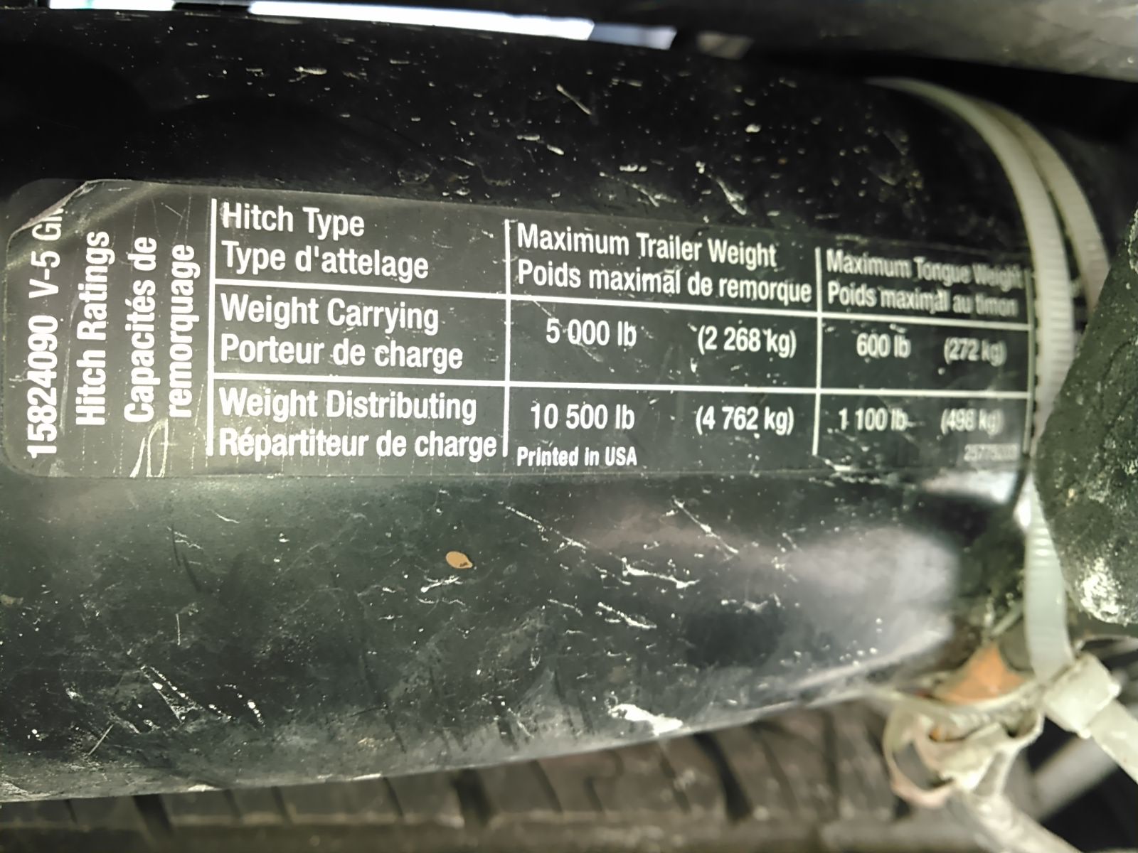

I just looked at my truck hitch. I have three trailers a camper (under 5k loaded), a 14' 6k total) car utility and a 5-ton dump. I need to use WDH with all but camper most times I use them.

Even up grading to a Class V hitch won't really change the rating. There may be some other variable, like the frame where the hitch hooks up, that still limits it. The WDH is the way to go to be legal.

That's a good point. I think it is the factory installed hitch so there might be something to that thought. Looks like the WD hitch is in the near future.
