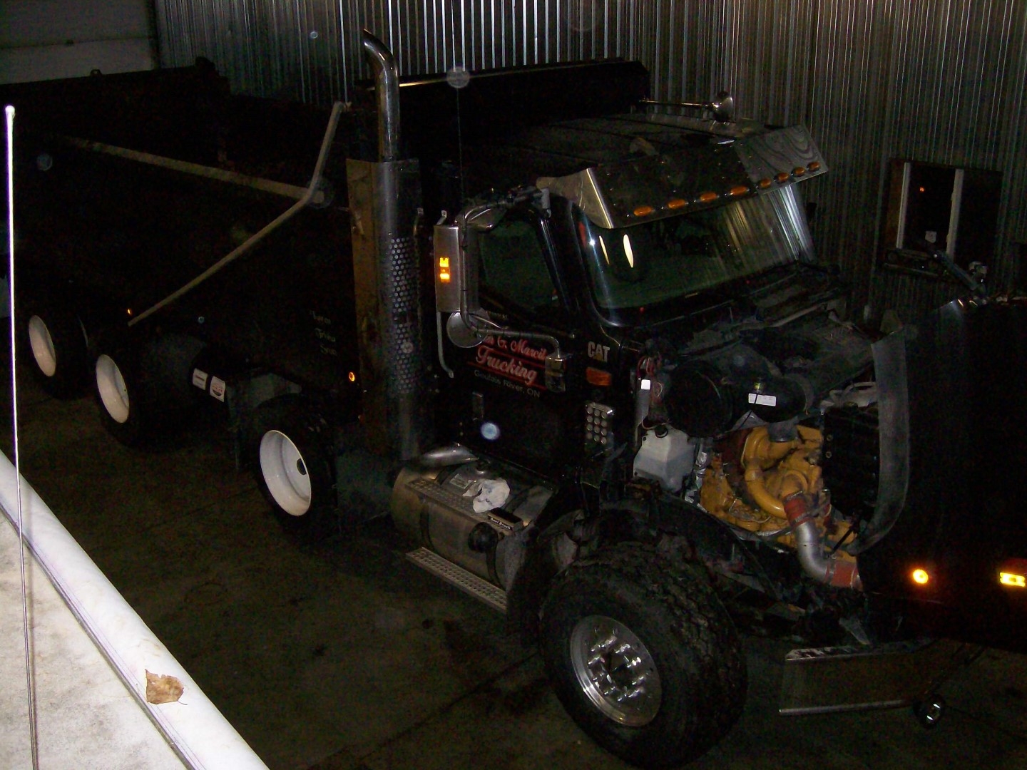

Most of the issues you noted were the C15 ACERT. The C13 rarely had any of those issues. And that's coming from my dealer Toromont Cat. My C13 never had a single issue set at 525/1650 torque.
I did buy all the extended warranty I could get though just to be safe because back in 2005 if anything went through the turbo's it would have been minimum 15 thousand dollars according to what Cat said it was costing the C15 guys.
Like the C12, that C13 was a strong little motor. I used to load 21 metric tonne of asphalt and pull out of driveway onto a 10% hill with two other friends that had Cummins ISX 565/1850's. We all had 18 speed double overs, 4.11 rears on 22.5 rubber and though I couldn't pass them I could stay on their tailgates and have to lift on throttle.
Ashamed it's dirty in this pic but it was winter time and I was doing an oil change.
