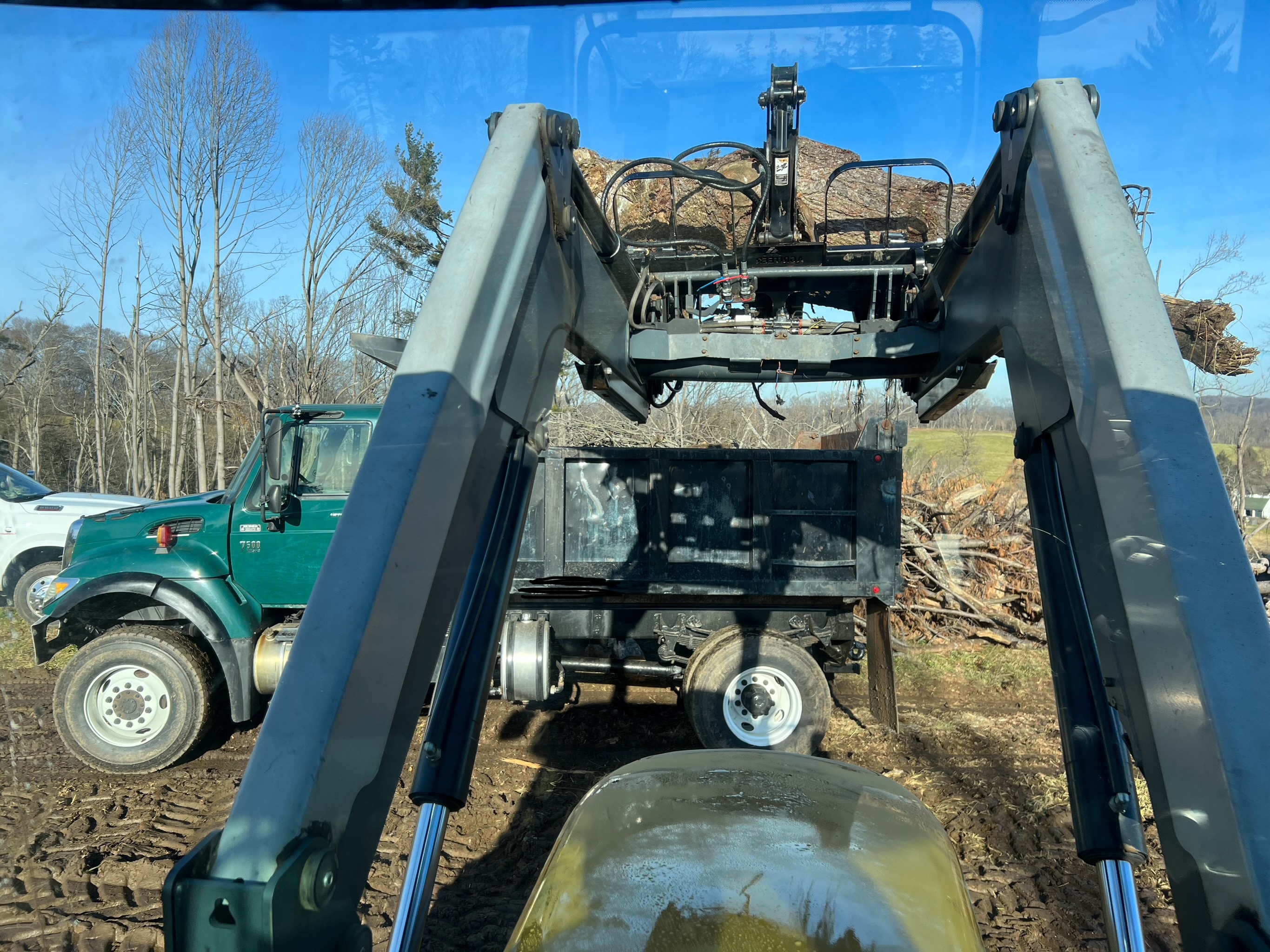

Ive had drywall delivered by trucks just like that and although not a 6x6, they do very well.
I kind of realized the same thing a while back. If it’s that muddy, I don’t belong in there. But lockers will be nice for a couple uphill slogs I have from some lower “hollers” I hay.

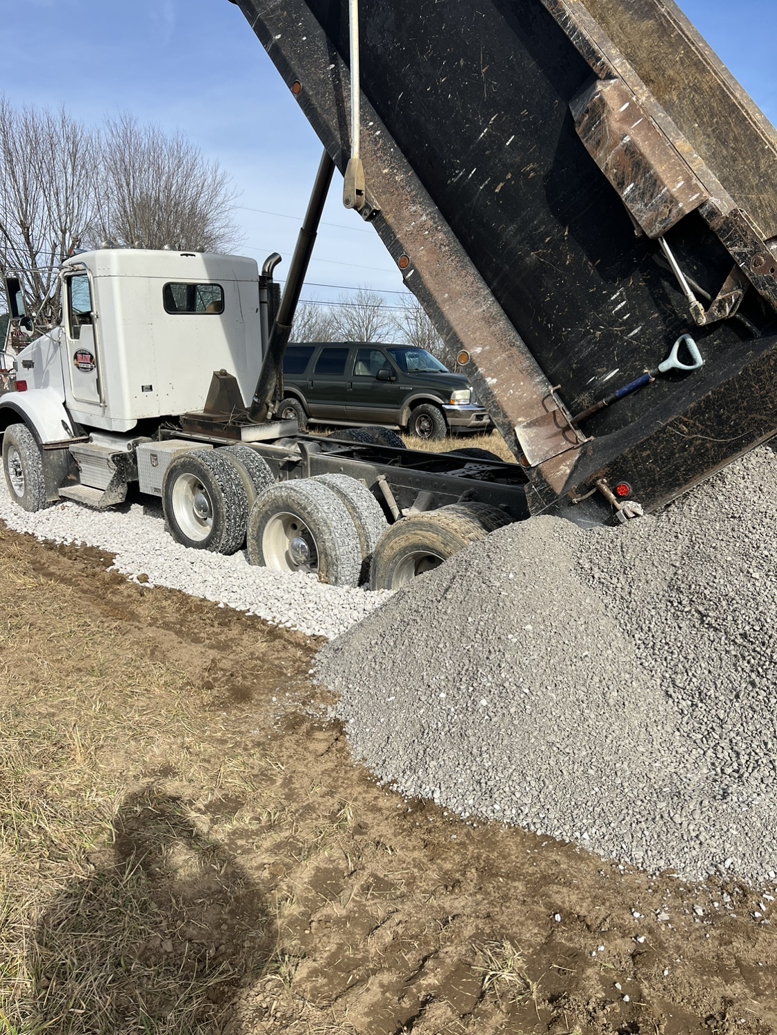

I wondered about height.
You know about the 6x6 dream, I have limited experience in that class truck (in awd), but in reality (and IMHO) if a tandem with inter axle lock is not enough to pickup your big squares in the field, you really shouldn't be there unless it's just the morning dew and a few hours of sunshine would make it passable.
Maybe adding some additional time to the weather guesswork that hay making is and stack near a roadway or somewhere with suitable (flat & hard) 10 wheeler access.
That’s kinda what I think. We’ve had loaded dump trucks in pretty bad places and when they do get stuck I can’t imagine 6x6 changing the outcome all that often. Maybe after the dump truck dumped the load 6x6 would have helped but there’s zero chance it would have came out loaded.

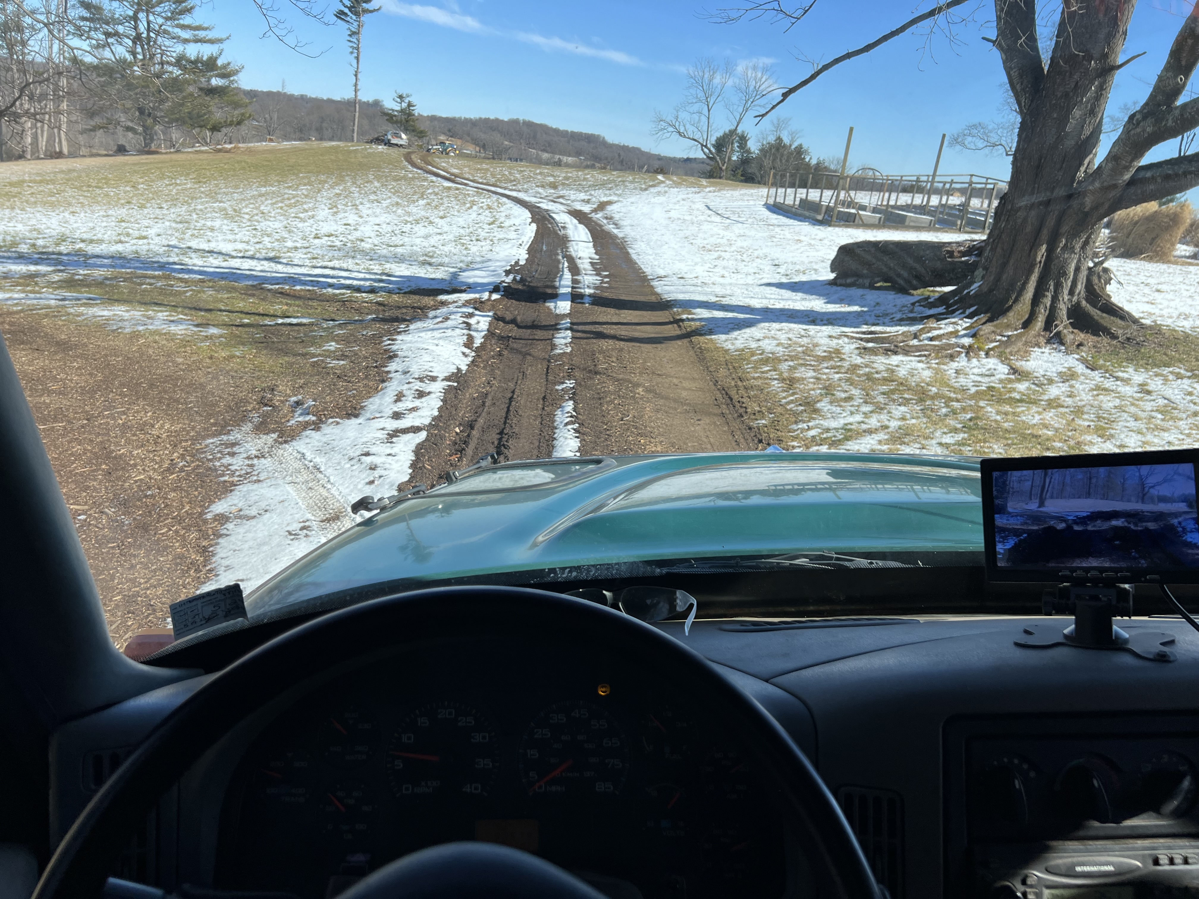

You have to own & operate one to really know. We did 2 winters of sloppy, muddy work with my 4x4 dump. Several days of driving over frozen ground with the upper 1” thawed is really challenging, but the 4x4 (along with the diff lock rear) made it possible to haul logs when tandems would have been stuck. Even my buddy with a Mack tri with lockers wouldn’t venture where I would.
That front axle can get you out of trouble (it can also get you in trouble if you get over confident)
Once the sun gets on this frozen trail, it’s slicker than owl schit.
