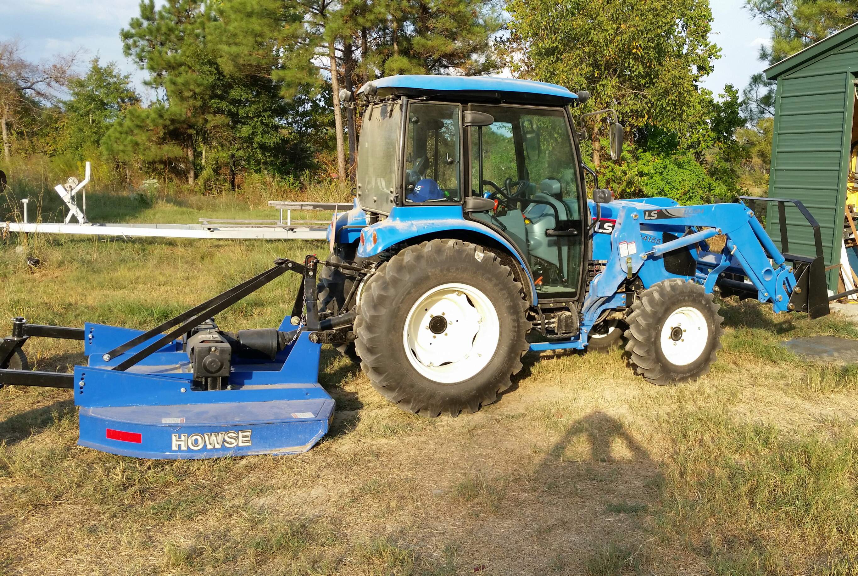

Well I finally got time to go check out the cutters. I came home with the 8'er. The 7' one had cat 2 pins so I tried the 8 first. It seemed like a perfect match, and I never even got around to trying the 7'. It's a cheaper brand but it seems plenty heavy enough for my uses. I snapped a couple pics before dark.

When I got home I checked oil level in the gearboxes and discovered the center gearbox had a little pressure. So i took each vent cap and used a small nail to free the spring loaded plunger inside. They are all working now and should solve the pressure issue.

Nice pick.

I'd say you have a very nice setup there. Keep an eye on fluids and you should be golden.

I think you made a very smart choice in choosing the 8' over the 7'. Well done.

The LS tractor you have has 47 pto hp, it should handle the 8' cutter just fine. I'm running a 7' cutter with something like 35 pto hp.

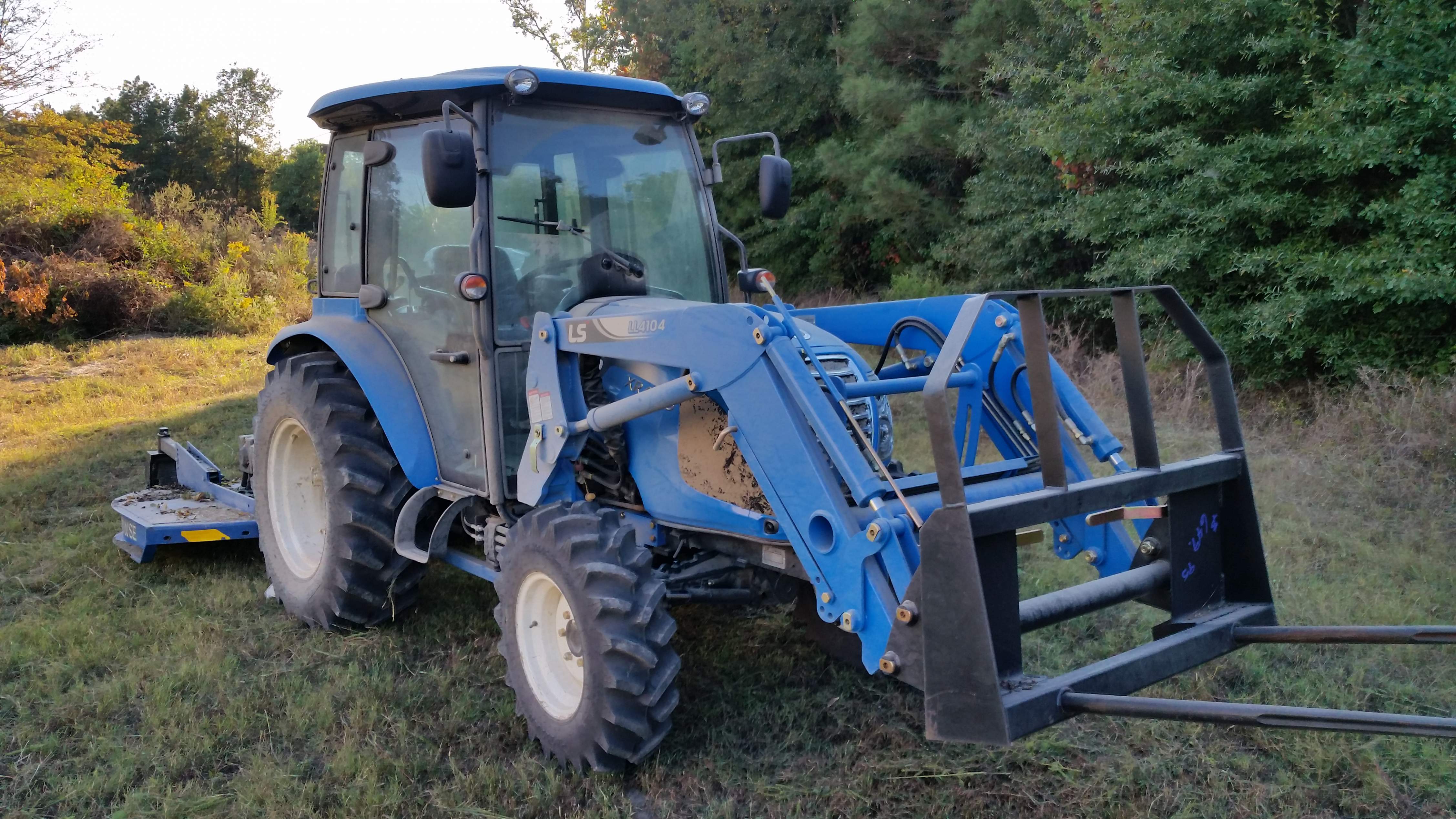

Thank you, yep after considering everyone's advice I figured I'd have plenty at the pto for the 8'. And probably enough weight and power for the seven footer as well. But I went with the 8 and I am very satisfied with it. I mowed a couple acres today with it and I love it. The extra width sticking out past my tires is very nice for getting close to trees and fences. It feels light on the tractor when lifted too, despite the 120 and 100hp gearboxes. My poor old 6'er may not see much action anymore hahahaa!
Btw check out the chaff stuck to the front of the hood! The tractors temperature never even moved
