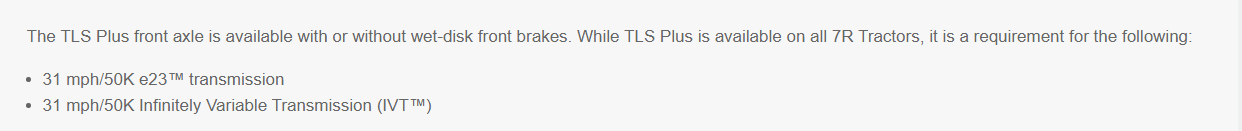

OK, I checked John Deere's site for a typical compact tractor and it has no optional foundation brakes. Show me one that does.
Doubt any compact would have front brakes, full frame ag tractor they are available on some.
