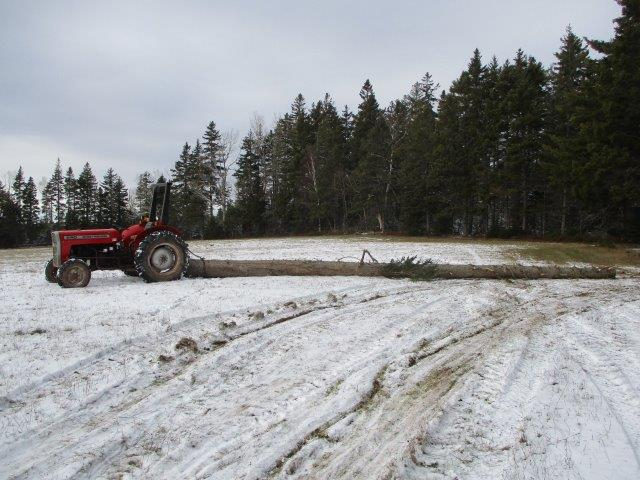

THis generated a lot more discussion that I thought it would. Some more info. I am only looking at 40-50 hp tractors, Massey 150, Ford 3600. I don't have an unlimited budget, looking at 4-6000 for the tractor. If it does not have ROPS, I will add that first. Main uses will be to power a chipper, power a farmi type winch, maybe bush hog, and if I find a loader, move logs onto the sawmill. No mud, I don't need to work when it is muddy or wet. The BX2230 and BCS 850 can handle all the snow we get, short driveway. Yes, our hills are steep, no crosswise mowing, but I can get to most of it on the ridges or the bottom if I need to pull. The timber I have is fairly large white pine, but I have no need to move more than a 16' log. And speed is not an issue, i'm old and slow. If I could find a 4x4 in the right price range it would be my first choice, I just haven't seen one.
2wd on ag tires with tubes loaded with calcium. No rust issues 30+ year old tractor. That log is 36" butt and think there was 2 x 16' and 1 x 12' saw log in it.
$6000 will buy you a solid 2wd for what you want.
