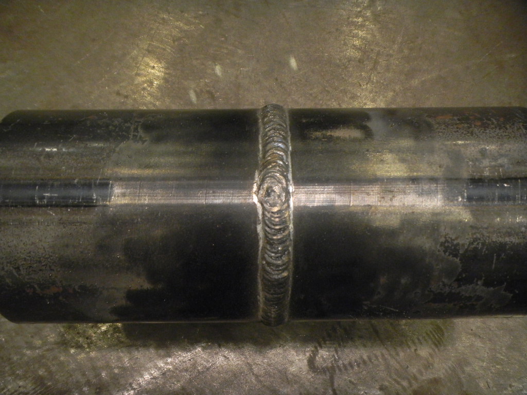

You could always use gas less flux core wire in your Mig machine. For what little you weld why mess with converting your AC only machine? Maybe pickup some Hobart 335A 6011. I find it to be childs play to run. I'm fairly new to the welding game myself, but here is what I can do with Hobart's 6011.
