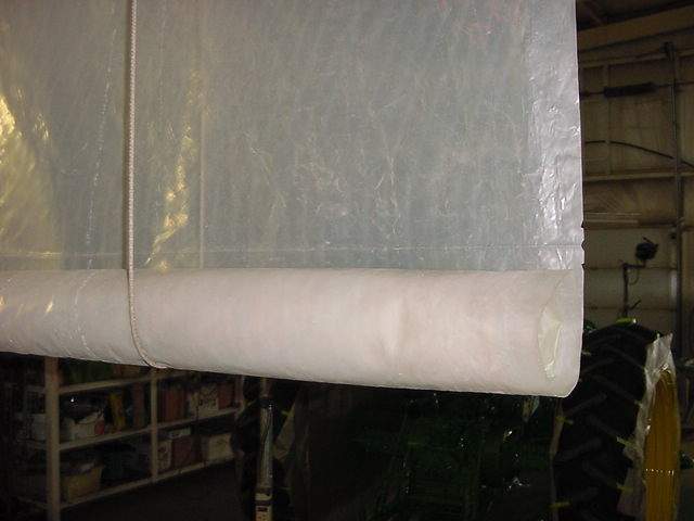

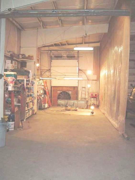

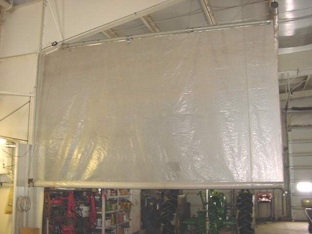

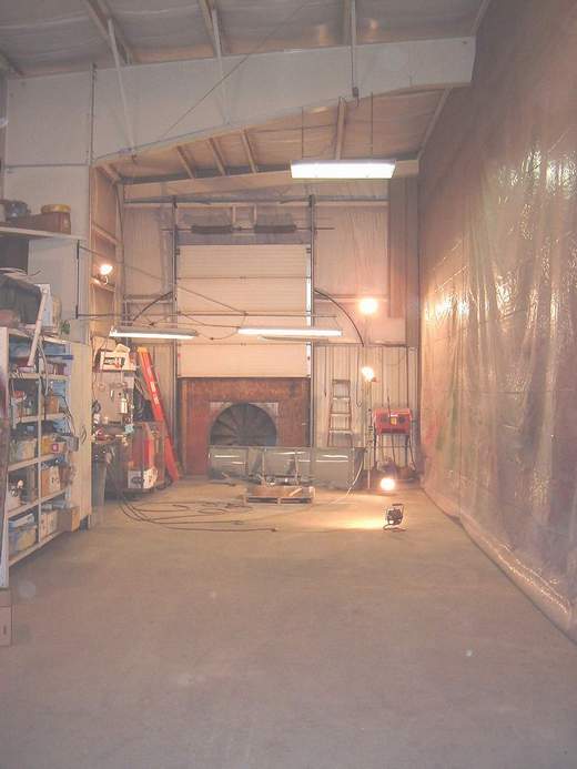

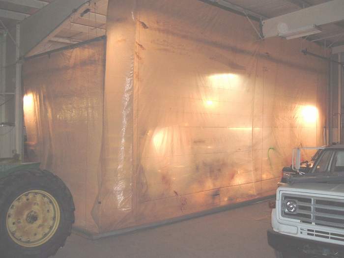

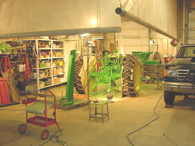

Back on post #8, picture #2 you have a picture of a tractor that looks like it's in the process of being painted. In that picture you also have what appears to be roll up curtains. What is the purpose of the curtains?
   / Should I post shop pics? #23
Yes, please describe briefly. I'd like to have something to heat 1/4 of my barn. Those rollups look more promising than other 'curtain' ideas I've pondered.
   / Should I post shop pics? #24
Guys want to do curtains need to look into billboard skins and heavy plastics like used for lining crawlspaces. Pretty much everything you need available.
Visit local pool store too, lot of bubble covers and other covers come back under warranty. store has to pay trash hauler to get rid. Generally dey happy to help you load to save trash fee. Bubble stuf real good just hanging down inside of wall.

Paint booth.
