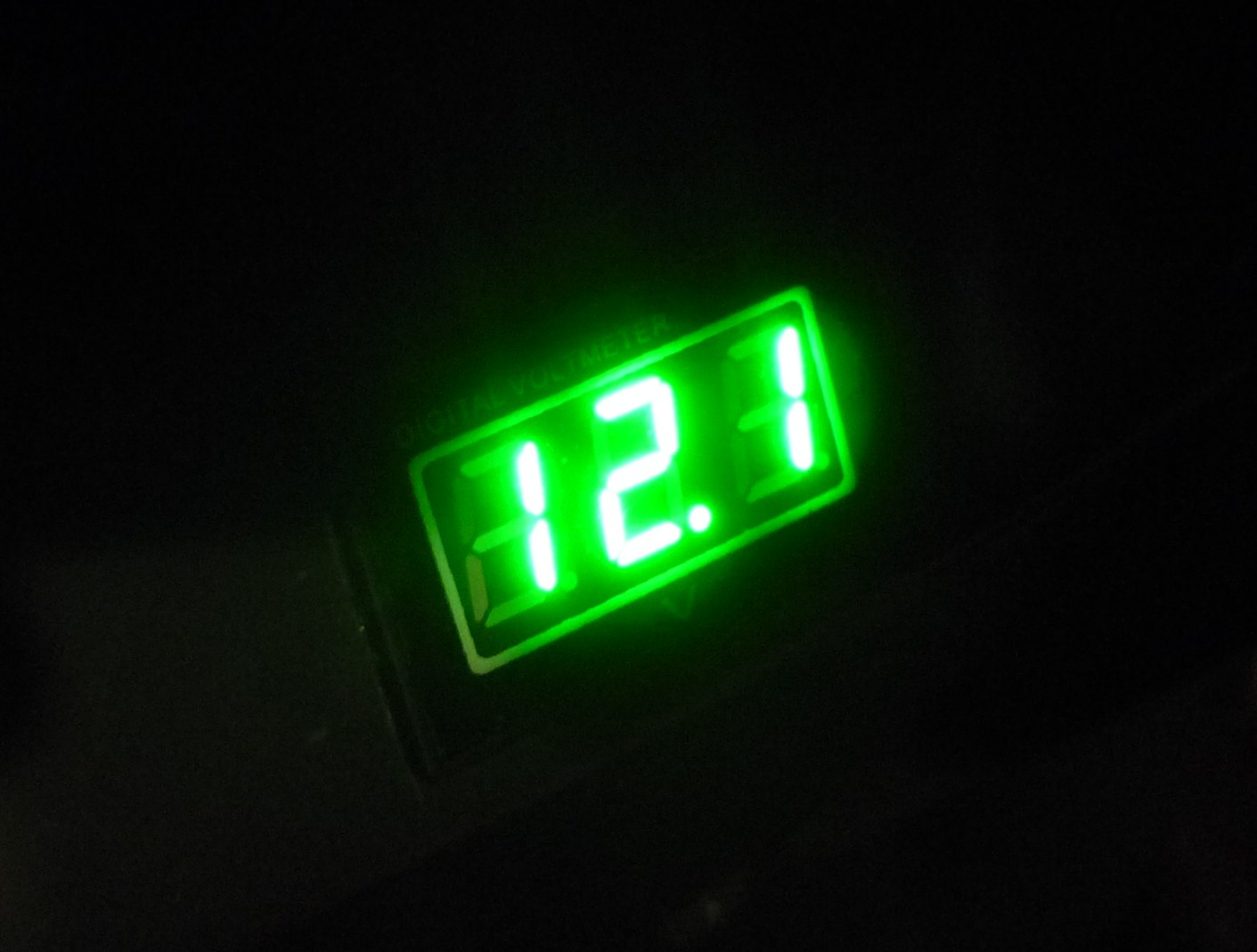

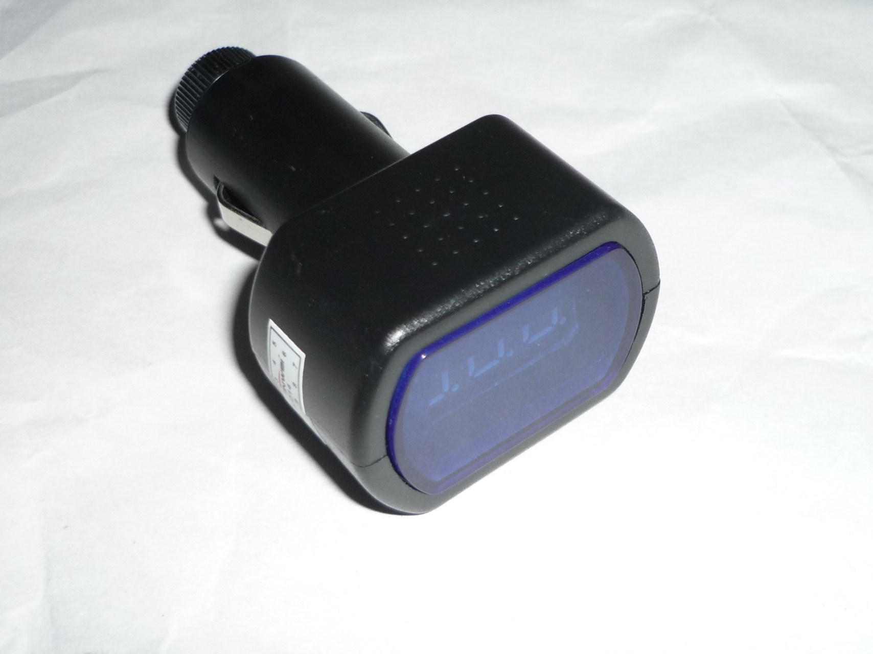

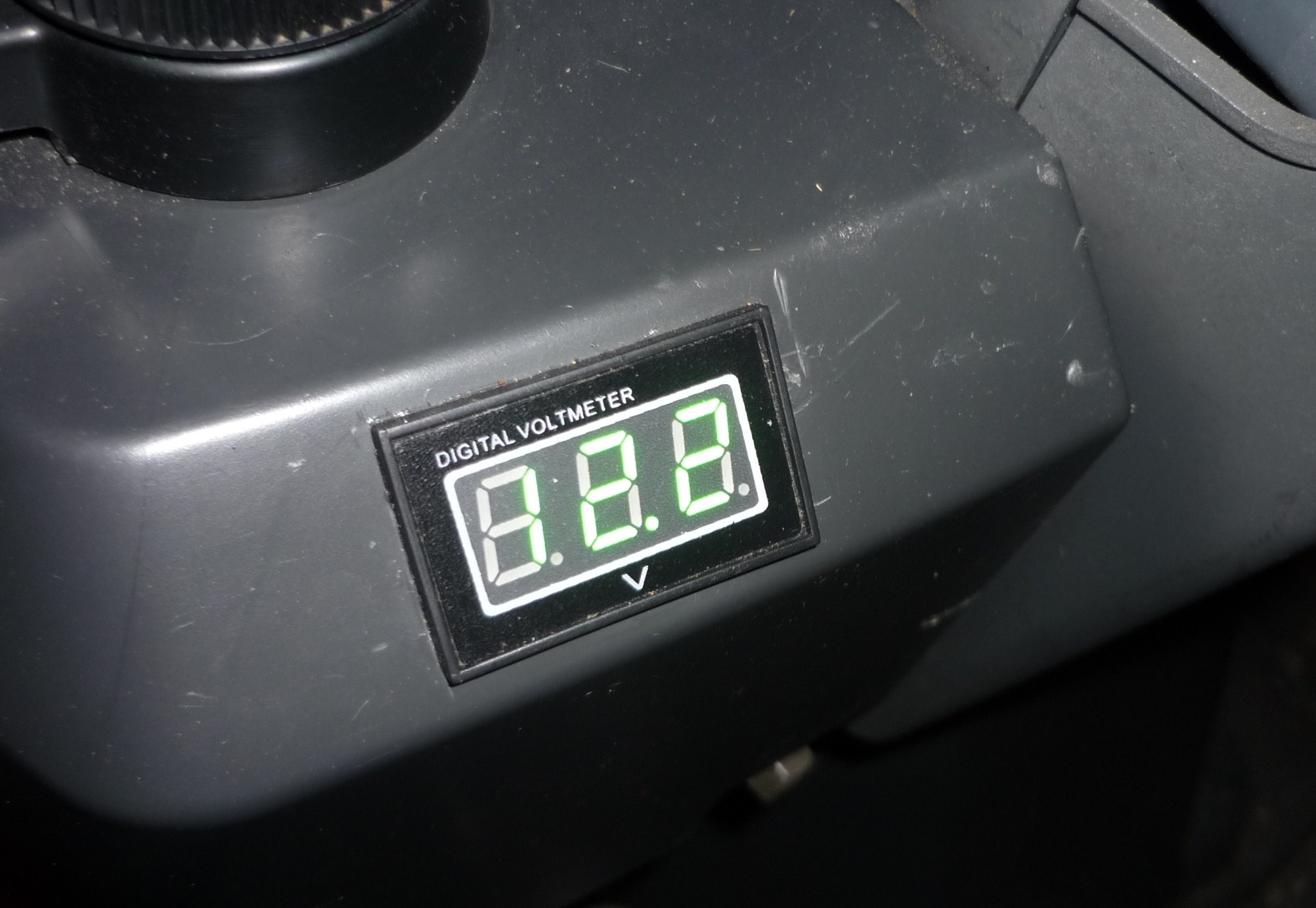

After getting my L3130, I added LED work lights, and then this little LED voltmeter (waterproof, maybe $5 from China) just to be able to see what the charging system is doing. I had real gauges on my last Kubota, and I like having more than an idiot light. And, after having alternator issues in my Subaru, I invested $3.50 in this little LED voltmeter that plugs into a lighter/convenience outlet, and lets me know just what is going on in about any vehicle. FWIW, these came from China, where I often order such things online, and so far I have great luck with all the stuff being what I wanted, and showing up.
