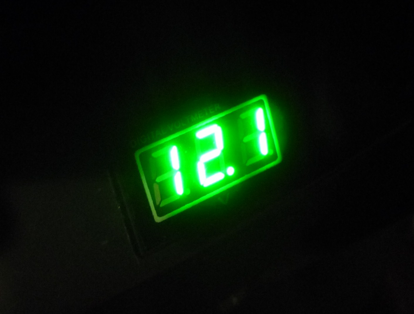

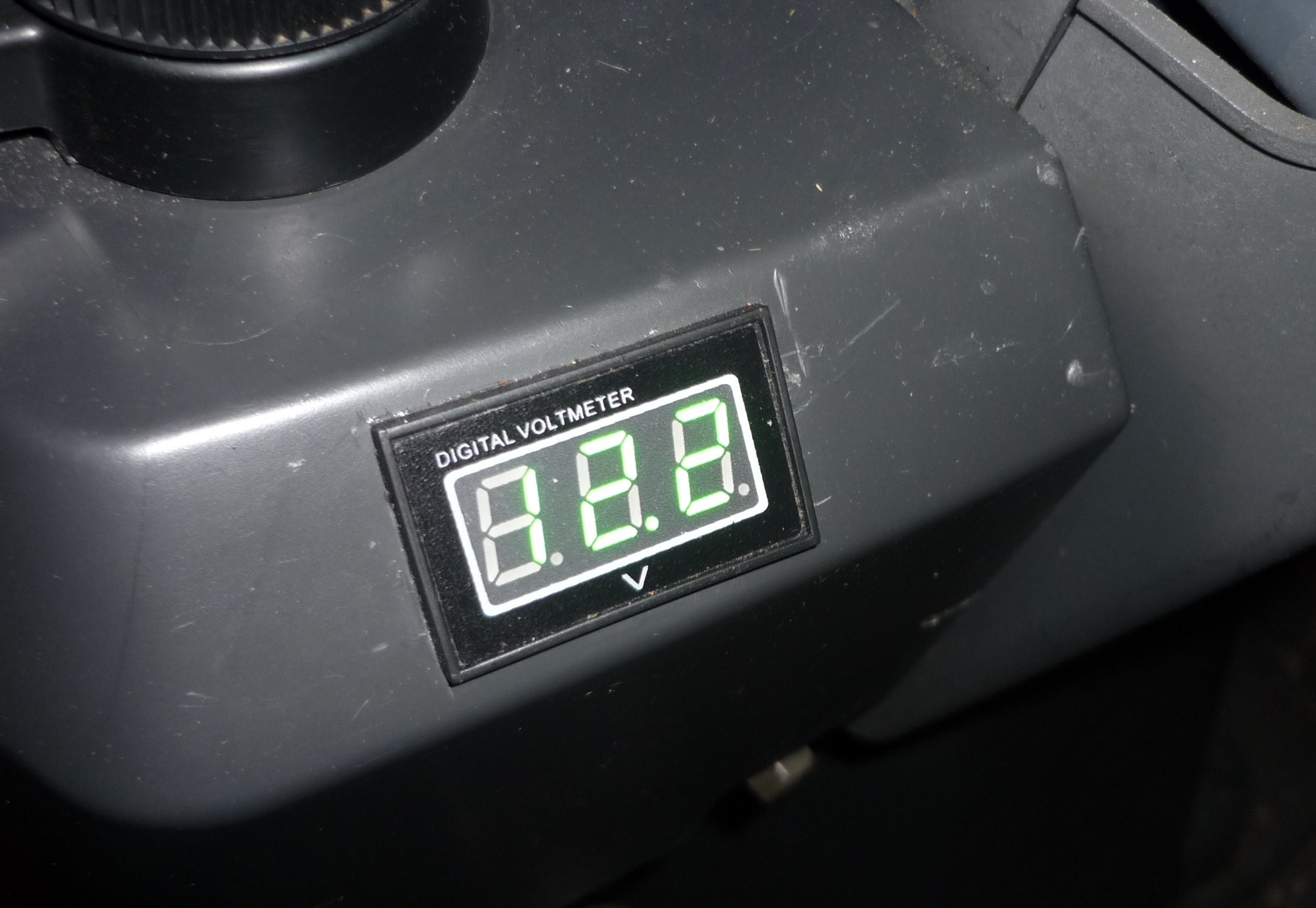

After getting my L3130, I added LED work lights, and then this little LED voltmeter (waterproof, maybe $5 from China) just to be able to see what the charging system is doing. I had real gauges on my last Kubota, and I like having more than an idiot light. And, after having alternator issues in my Subaru, I invested $3.50 in this little LED voltmeter that plugs into a lighter/convenience outlet, and lets me know just what is going on in about any vehicle. FWIW, these came from China, where I often order such things online, and so far I have great luck with all the stuff being what I wanted, and showing up.
View attachment 397669View attachment 397670View attachment 397668
Very nice. I like the way you've installed the digital meter in the dash.

I found varmint's meter on Amazon. There are others on there that are wired and not just for 12V cigarette lighter. Amazon.com : Mini LED Display Digital Car Voltmeter 12V/24V Vehicle Voltage Gauge : Automotive Electronic Security Products : Car Electronics
I don't know enough about this stuff to know how to install one of these to my tractor but it would be nice...I'll be looking into what's involved.

Guys, I will shop both eBay and Amazon... I think I found the in-dash meter thru eBay. I ordered directly from the vendor thru eBay using Pay Pal. If the vendor has an okay record, and the ones I have used always do, since that is one criteria for me, they usually do fine with delivery. It looks like mutlitple vendors will list the same device, so you takes your pick. Delivery usally takes a week or two, (maybe 3 weeks in the case of one item, but the price was so low, it was almost free) but obviously China subsidizes the mail, since shipping is often free for the buyer. I have ordered perhaps 12 items that way, and each purchase arrived in fine shape, working, no problems. If I get something that goes wrong, for the price, I will continue trusting until I have a run of trouble. Keep in mind, much of what I order this way is not readliy available locally: I have to order it from somewhere. Since it is made in China to begin with, why not order it from there?
Wiring it: a red wire goes to any (switched, of course, since you don't want the thing on 24-7) power source, almost zero drain, so the source doesn't matter, and the black wire goes to any ground. Done. If it will sit exposed, be sure to get a "waterproof" device. I used a tiny bead of silicone sealant around the meter so water couldn't get behind the plastic dash.

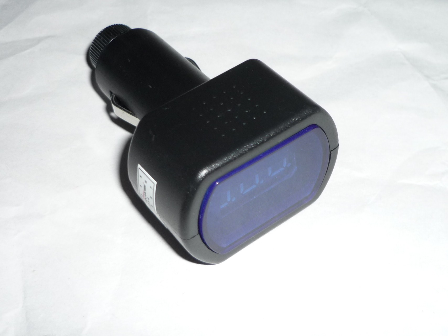

For the price, it is a worthwhile indicator of potential problems with your alternator or battery, IMHO. I got the lighter plug in meter when my car had battery issues (well, after I had battery issues...) with the idea that in the future, it would be easy to monitor such potential issues.
