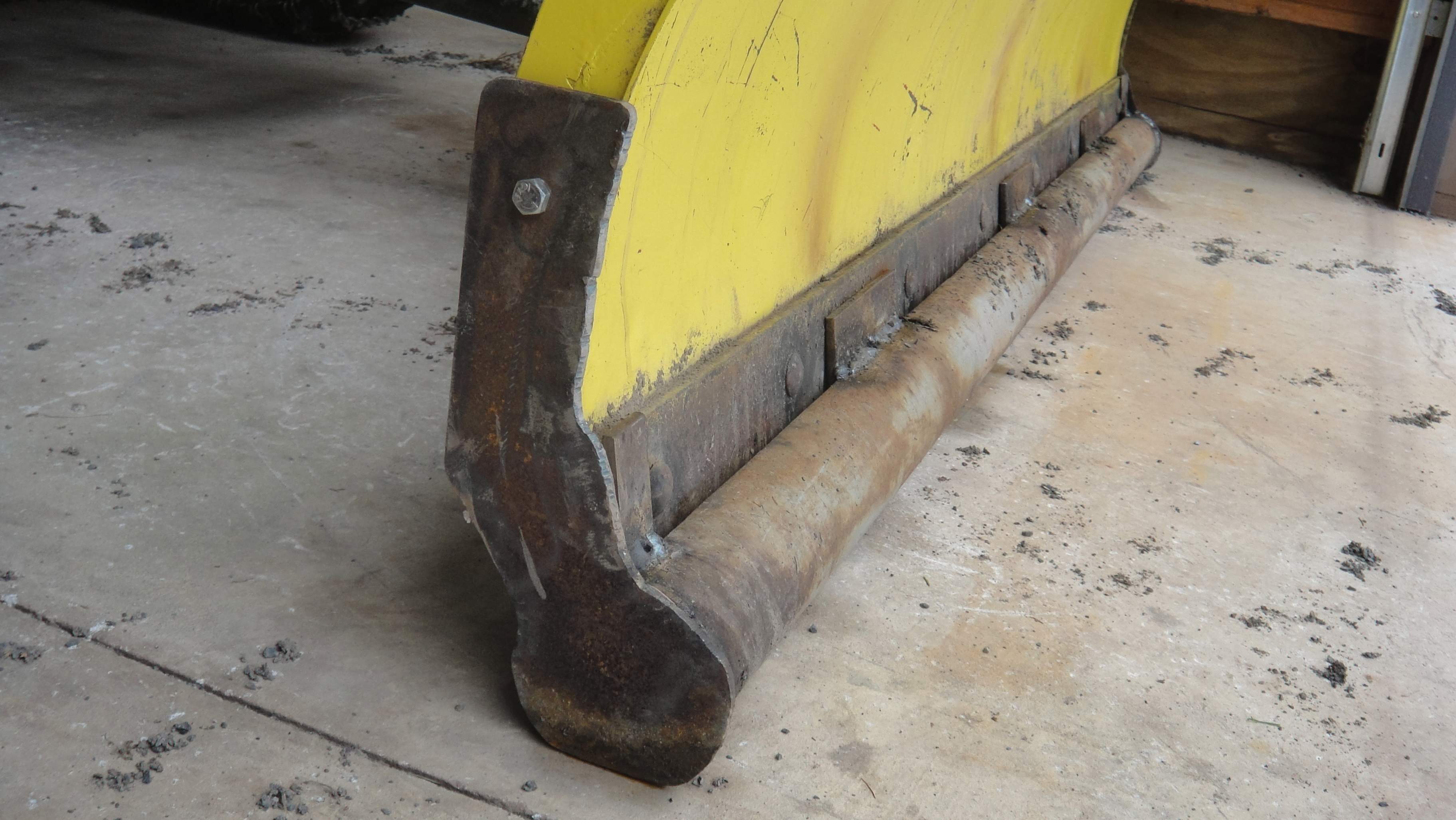

Thanks. I never heard of the "pipe trick" before. What kind of tool do you use to cut the steel pipe? I have a machine shop locally that could probably run a notch down it. I guess I could weld a couple tabs onto the pipe and drill the blade for fasteners or bolts.
I just used an abrasive wheel saw, but mine was an odd ball very thin gauge pipe.
I tried the plastic pipe but shredded it pretty quickly. The pipe definitely works at stopping the gauging

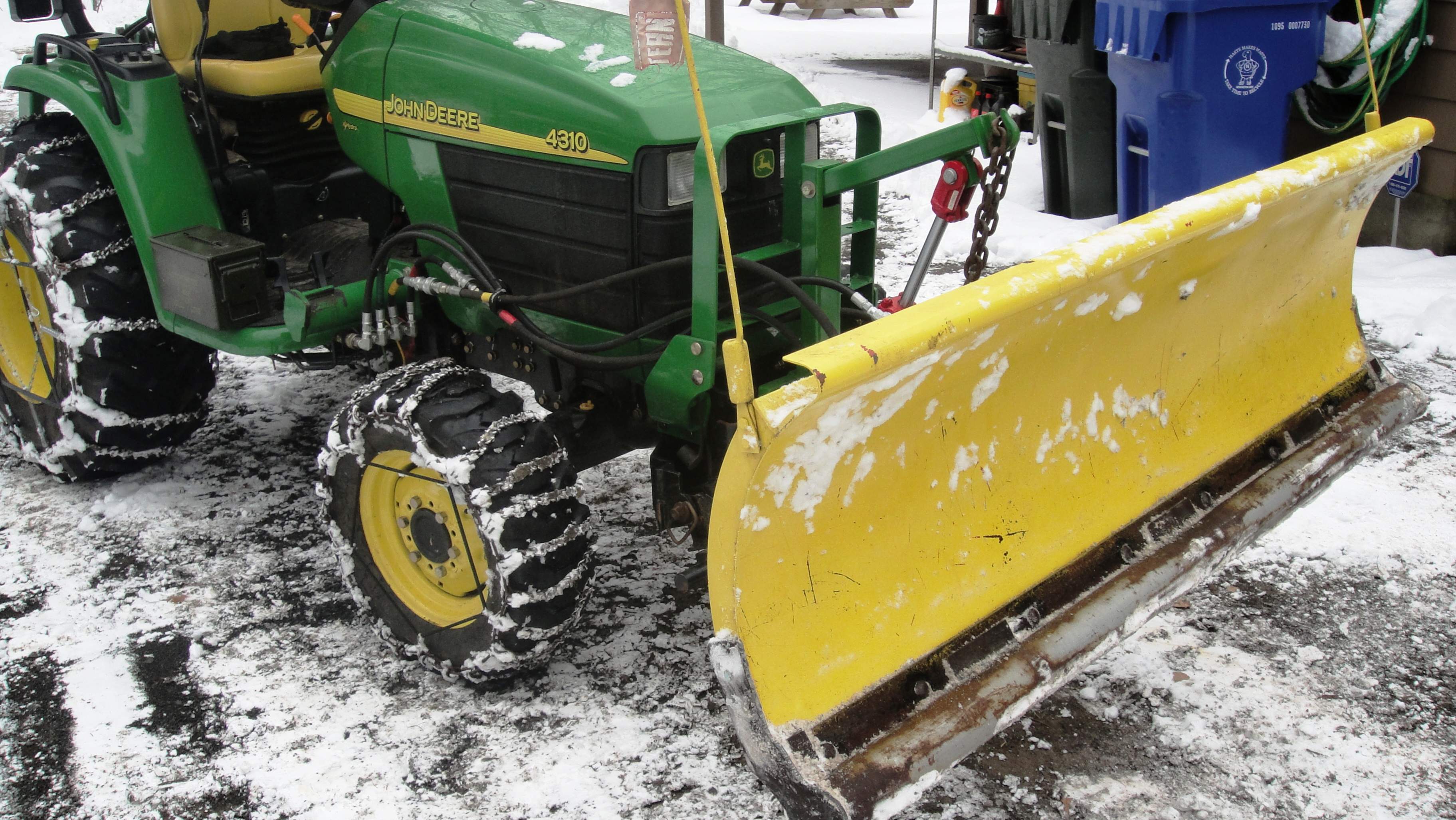

This is how I did mine. the pipe is ~2.5 - 3" The plow is 6.5'

Neat! A picture is definitely worth 1000 words. I might spring for chains on all 4 wheels on down the road too. :thumbsup:

Hi JB, def a good idea. Better than buying a replacement, cost cheaper too :thumbsup:
