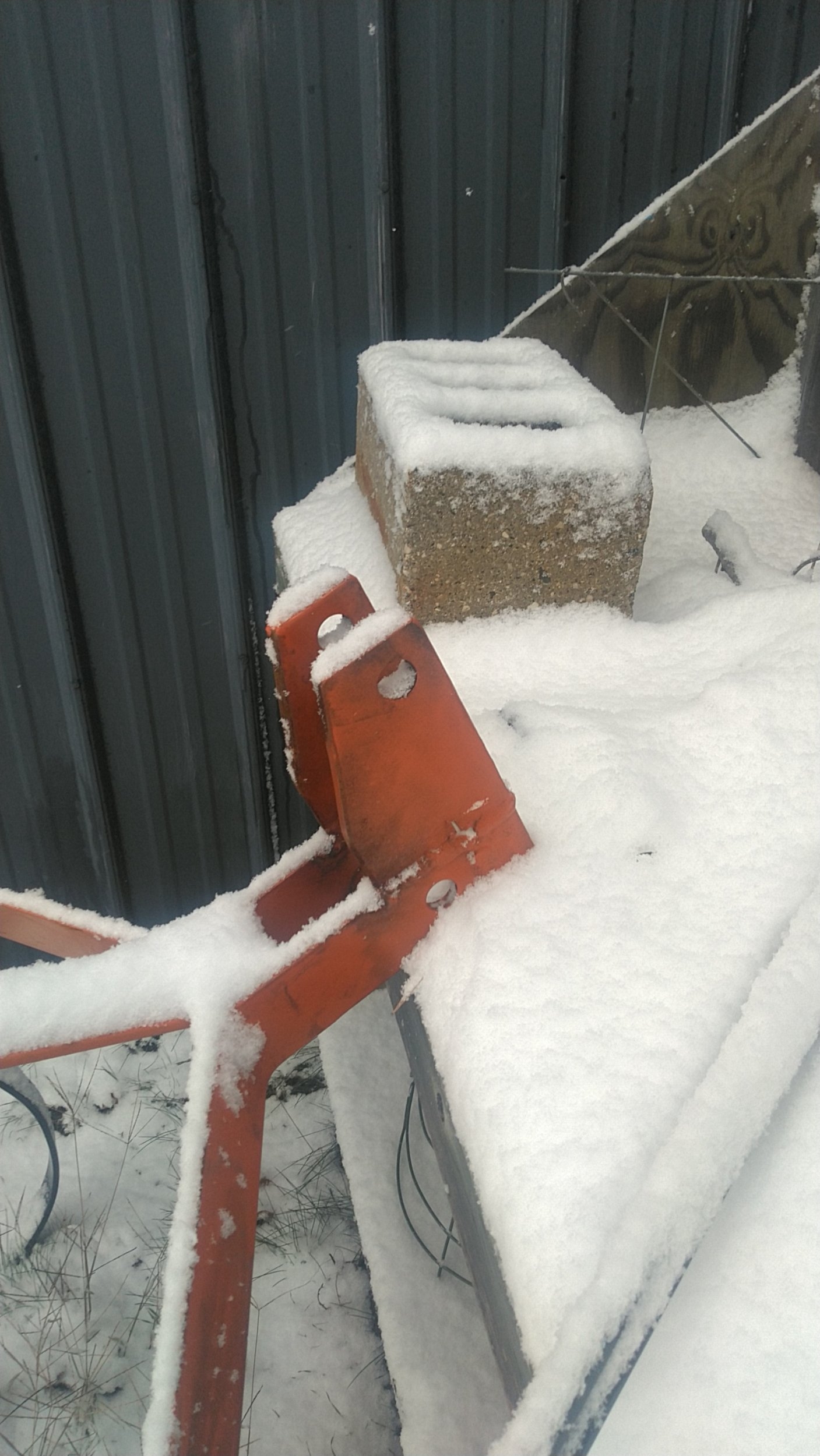

Thanks again. Unfortunately both locations where I can attach the top link to the mower are slotted on the mower. They claim they slot them for "float", but I thought a 3 point hitch was floating by nature anyway (when all the way down).
Weight of implement is only three point implement down pressure in my tractors I do use draft control when mowing and not the traditional up down tph control. On a older rotary mower I use I've had good results using my hydraulic top link tilting the deck slightly back cuz it helps prevent the sides of deck from digging in the field and the blades digging up soil.

Thank you sir. By "downward", do you mean tilted like my photo, or the opposite way?
Tilt refers the the rear of the box. 90% of the box work is done moving forward hence the box would be flat to cut or rip if equipped and tilted back to smooth

All I know is that fully retracted or extended, my HYD top link far exceeds what my implements would require. Your photo looks as if you really don’t want to sacrifice fully extended length for your flail at all. Nobody really ever uses fully retracted positions of their top link. Ive never seen it

I had to hence my crude but functional implement extension
