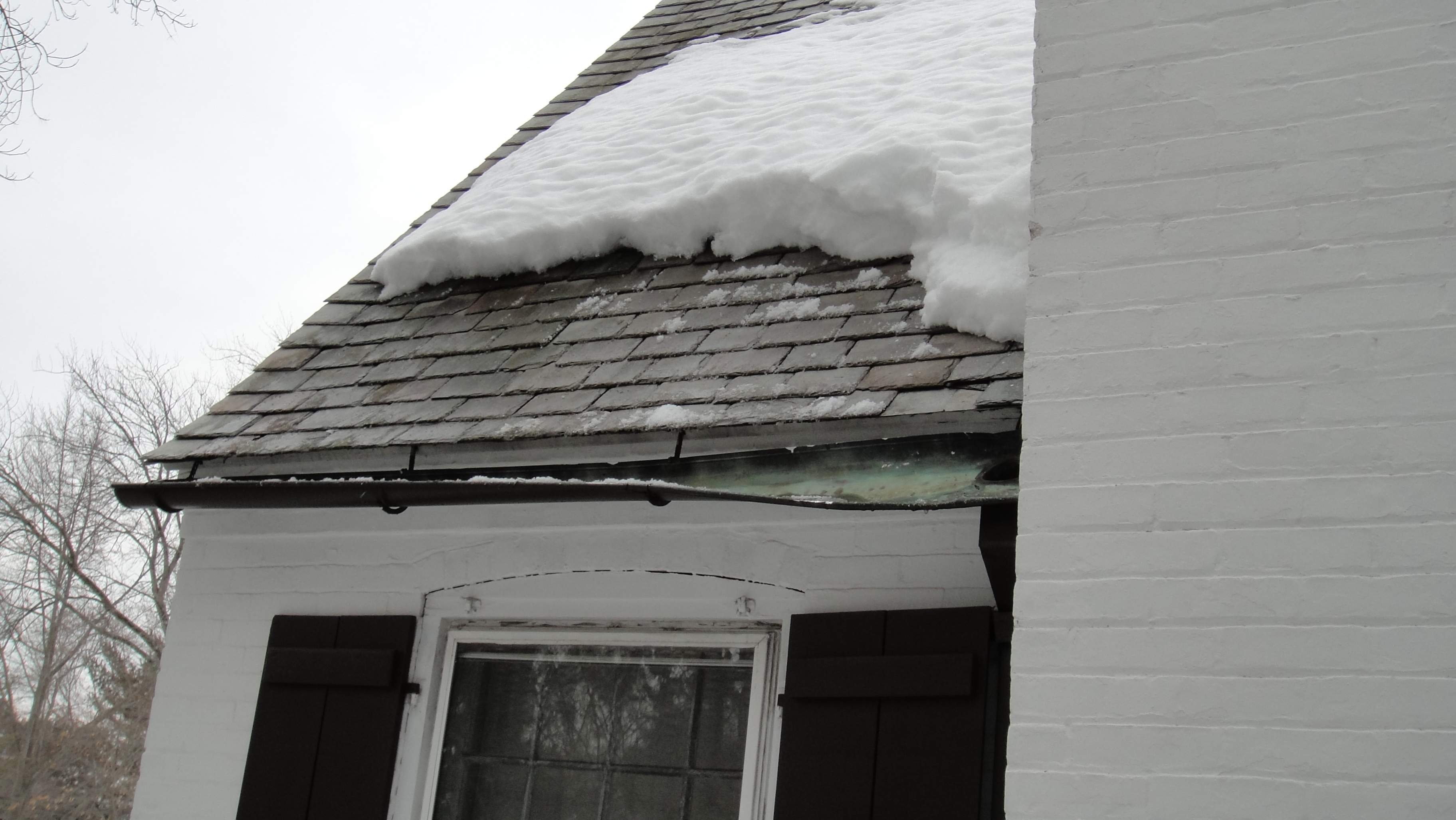

The roof is strong enough to support the weight, but I didn't want that weight sliding off on somebody's head. We usually have enough thaws that it slides off after a few inches build up, but we've had no thaw this year, just freezing rains to build up ice layers.
I'm thinking about closing and insulating the underside and shooting some heat in there so I can make it slide at time of my choosing.
If anyone has experience with those eaves heating cables, I'd like to hear about it.

I would think with the metal roof the snow would slide with a little push from behind with shovel, little at a time of course, turn the machine around and catch the falling snow so you don't have to pick it up from the ground.
I like the idea of force heating from the bottom.
As far as the melting cables go, I'm on alot of roofs and when ever I see them they are usually a mess and not working, about 95% of the time.
So I would normaly say forget about them, but this year has forced me to rethink things and am seriously gonna look at installing on my own house. I've had repeated ice dams even after removing fresh snow.
So I would normaly say forget about them, but this year has forced me to rethink things and am seriously gonna look at installing on my own house. I've had repeated ice dams even after removing fresh snow.JB.
It's not that easy. If you get a little rain or wet snow on the roof, it freezes on and as you can see, just keeps accumulating until a warm spell. This is doubly bad because the dormer behind the porch is steeper pitch so unloads quicker than the lower one. As far as getting behind and pushing, no way and when it decides to come, it's all at once so you'd end up on top of the pile.
I was wondering about mounting the cables on the underside of the roof and insulating them in. The problem is that the roof has 1" boards and a layer of shingles on them and hose cables aren't cheap to try something you're not sure will work.
Also thought about carefully placing an electric heater or infra red bulbs up there and temporarily insulating it in and watch it closely when I tried it, but don't know if the bulbs could ignite the boards or not. Lastly have thought about removing about 3 sheets over the walkway and put the cables directly on the old roof between the purlins. Got to study it out more.
