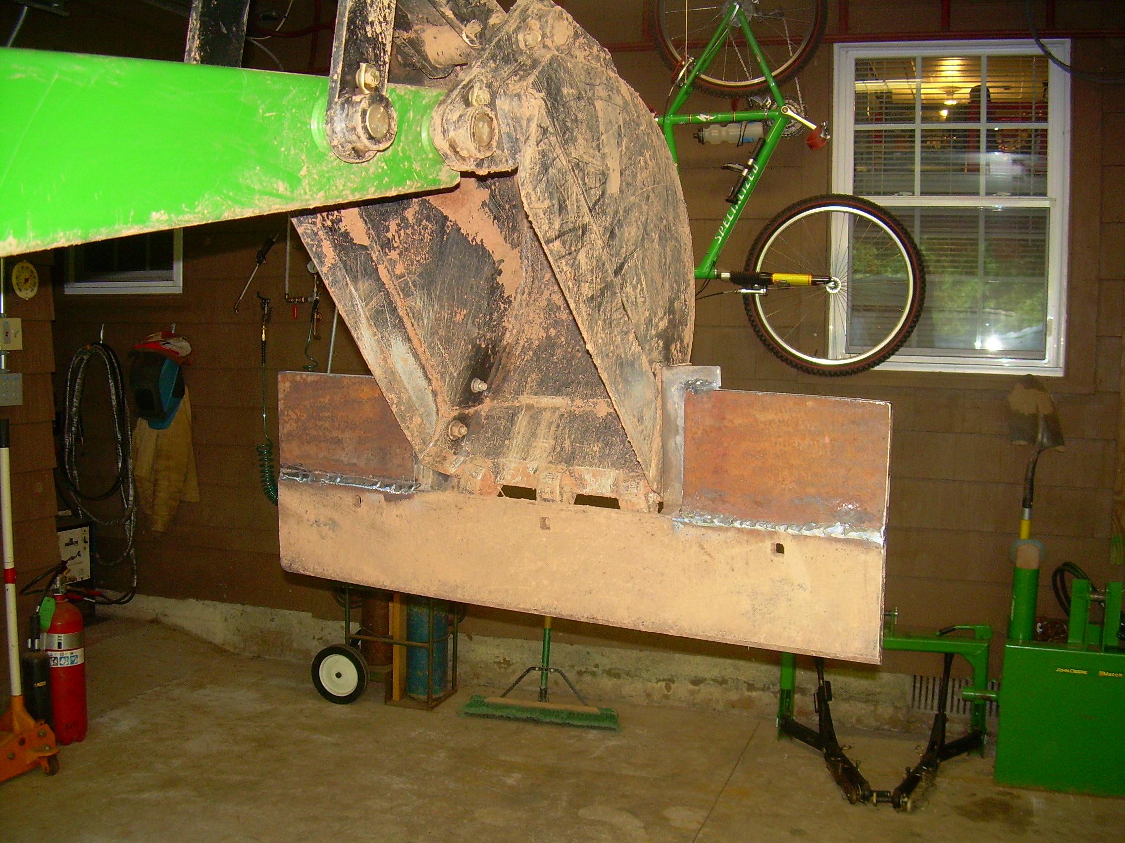

If I thought this would be a regular thing, I'd fasten some conveyor belt to a 6 ft 2x4 and U bolt it to the teeth. I have grader blade set up like that for landscaping.
Something like in the pic attached below?
JB.
Nope. Yours is a lot fancier than mine. I Don't use it much and it's just a grader cutting edge about 6 ft long x 8" wide, with holes blown through it for u bolts to go around the teeth, but it did what I needed for trimming some slopes and ditches. For the swale type ditches, I had the son drive slowly down the drive while I reached over the backside first then the front and did it just like a grader. Worked pretty good, would have been better if I could have tilted it like a Gradal.
