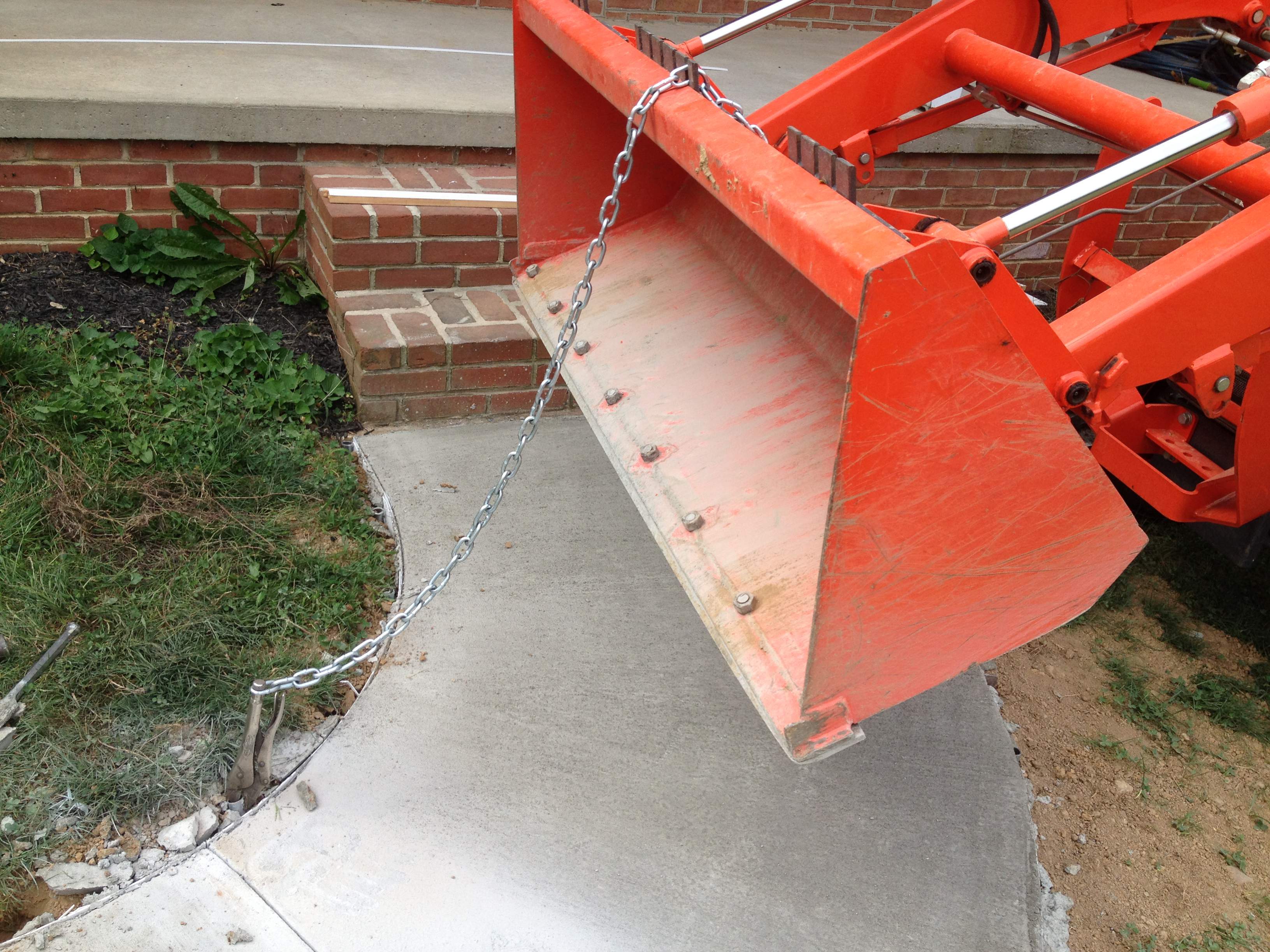

Poured a sidewalk on Friday. The forms were mostly thin plywood strips. I staked it with (many) pieces of 3/4" EMT and then used self-drilling screws from the inside of the forms. Figured the easiest way to strip them would be to smack the conduit so the screws would break loose and pull the conduit out with a big pump pliers.
It all worked out fine until the pulling part. I didn't have near enough strength to pull most of them. Next attempt was using an old Visegrip pliers. I removed the adjustment bolt and ran it through the last link of a piece of chain. Then I used the FEL to pull the pegs. MUCH better!

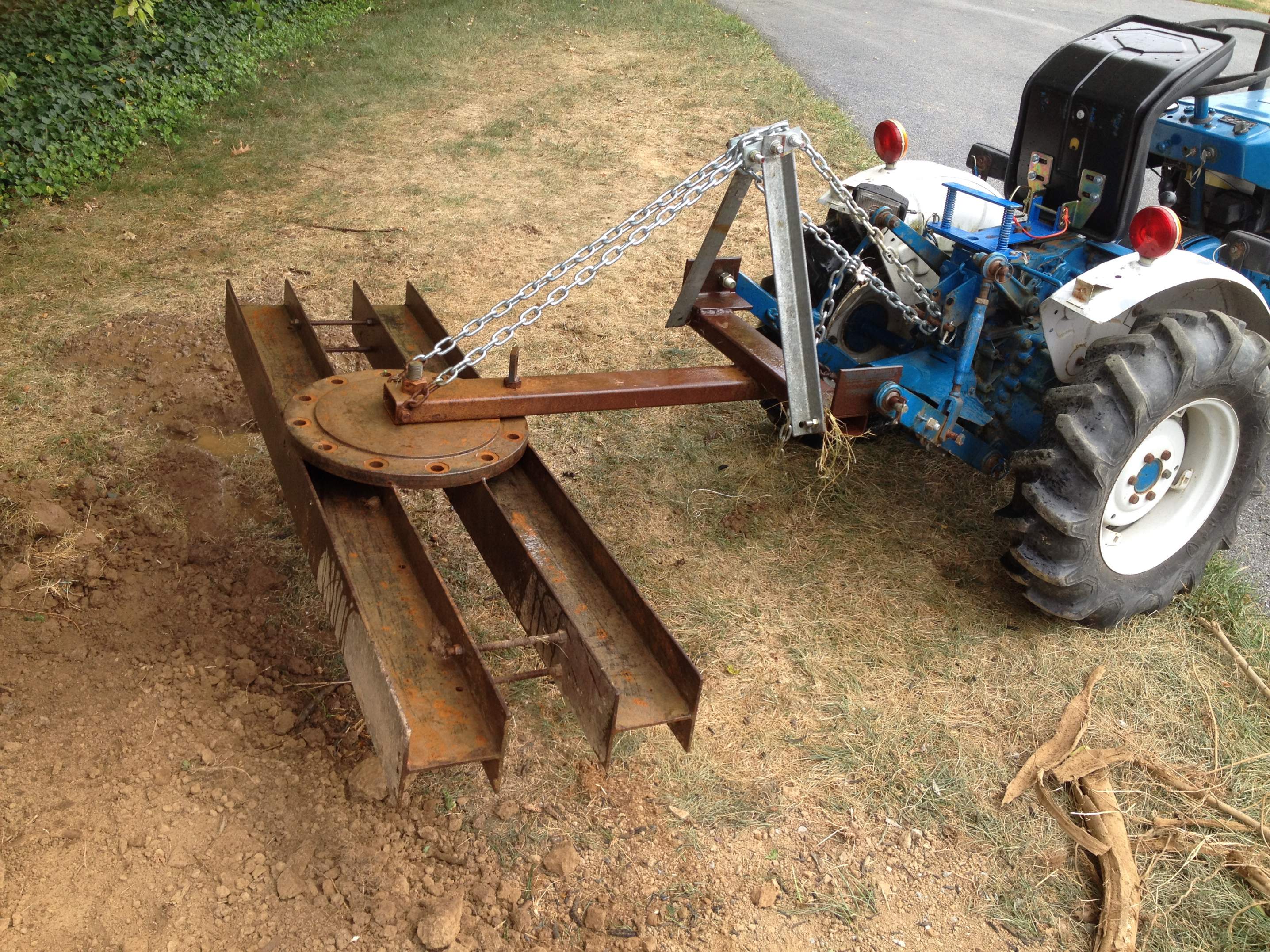

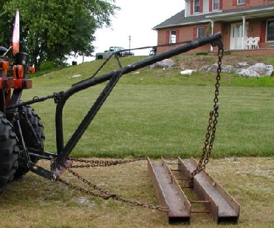

I dug this out for grading some of the fill along the sidewalk. The fill ranged from at least a foot down to nothing at the other end. It is a large pipe flange welded to a couple pieces of beam. It originally was a simple drag that I'd use with a lift boom and drag with chains. Last year I added the flange for weight and there's a pin in the front that allows me to rotate and lock it.
Here are pics that show the original on a B7500 (and I can't figure out why it's a link instead of a thumbnail), and the current configuration on a Ford 1210:

That setup on the Ford, looks pretty darn useful. And the setup on the B7500, sure is a unique way to have a chain drag, and be able to lift it too!:thumbsup: I would never have thought of that...cool.

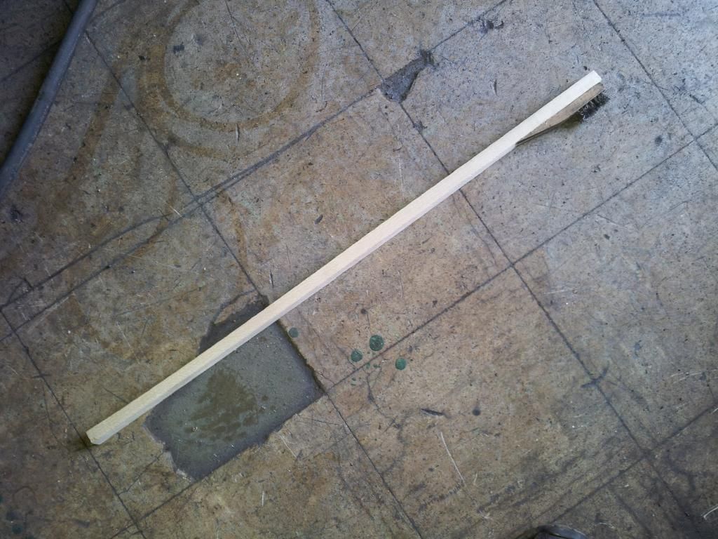

I made a really long handle mini-wire brush... thoes are 9" tiles, its about 24" long. Used it to knock off paint inside some truck cab door jambs where heat from welding floor panels in had made it peel. Another stick with a sponge stapled to it became a paint brush to re-coat the bare metal.

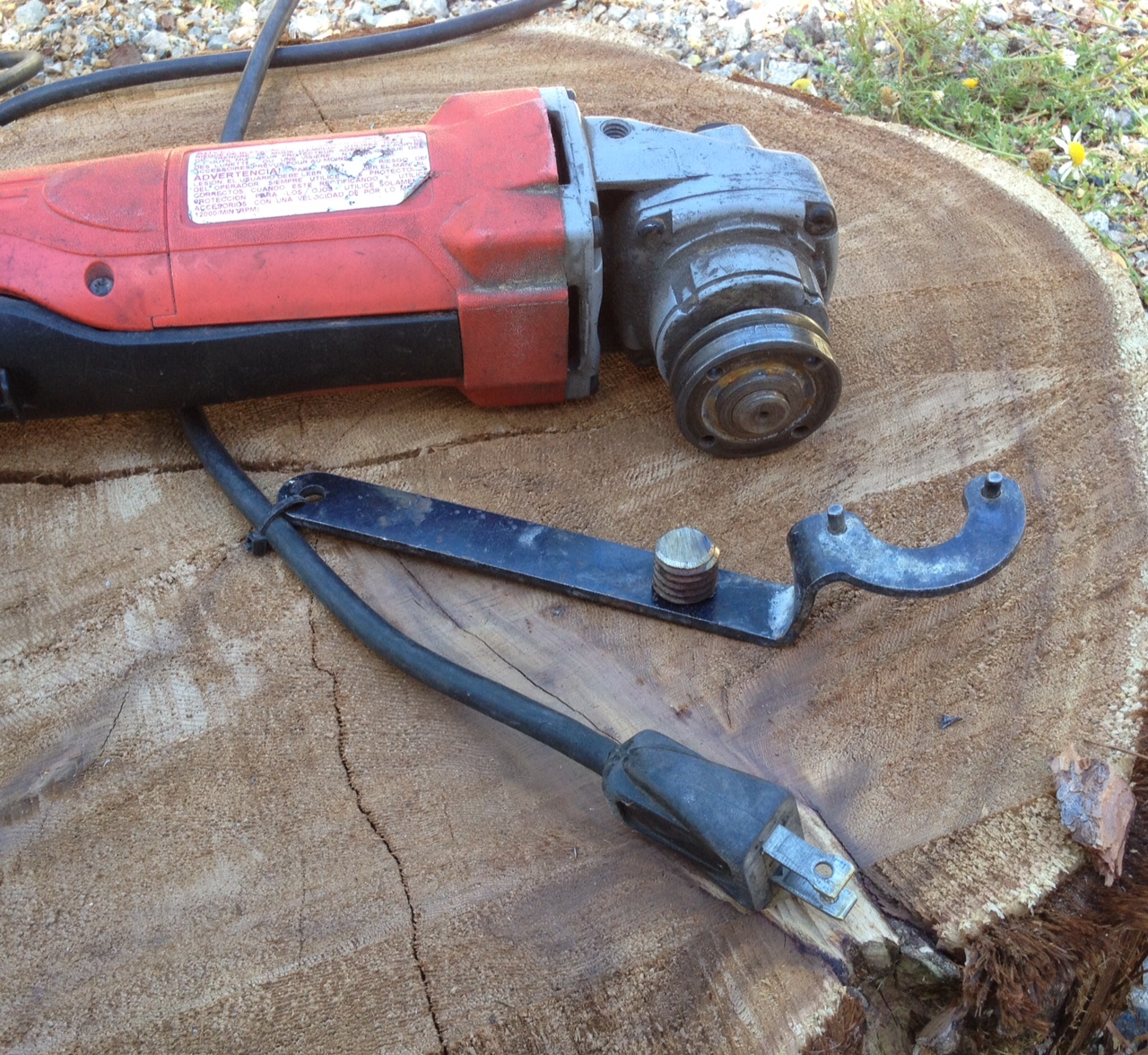

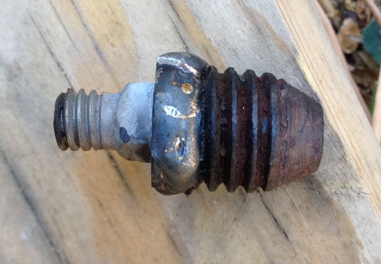

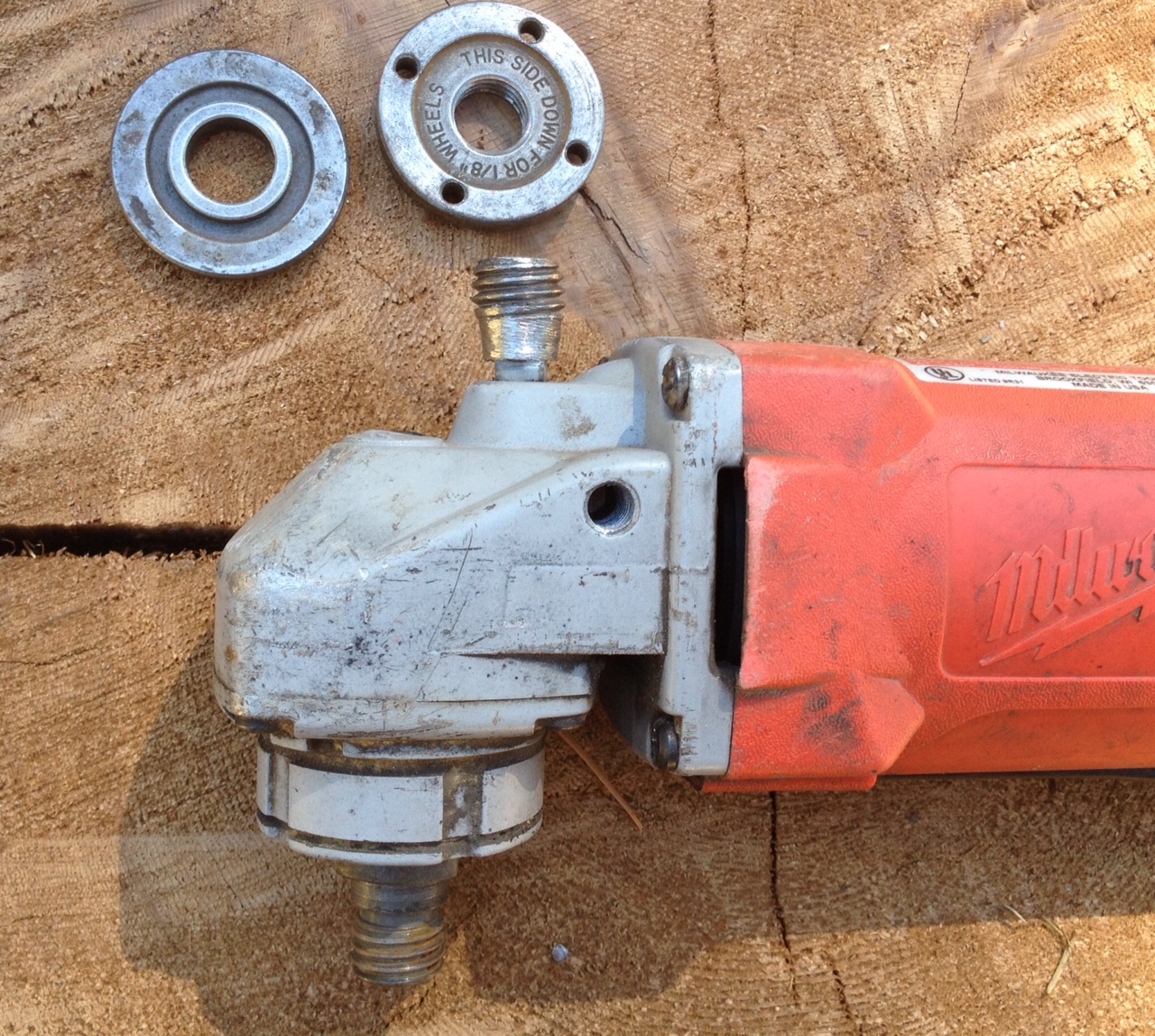

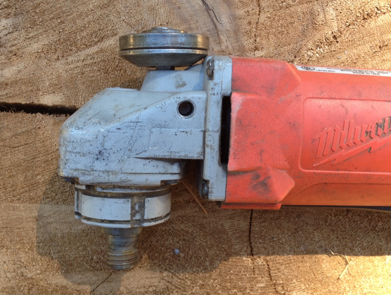

Welded threads together to make a 'holder stud' for the fittings on the angle grinder. It screws into the hole for the handle. I never use the handle on the 4 1/2" grinder. This is a Milwaukie, thds are 5/16-18, and 5/8-11.
DeWalt uses M8-1.25 and 5/8-11
Here's another good place to weld a holder.

Using the pipe flange is brilliant! Nice, heavy ( and easy) way to make a locking pivot......great idea!!
