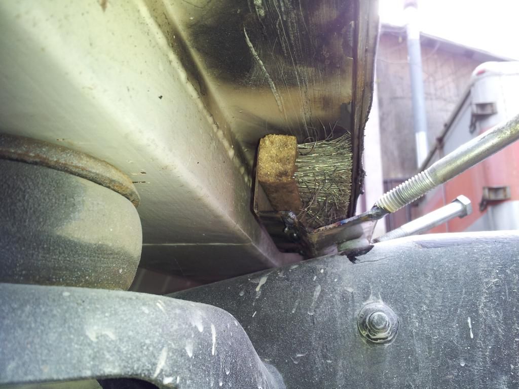

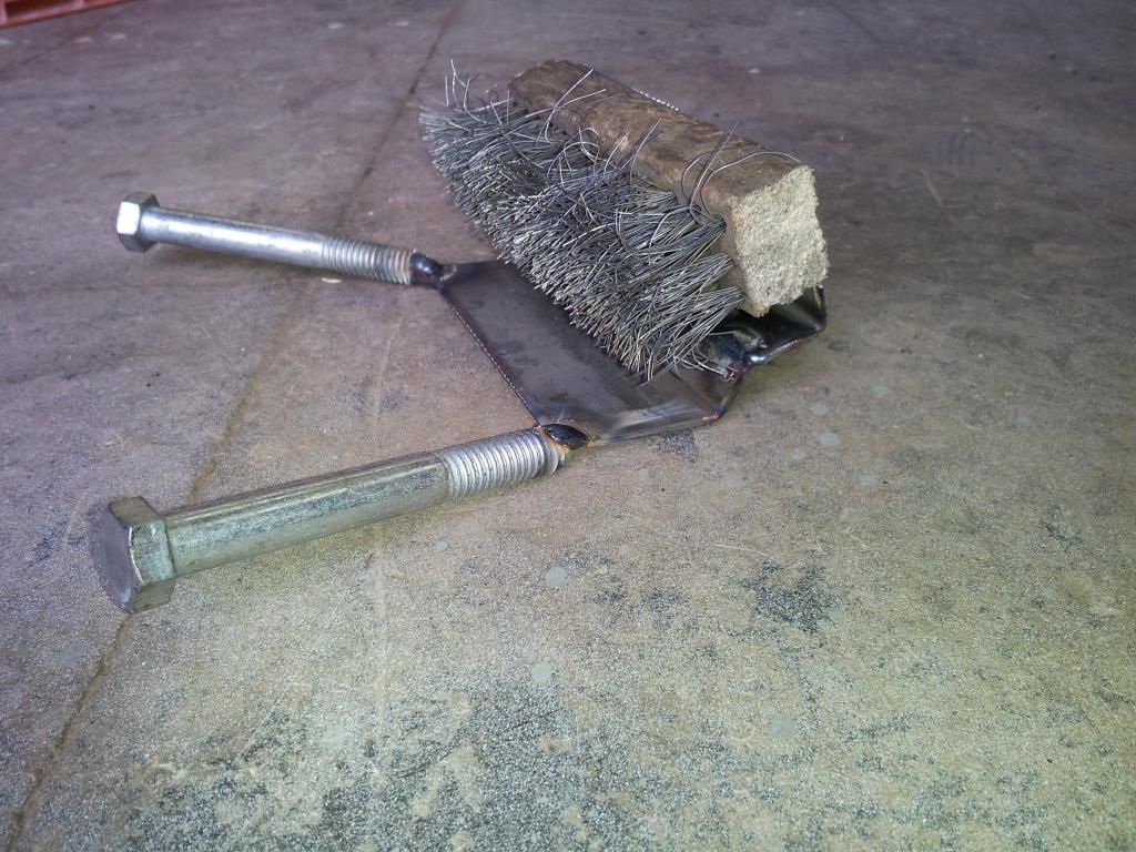

I made a wire brush holder the other day. I've been repairing a truck at work, and had a channel along the back of the cab at the bottom where the floor pan meets back wall. I had done some welding that peeled the paint and no way to get in there with my hands or standard wire brush. So I cut a 4" section of bristles, and screwed it to the holder/handle I made.
Here's how it fits in the spot it was made for... worked perfectly! No busted knuckles or skinned up fingers, made the job take less than 5 minutes.
Got 'er Done ! :thumbsup:
Change the angle a bit and you've got the World's Toughest BackScratcher !
