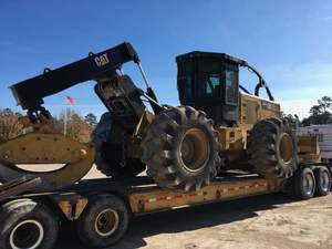

Well, yeah. On steep slopes I understand that. But the photo in post #498 does not look steep and looks wide enough to use a grapple. Unless this is just a wide spot in a trail.

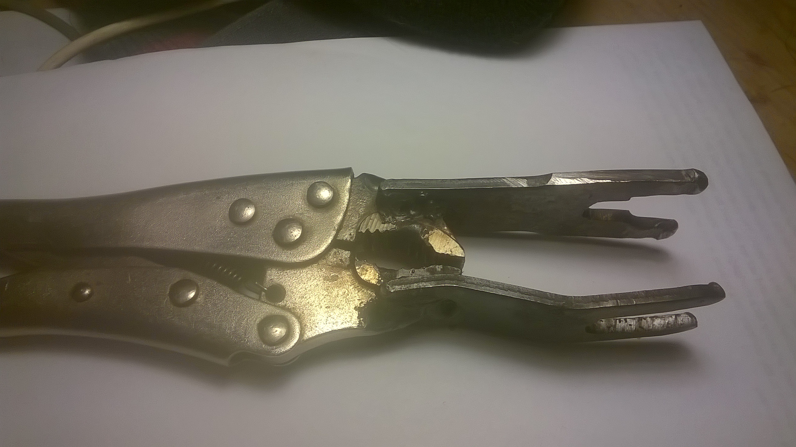

I made this valve spring compressor because I needed to adjust valves on my Kawasaki lawn mower engine. They were the kind of valves you need to remove and grind the ends off to set the clearances. I wanted to do the job and not wait for one mailorder or going to buy one somewhere. It's a little crude but worked.

Got it Done :thumbsup:
Didn't realize those K engines don't have tappets.

I bet that works real good.
