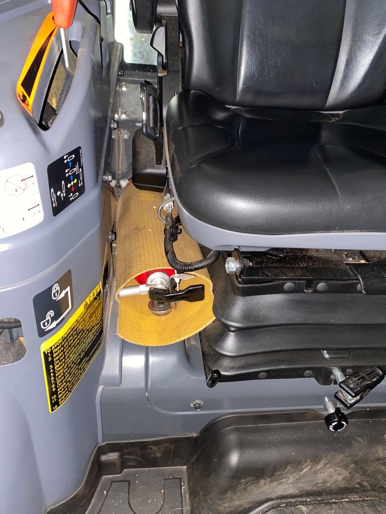

I store mine in an old section of 5" fire hose beside my seat.
If I had the space, I would prefer a 2 1/2 gallon water can though. I have put out quite a few fires with a can in my previous life.

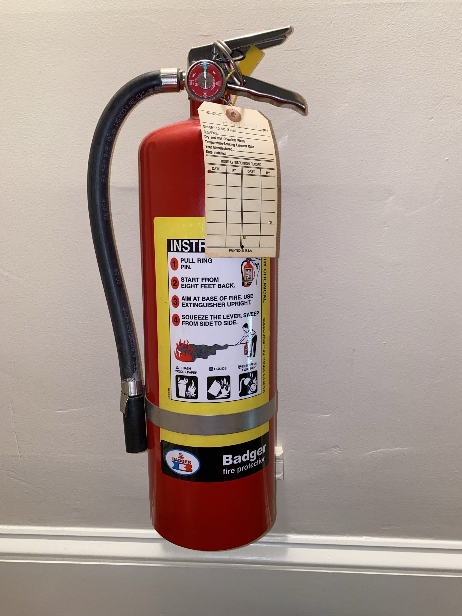

Here's another one... how often do you guys have them inspected and tested? Coming from three generations of fire fighters and fire inspectors, I bought a half dozen good (not Kidde crap) fire extinguishers from the local company that supplies all of our fire co's, and added them to the few I had already inherited... all in 1998. They are still showing exactly the same charge they started with, or very nearly so, on their gauges. Assuming the gauges still work, that is.
Not a great practice, but since it's now more than an hour round trip to where they're serviced, and I'd not want to be without more than one or two of them at a time, I haven't found a great solution for getting them tested and serviced.
Oh, and the few I inherited? There's two Halon's in that group! I also have the same water extinguisher Hay Dude carries on his tractor, I use it while welding. Do be sure to check the charge on those frequently, as mineral deposits can cause slow leaks on those.
Well for dry chemical extinguishers, the technical answer to your question is,
Fire extinguishers are supposed to be visually checked every month, for things like damage, leaks, drops in pressure, etc. You are supposed to initial on the annual tag that it has been done in the box for each month (on the back side of the tag).
They are supposed to be thoroughly checked annually, including weighing, and tagged as such with a new annual tag, again checking for things like damage, missing pins, leaks or tears in the discharge hose (if it has one), or any damage to the mechanical release.
Every 6 years they need serviced. That means taken apart (the gauge and release valve are taken off), cleaned inside and out, the agent inside the bottle can be saved and reused when the extinguisher is reassembled and pressurized. A new valve, pressure gauge and nozzle are installed. There is a 6 Year Serviced sticker that goes on the bottle to indicate it has been done. Also, usually a plastic or neoprene collar is put on before the valve is reinstalled. It has to be a collar that fits tight enough that it cannot be put on or taken off while the valve is on the bottle (this is to "prove" the service has been done, you can't get the collar on without taking the valve off). If the collar is missing, then it is counted as "not serviced".
Every 12 years they need "hydro testing". This is the same as the 6 year service above, except the agent is not saved and put back in, it is discarded and new agent is used during reassembly. The bottle is pressure tested (thus the "hydro") and certified that it passed hydro. A new sticker is placed on the bottle with the date that hydro was done, and indicates that it passed.
After each 6 year and 12 year service, the clock (calendar) resets and you start all over again.
I never did do any water extinguishers, but they do run on a different service and hydro schedule (it is less often, but I don't recall the time frequency since we didn't do them) than the dry chemical extinguishers.

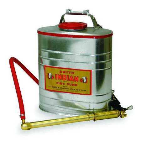

Nice thing about the water extinguishers is they are so easy to refill and put back to use.
I have found many other uses for them, including washing windshields and back/side windows when no water is available. They don’t use all their water pressure up in one use. You can use it for 10-20 seconds and still have some water left.
Despite their size, I highly suggest getting one on your tractor. Very handy for brush/field fires and other uses.
I had an Indian Pump mounted on one of my tractors long ago.

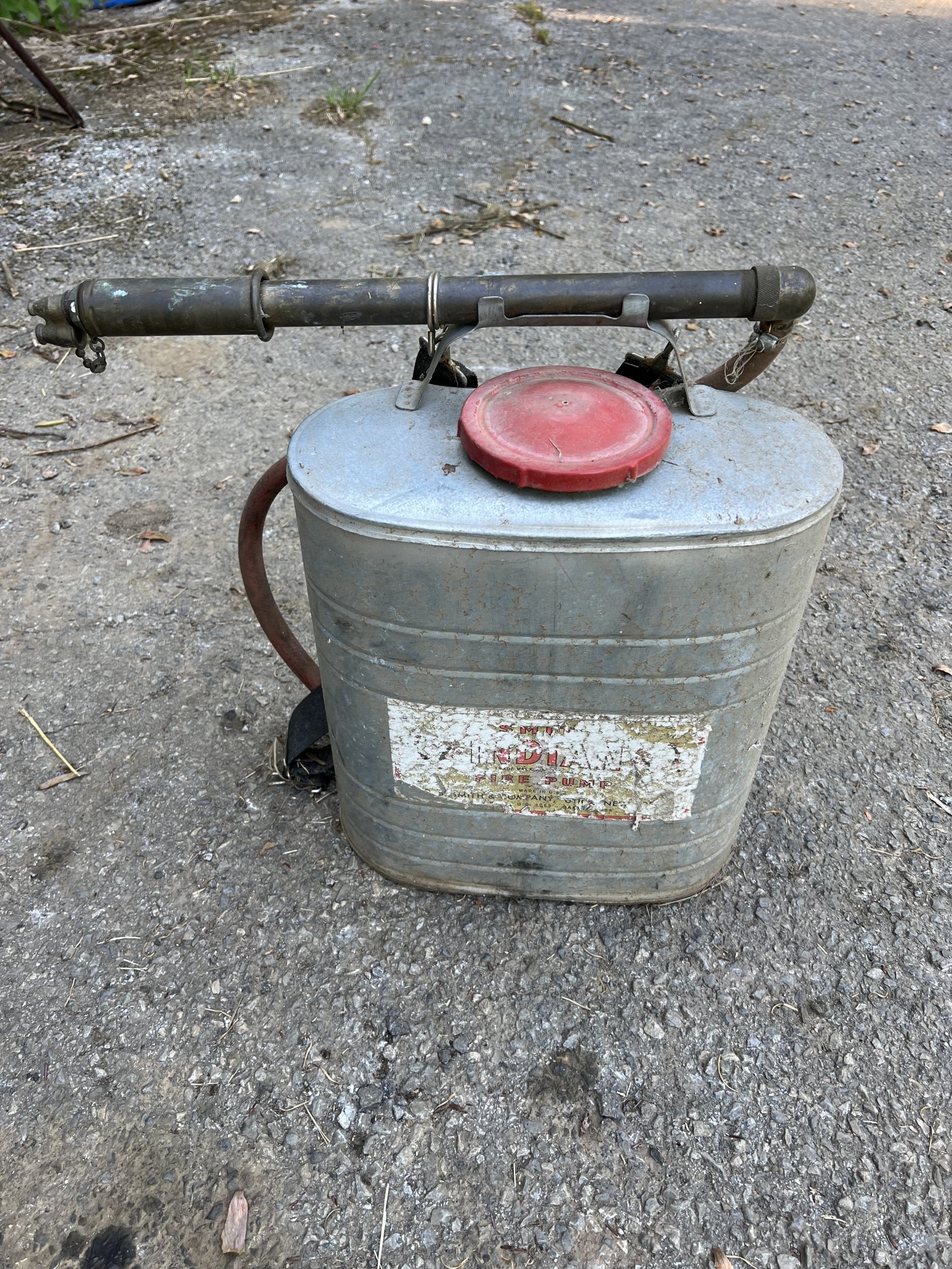

I picking an Indian pump up a few years ago; sadly it needs all new seals.

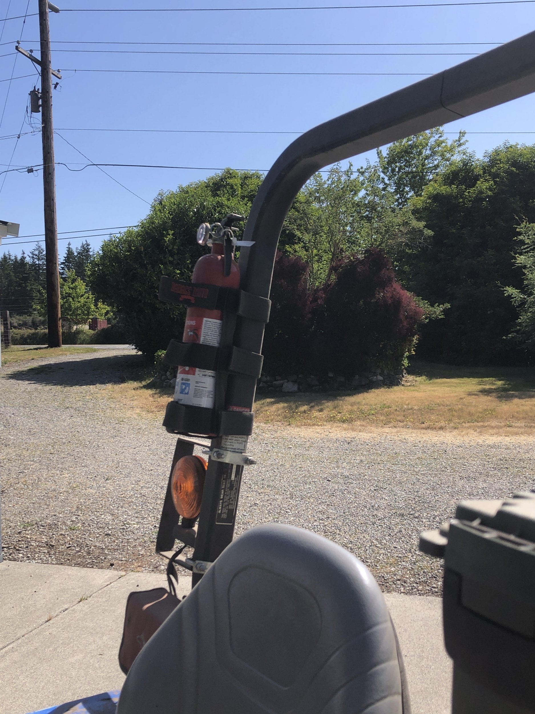

In light of the thread showing the poor tractor burned to the ground recently... I added a fire extinguisher to mine.
I got the ABC fire extinguisher and the velcro mount on Amazon
I like that set up, can you post the links where you got it? Im not finding it on Amazon
