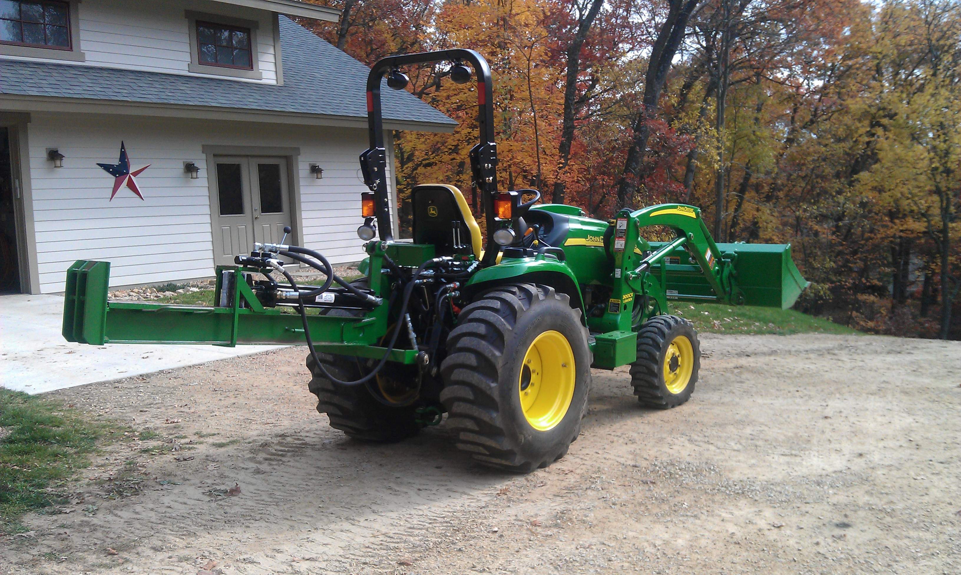

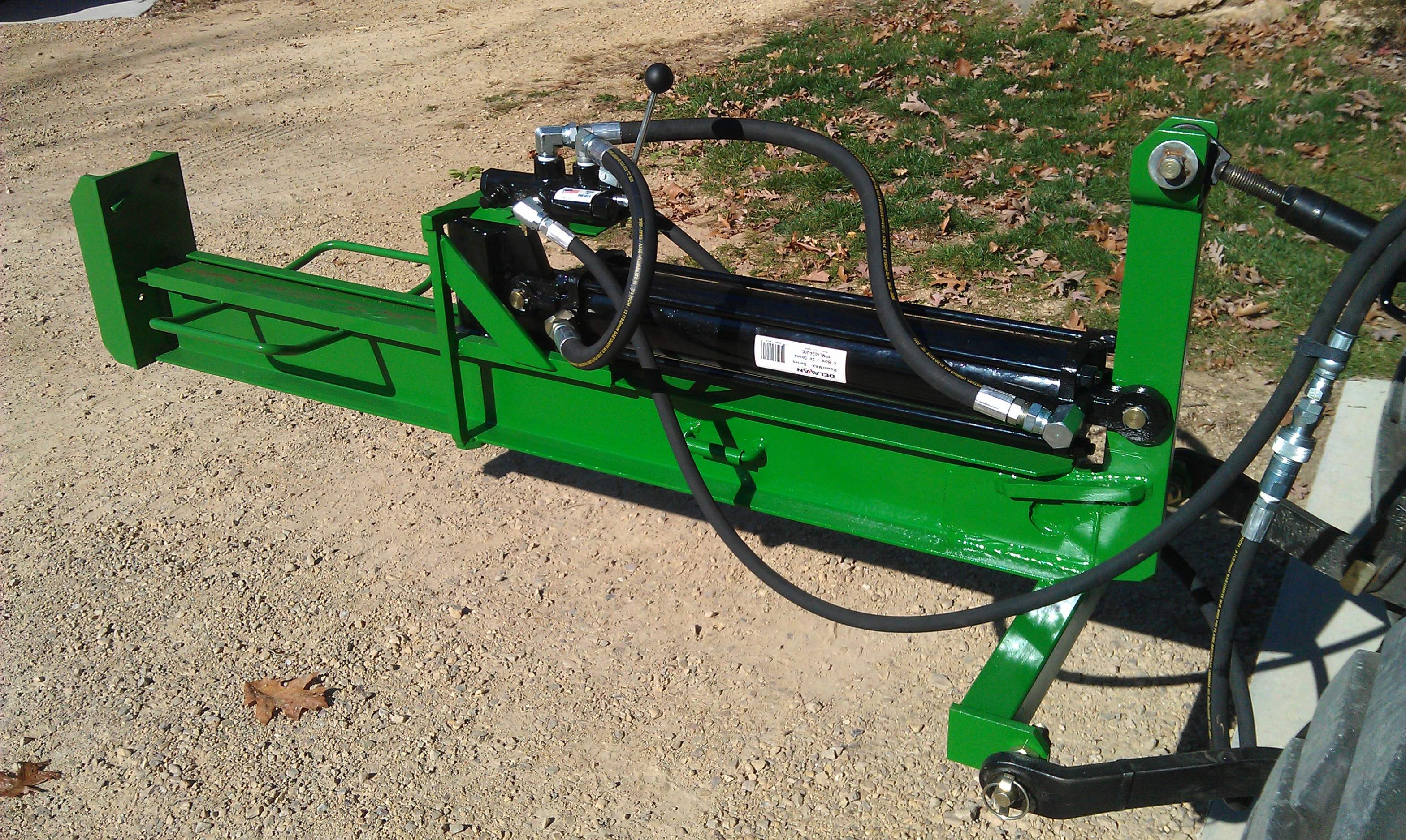

Here is mine. It has the Prince LSR 3060 with rapid extend.
