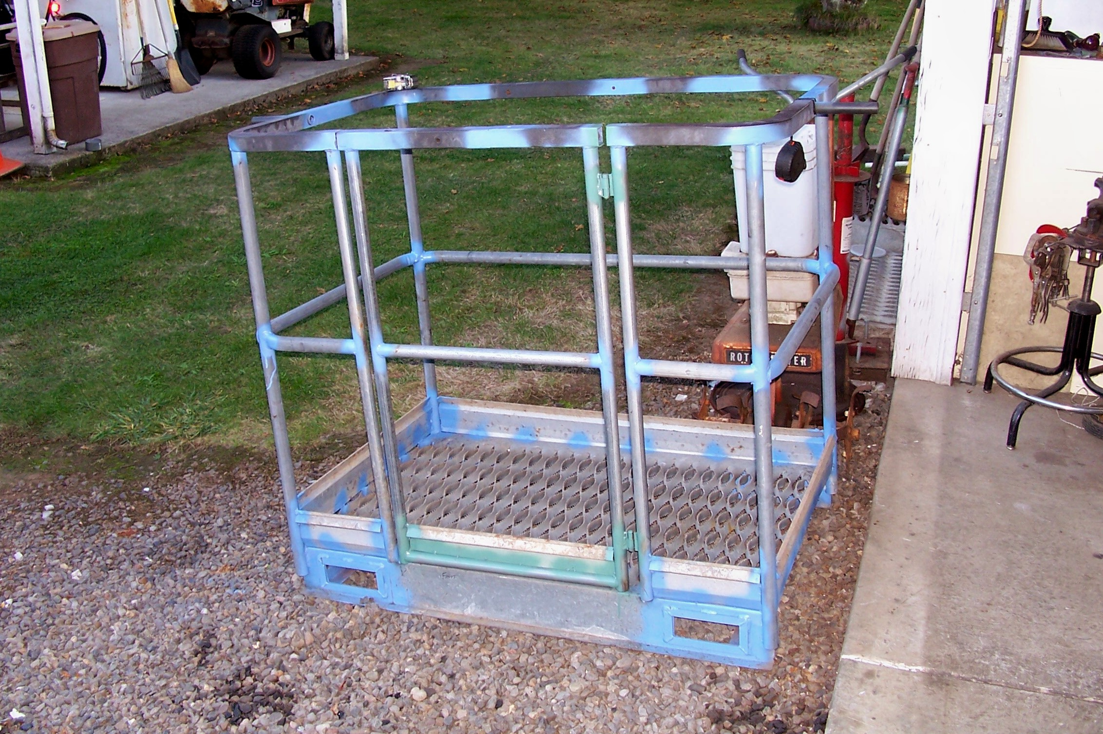

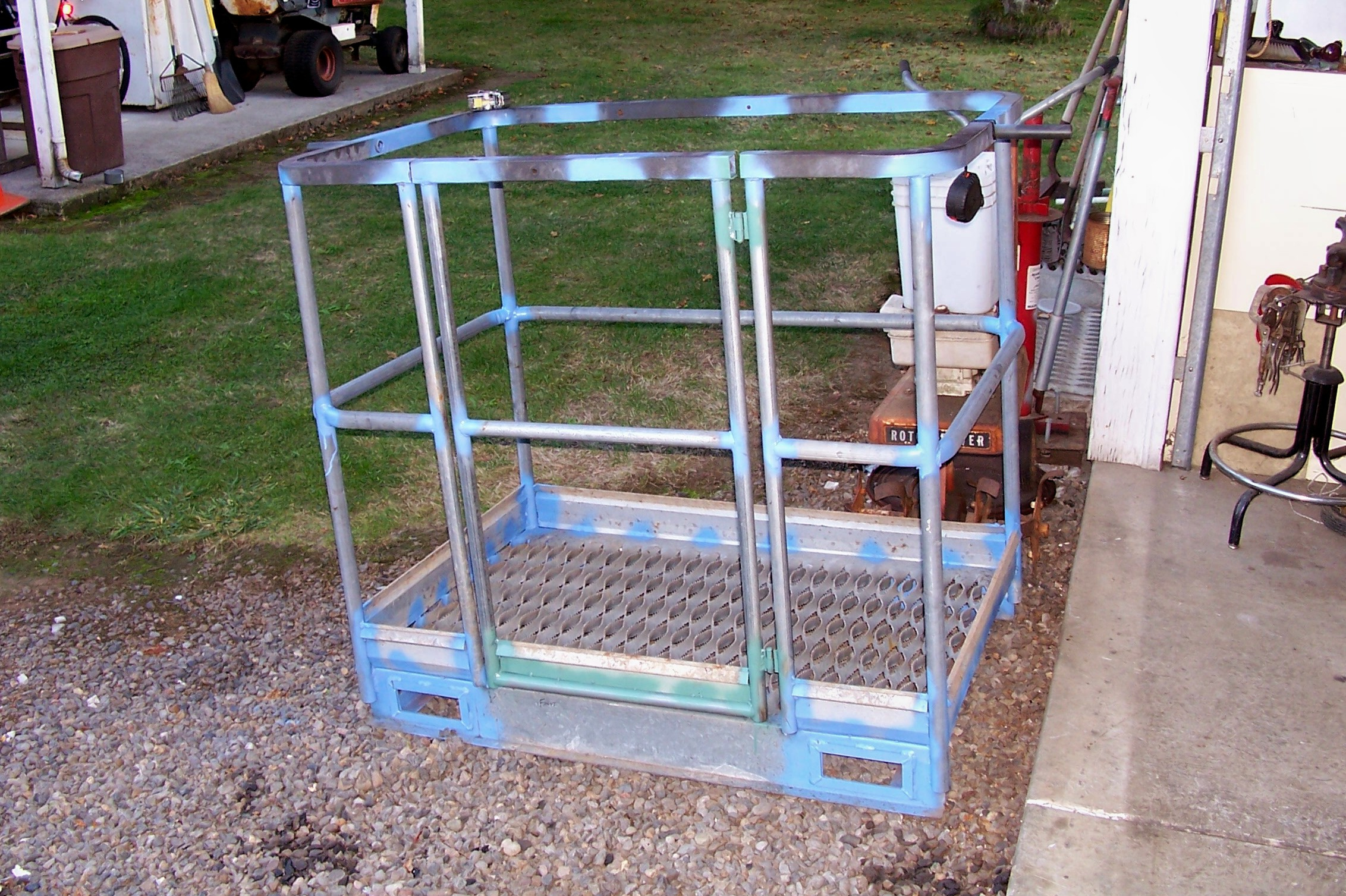

I'm sure that I've posted this on another thread, but I made a man basket for the forklift with some scrap material I had around. About a 4 foot chunk of catwalk, some 1.375" toprail and part of one of those home gym things that someone had set out to the street for free.

I'm sure that I've posted this on another thread, but I made a man basket for the forklift with some scrap material I had around. About a 4 foot chunk of catwalk, some 1.375" toprail and part of one of those home gym things that someone had set out to the street for free. View attachment 699189
I LIKE that
