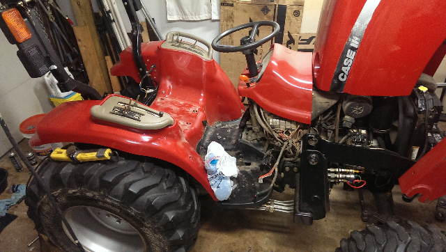

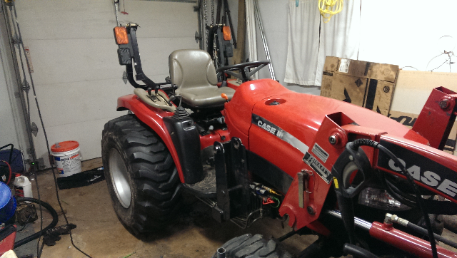

Lots of progress, but lots of frustration also. I went from this.....
To this......
Not bad for an afternoon.
Now for the frustrating part. I went to turn the ignition on so I could turn the turn signals on to make sure that I had the harness routed correctly. I turned on the key.....nothing. I turned on the hazard lights and they work fine. So off I go testing fuses etc.
I figured that the ignition switch was safe since I had made a relay for the starter. Wrong!!!!!! Bad ignition switch. Another thing to add to the parts list. Just as soon as I get one thing on a roll......I find another. Grumble grumble..

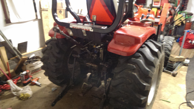

Got home later than I wanted to from work, but was still able to get home in time to get everything back together. Started. Moved. Spun the PTO without issue with no load. Need to adjust the levers, top off the oil, torque the right rear wheel.....and she should be done.
Have a long day at work over the next two days.....but I'm thinking Saturday it'll get tested with a mower behind it.
