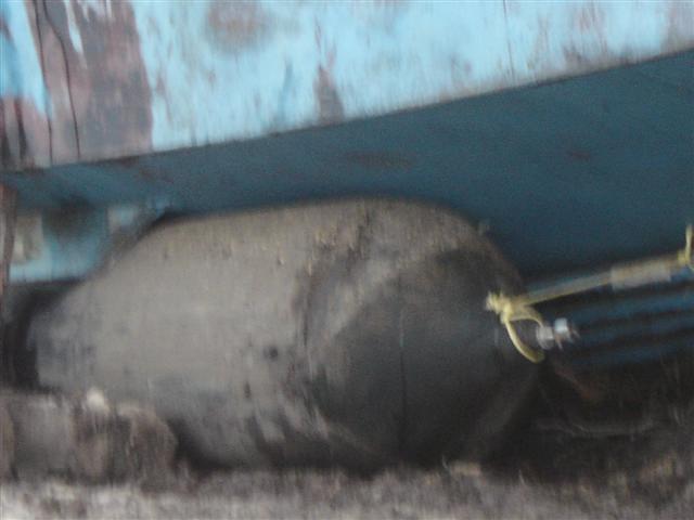

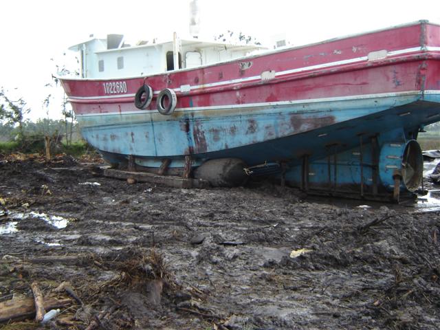

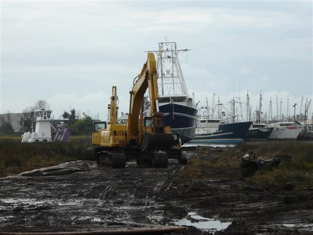

Well it has been a year now and there are still boats to be gotten off shore. I have worked the past couple of weekends to help get a couple of them out of the marsh. We were contracted to weld skids on the bottom of the boats so they could roll them on airbags back to the water. The airbags they were using were pretty neat. One airbag could easily lift the boat. Once lifted and braced we would weld on the skids. then using a Cat D-6 and a JD 330 Trackhoe they would spin them arround and push them down the road we made with mats.
The first picture is the road of mats and the two trackhoes and a skidsteer. I got to operate the JD 330 Tackhoe all day saturday. It was nice. You can see the first one we got to the waters edge.
The second photo is the airbag under the bottom to help stabilize the boat while we worked on it.
The third one is a wider shot of the boat and the airbag.

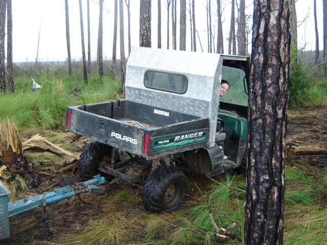

The fourth one was from today when I went to get our welding machine. I took a Polaris Ranger and a trailer out there and loaded it up. My wife rode with me so she could see.
After they get the second one down ther they will get an A-frame crane to lift them in to the water.

This way was chosen because it would have the least effect on the marsh grass. In some cases a chanel was dug to the boat so it could be slid a short distance in to the water. You are correct about it being a major exspense in getting them back to the water. Alot were insurance jobs some were government.
Friday the 8th one of the operators bent a cylnder on the smaller trackhoe by hitting the blue boat in the first picture. I think it is a JD 2XX something that they had leased. I talked to the foreman of the guy and he said the appraiser came out to look at it and gave them a quote of 15,000. I was amazed.

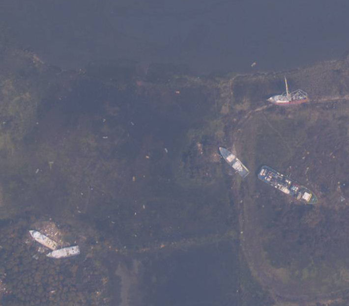

Here is an Photo from NOAA. This was taken right after the storm. The two in the lower left hand corner are the two we have been working on.
You can see the distance they were from the water.
