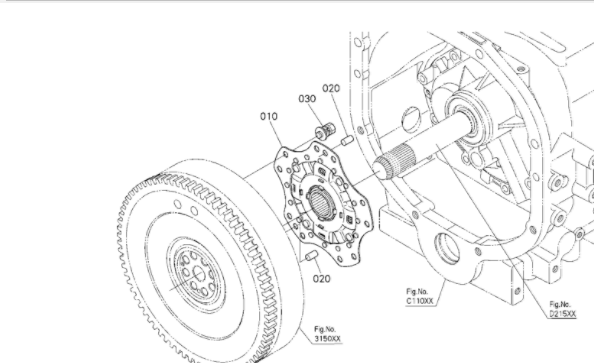

No dry clutch on Kubota Hydraulic shuttle. "multiple wet disk"
Your statement isn't 100% accurate. The hyd shuttle tractors have a dry damper clutch(see photo). Clutch pedal(inching) controls a hyd valve but doesn't have any direct connection to damper clutch which stays engaged all the time
Neat, didn't know that. I am guessing it's cause the "springs" in it like a regular clutch. Sounds like no way to wear it out if you can't engage/disengage it though.
/ Shuttle shift usage Kubota M7060 #37
I didn't either. I'm still trying to understand why the manufacturer would install a dry clutch that is never disengaged?? I'm not sure what the purpose would be. I guess I need to study the parts diagrams better. I totally missed that clutch when I searched the M7060 parts diagrams. :(

I know zero about shuttles but do know there are two styles, the dry and wet shuttle. That's not the dry clutch shuttle shift rather than the wet clutch shuttle shift, is it?

I am guessing the dry plate is solely to give a cushion for shock loads when shifting the shuttle. The friction material would not be "used" but the shock collar/springs around the center drive splines would still function. Cheap way to do it with existing parts and NOT use a dry clutch engagement.
The way I look at it, it's like a car with a cassette deck, it might be there but it isn't used, and it doesn't affect the operation of the transmission.

Yes, I have both types. Ford uses dry clutch and "mechanical" shuttle. Foot pedal required. Kubota doesn't use dry clutch and is "hydraulic" shuttle. No foot pedal required.
Edit: Actually I have three types. Ford 555A uses "hydraulic" shuttle with torque converter. It can be held in place with the brakes just like an auto trans car/truck.
