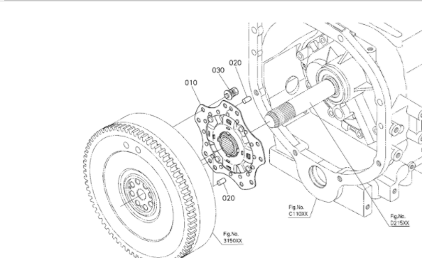

No dry clutch on Kubota Hydraulic shuttle. "multiple wet disk"
Your statement isn't 100% accurate. The hyd shuttle tractors have a dry damper clutch(see photo). Clutch pedal(inching) controls a hyd valve but doesn't have any direct connection to damper clutch which stays engaged all the time
Neat, didn't know that. I am guessing it's cause the "springs" in it like a regular clutch. Sounds like no way to wear it out if you can't engage/disengage it though.
I didn't either. I'm still trying to understand why the manufacturer would install a dry clutch that is never disengaged?? I'm not sure what the purpose would be. I guess I need to study the parts diagrams better. I totally missed that clutch when I searched the M7060 parts diagrams. :(

I am guessing the dry plate is solely to give a cushion for shock loads when shifting the shuttle. The friction material would not be "used" but the shock collar/springs around the center drive splines would still function. Cheap way to do it with existing parts and NOT use a dry clutch engagement.
