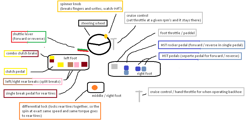

various options folks get themselves into... so many controls and way to do things...
to many controls.... left foot / right foot *shrugs* which is which?
forgot to add pictures for... to select a wider range of speed.
--gear shifter, 1-4 forward, 1-3 reverse, center neutral
--single lever for low/high
--low/medium/high
--1-4 gear selector.
-----any combination of above with a button to dump clutch
--electronic clutch, or gear box / transmission, that handles clutch automatically.
--engage / un-engage - 4wd / Mfwd or like.
--engage / un-engage - creeper gears. (very slow crawl)
--FEL 2 levers, 1 joystick
--FEL with 3 funtions for say a grapel. 3 levers, or joystick with 3rd function.
------either above with possibly extra button to dump clutch, more seen on wheel loaders.
