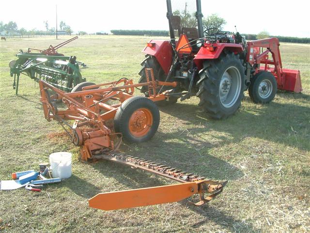

Here's a photo of my Allis Chalmers 80T 7-ft sicklebar mower that has an hydraulic lift and is PTO-driven. "T" means it's a trailed or towed mower that's attached to the drawbar, not to the 3-point hitch. Paid $125 for it, towed it home, and fixed it up (new belt, new blades). I have triple rear hydraulic remotes on my Mahindra 5525 and just connect the mower to one feed/return pair. If you have a small cut (25 hp or so), a trailed mower might be a better choice than one that hangs on the 3-point hitch.
Good luck.
Flusher, Consider yourself fortunate to find a caddy sickle like this for such a low price.
For those that don't know sickles, there are models that are pulley driven and can be articulated up or down at some really steep angles. If you're going to trim your pond, and there is a bit of slope, you will need one of this type. Not the old pitman stick type, unless there are some stick types that articulate.
