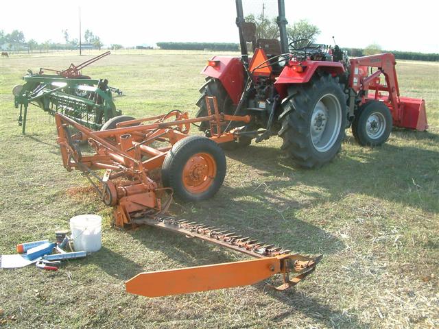

Here's a photo of my Allis Chalmers 80T 7-ft sicklebar mower that has an hydraulic lift and is PTO-driven. "T" means it's a trailed or towed mower that's attached to the drawbar, not to the 3-point hitch. Paid $125 for it, towed it home, and fixed it up (new belt, new blades). I have triple rear hydraulic remotes on my Mahindra 5525 and just connect the mower to one feed/return pair. If you have a small cut (25 hp or so), a trailed mower might be a better choice than one that hangs on the 3-point hitch.

Good luck.

Never buy a trailered unit. They are a PITA to maneuver. You wil have downed a lots of grass with your tractor before you get that stubborn beast in a corner. Handling a donkey might be way easier.
As for your hydraulic question, are you planning to leave the loader on tractor while mowing? I would take it off for visibility reasons and you have your needed hydraulics right there. You only need to run one hose to the mower. It's hydraulic lift and gravity down.
Good luck.
Flusher, Consider yourself fortunate to find a caddy sickle like this for such a low price.
For those that don't know sickles, there are models that are pulley driven and can be articulated up or down at some really steep angles. If you're going to trim your pond, and there is a bit of slope, you will need one of this type. Not the old pitman stick type, unless there are some stick types that articulate.
My deere 350 is a beast to mount onto the 3 point. It uses a chain linkage that is connected to the tractor frame below the PTO that when you lift up the 3pt, it is supposed to raise the mower arm all the way up. This is in lieu of having a hydraulic ram to raise it. It would be nice to have a dedicated welded up frame to place on for storage, which should make it easier to remount on the 3pt, because it would be already lined up for the most part.
