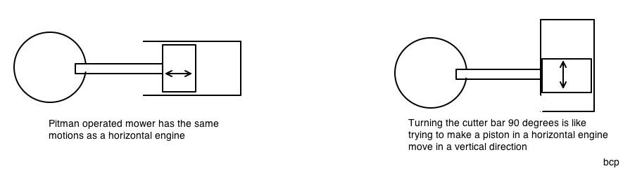

With a pitman stick type drive the side to side motion of the sickle is optimum with the mower bar perfectly horizontal with the mower frame. The mower bar can angle up or down to some extent but the more it does the higher the stress on the pitman stick and drive unit. There is really no hard limit as it depends on what you are trying to cut. As a practical limit I would say +/- 25 degrees from horizontal. You usually can hear the drive binding.

I see no way for you to get a pitman drive mower to swing up or down 60 degrees. I would just look for a belt drive. Think about how a pitman works and you will see that it would be in bind to say the least. Even if you got it to work it would be doing what it is not designed to do and the stress would shorten the life of parts.

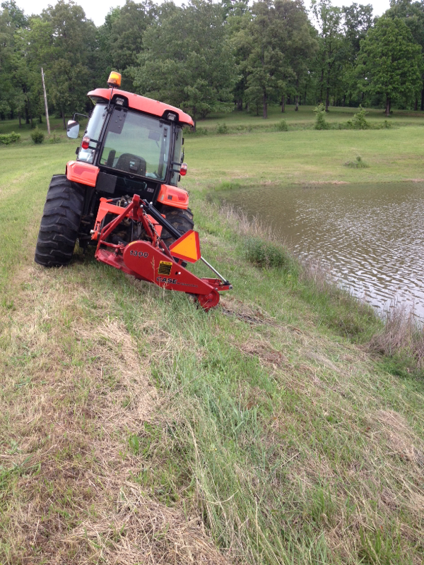

As most have stated a pitman style mower is very limited to angle , I bought a IH 1300 balance head and added a hydraulic cylinder to mow banks, ponds, and such. It will mow from straight vertical, to way below horizontal, not sure how far cause I've not had to max it out. Plenty of ideas and reading if you search around on here about ditch bank mowing and such. Good luck with your project.

They make a nice sickle I just am to tight to spend that much on one. :) I've yet to max mine out on down travel , it's had no trouble reaching down were I've needed so far. Here is a quick snap shot of one of the banks I have to do , even with the tractor setting on top level it's no where near maxed down angle.

The cylinder sets the angle of the sickle bar, i.e. that is what brings it vertical?
/ sickle bar mower question #11
On mine? Yes the cylinder controls the entire movement of the bar from transport to below grade, not sure just how far below level it will go never have found a place that maxed it out.
