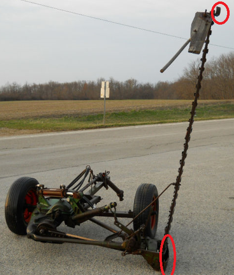

Some thing like this 251 New Idea Pull Type, Farm Tractor Sickle Bar Mower | eBay
if ya look at the link powertroke444e noted from ebay. and enlarge the pictures.
you can make out 2 guide rails. that hold the sickle bar up off the ground. and allows the bar to follow the ground.
one right at the base of the bar. then a smaller one at the very end of the bar. ya let the bar down. and the rails hold the bar up off the ground. the ones i have seen. you can adjust these guide rails up and down to get different cut heights for example 1" to 4" cut heights. (well maybe not that big of difference but hopefully get idea across)

Good pic. Those are your inside and outside skid shoes and like you said can be adjusted 1-2 to 4-5 inches easily and if you need more height, you can use a clipping wheel on the end. I will post a pic when I get caught up. Ken Sweet
